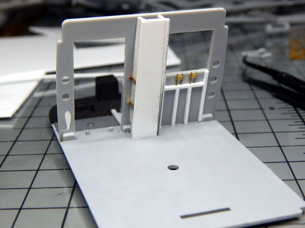

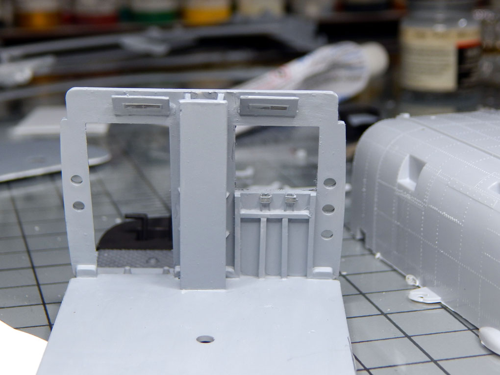

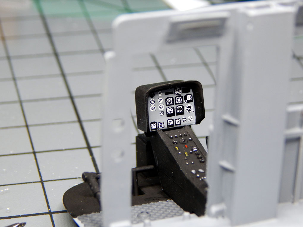

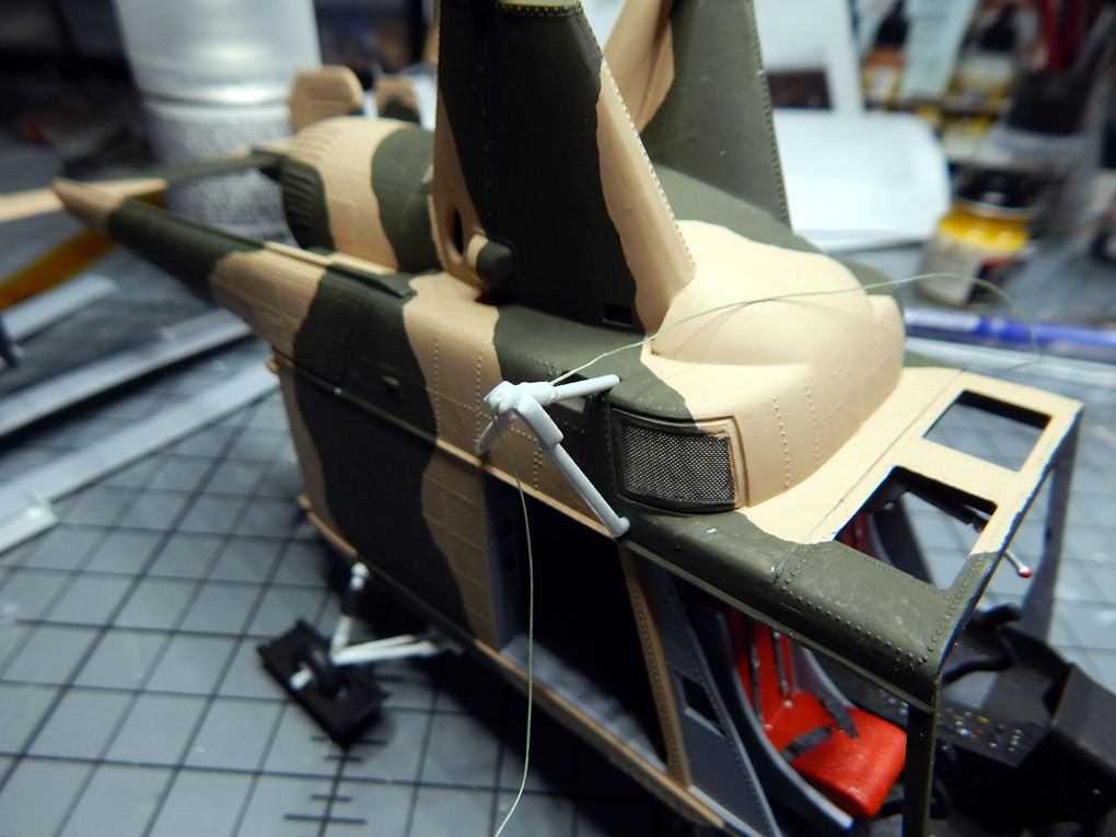

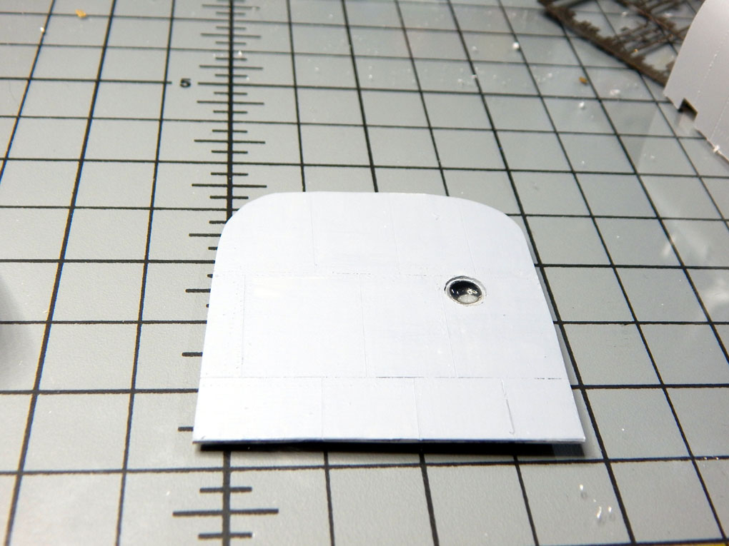

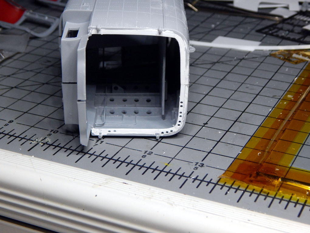

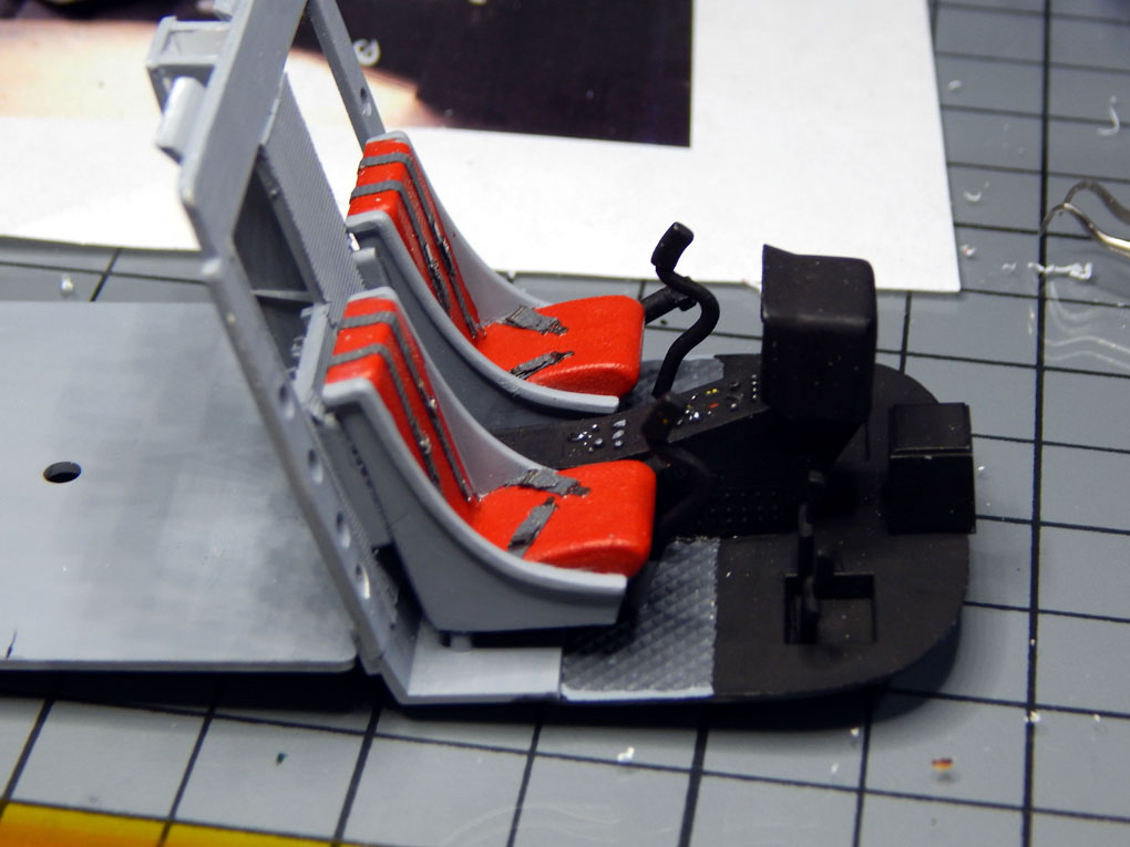

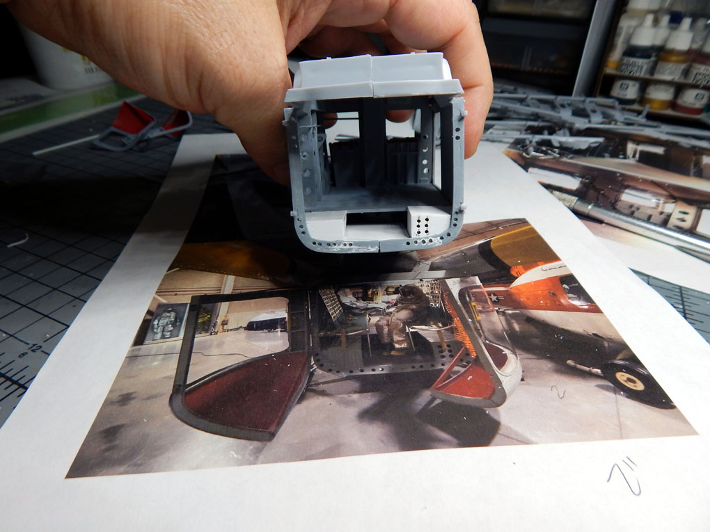

I started off working on the interior. The kit does not provide any details. I obtained a lot of reference photos online. The bulkhead between cockpit and crew area was the first part I started detailing. It required mold marks to be filled with putty first. Then using styrene sheets and some photo etch pieces from my spares drawer I added the center post and details to the crew side. I used cloth tape to replicate the padding on the cockpit side. The instrument panel and center console was assembled and detail painted. I used the kit decal for the instrument panel as it matched very well to the reference photos. Next I then test fit the interior to the fuselage and marked where everything lined up so I can detail the insides. The kit also does not include the roof for the crew cabin and the overhead console for the cockpit. I used some sheet styrene shaped for the roof then scribed the panel lines and rivet lines to add detail. The crew area also has an overhead light which I replicated by drilling a hole and installing a clear lens.

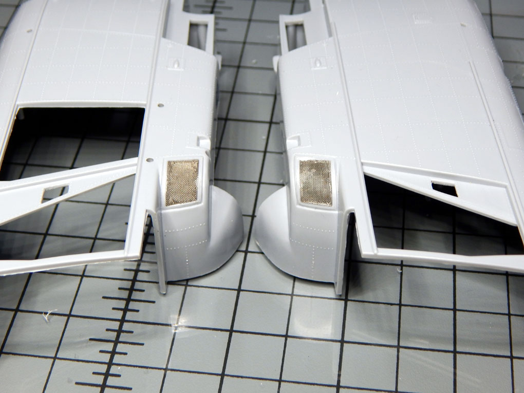

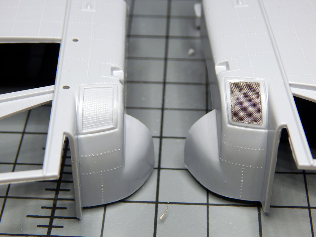

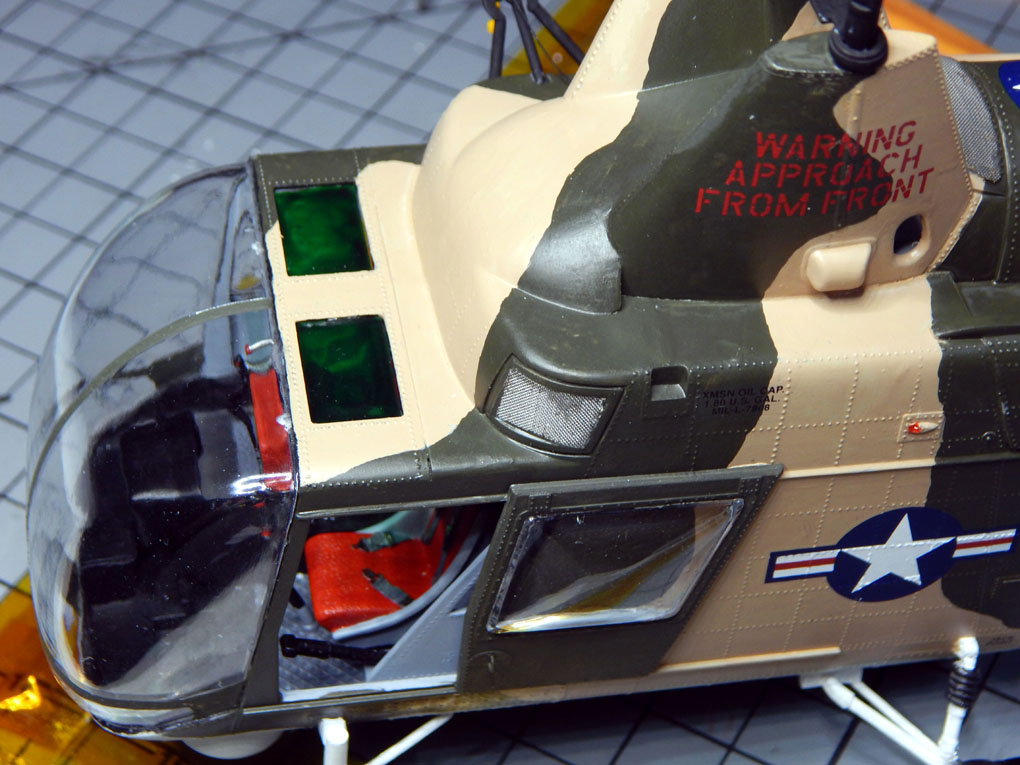

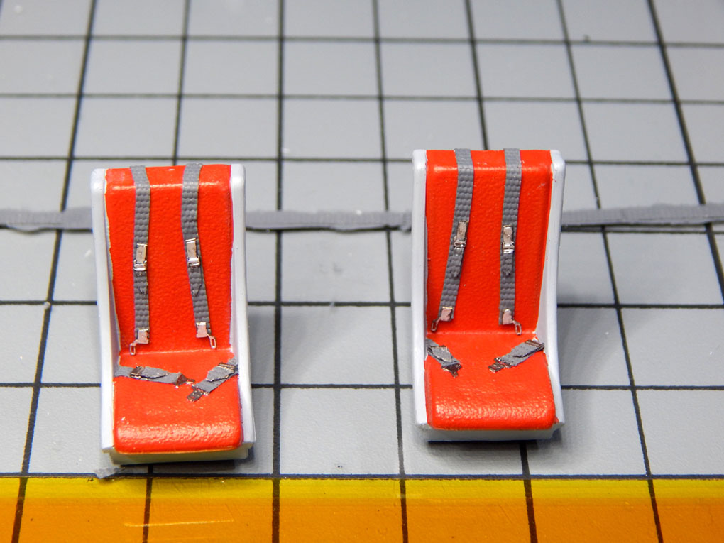

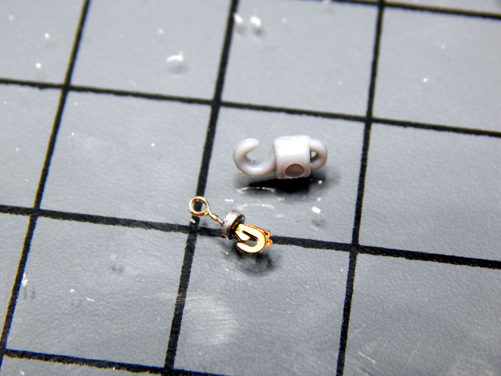

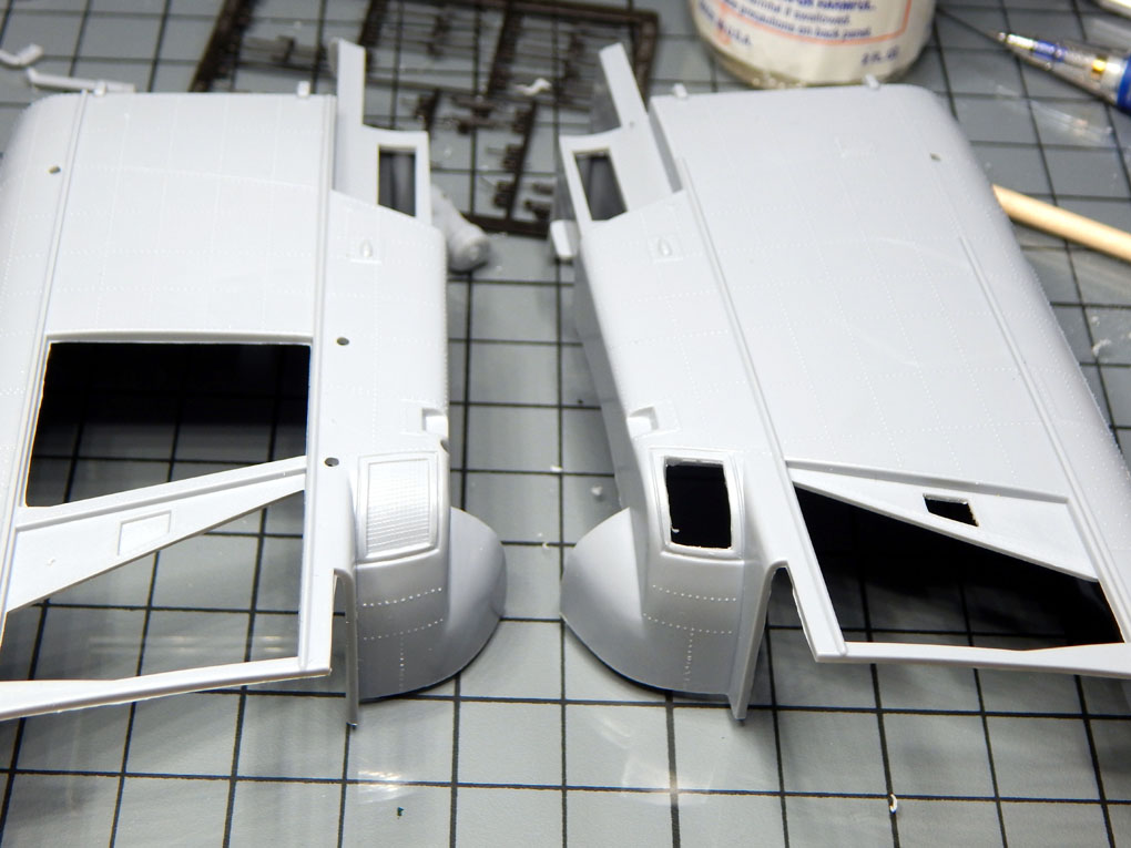

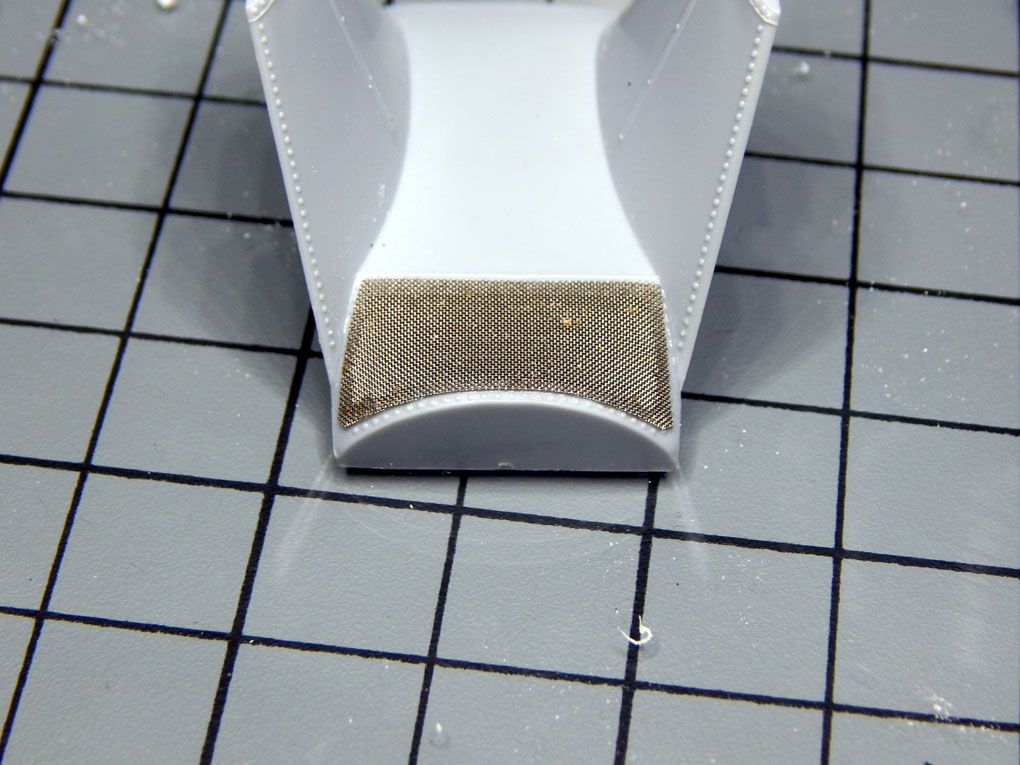

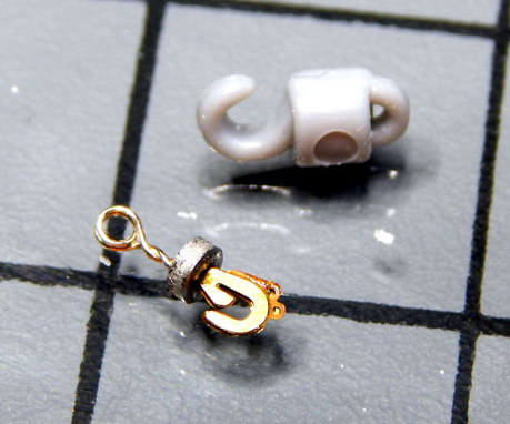

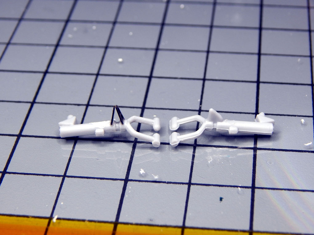

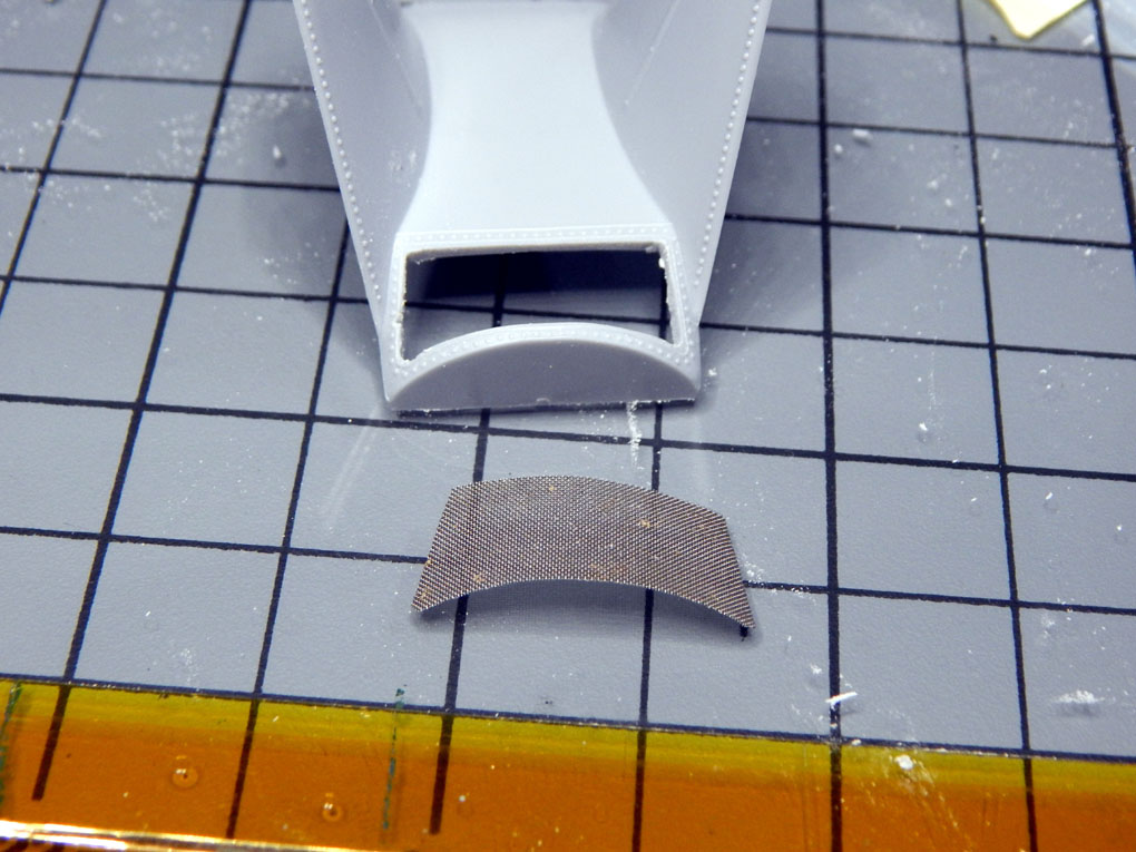

While measuring for the roof I realized the fuselage has two screened intakes molded in for the engine intakes. I cut these out and replaced them with some fine metal screening. There is also a section in the forward post that in the reference photos is open and the kit had these molded closed so I opened these up. Finally I worked on the cockpit seats. The rear of the seats was open so I used sheet styrene to make the backs. After painting them I then made the seatbelts from cloth tape and attached some photo etch buckles. Next I will be working on the overhead console for the cockpit and detailing the interior of the fuselage halves.
... the screening makes such a huge difference!
To me, when a detail provides a proper affordance (it gives appropriate hints of its function), it seems so much more real!
A grill that air can actually flow through, a door handle that looks like it can be grasped and turned ( as opposed to molded on), a cleat that could have thread (scale rope) wrapped around it, a fire hose that has been folded and stacked.
I like seeing how you approach these details, because at scale, it often requires some ingenuity to replicate objects, given the physical properties and limitations of the materials we modelers have to work with.

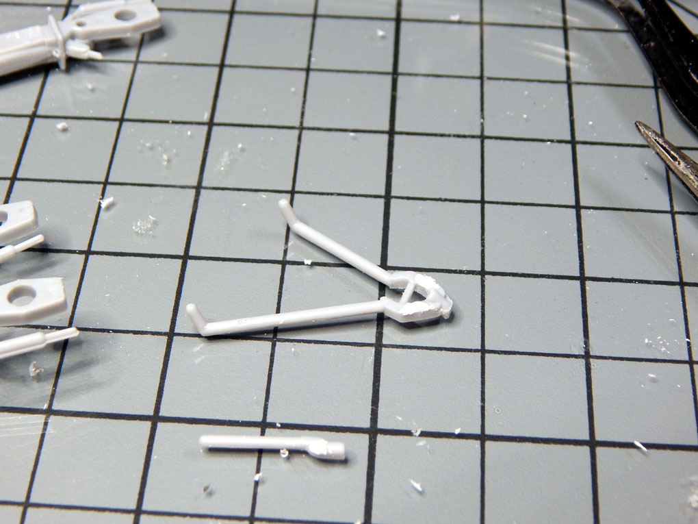

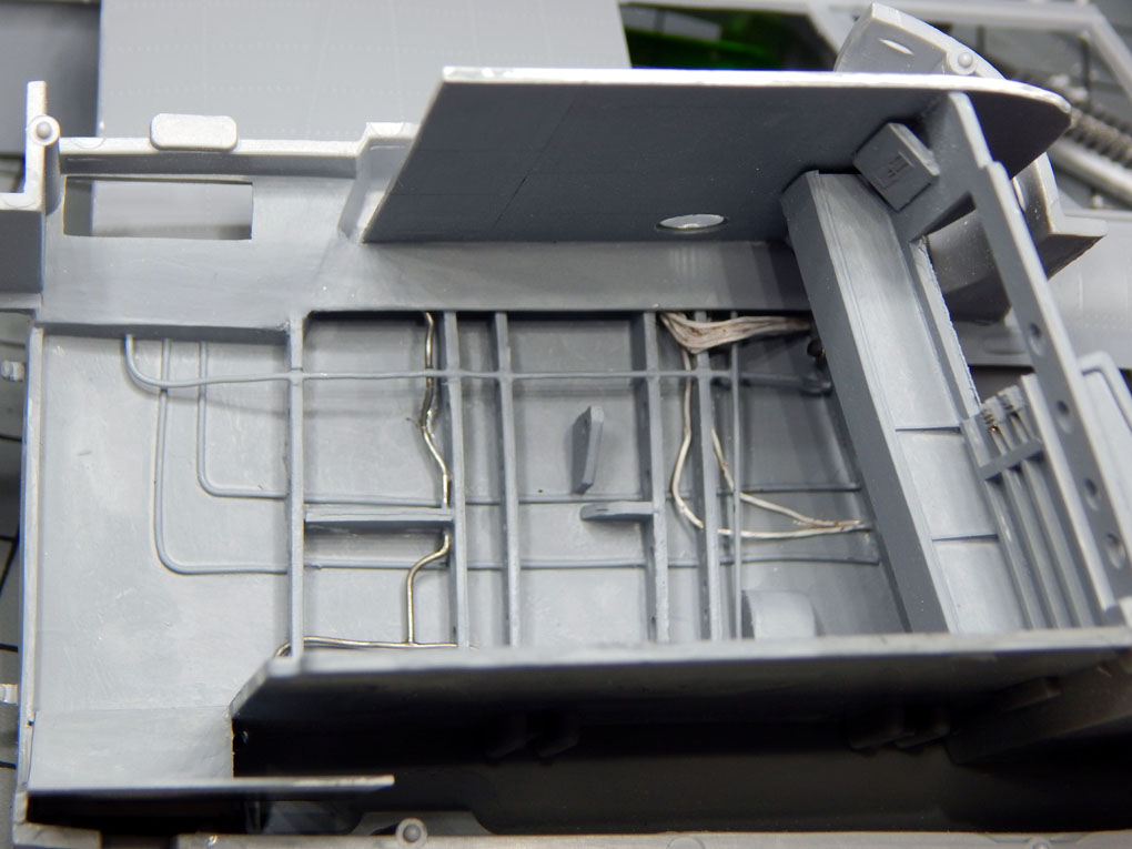

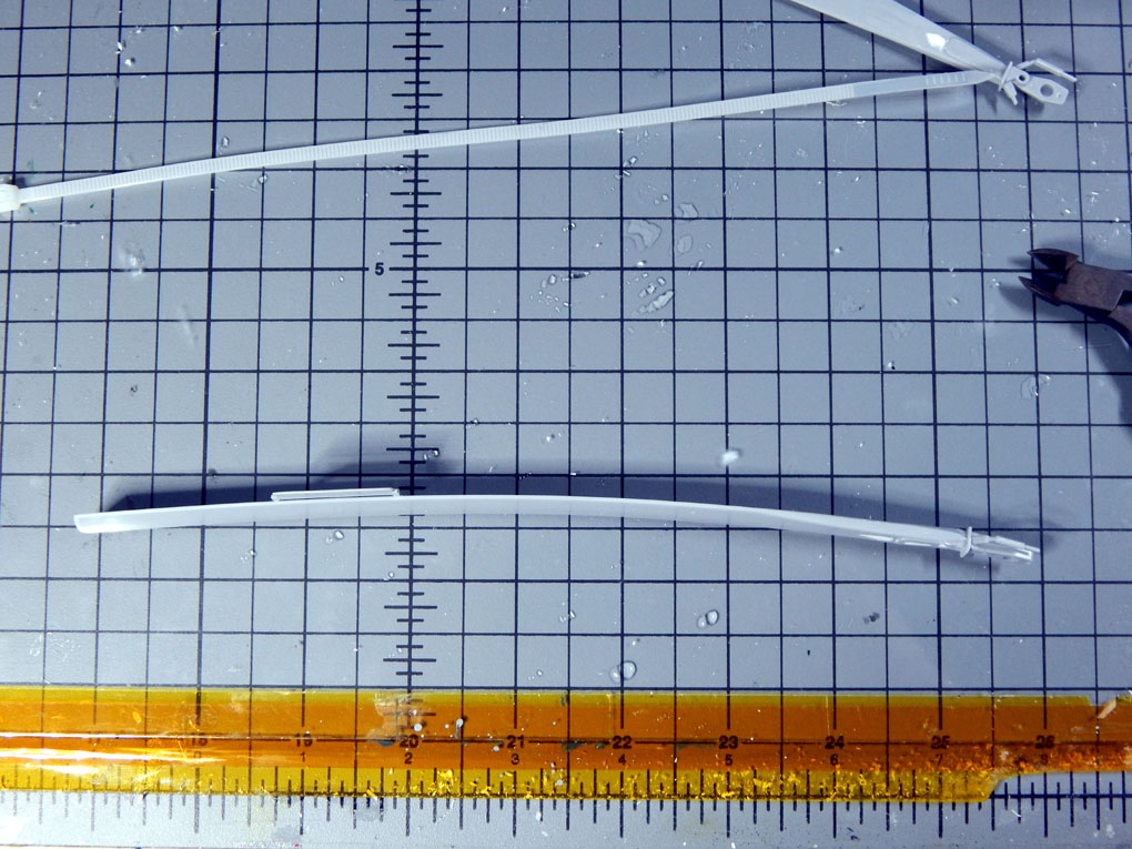

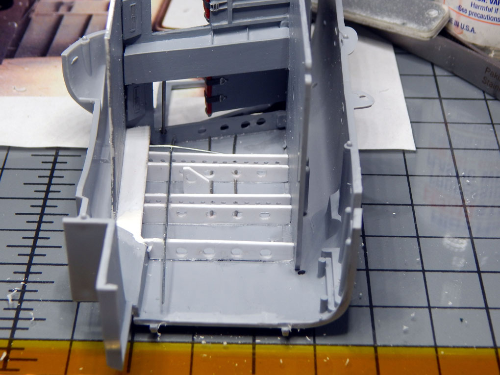

The second week of the H-43B Huskie was spent starting the super detailing of the interior. After finishing the cockpit area and installing the screens on the fuselage I installed the kit interior. I then started detailing the crew area by using sheet styrene for the supports on the port side. I then used two paperclips to replicate the pipes that run along the side. I installed the top panel and used some putty to blend it to the kit section.

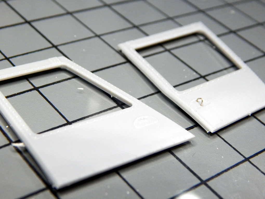

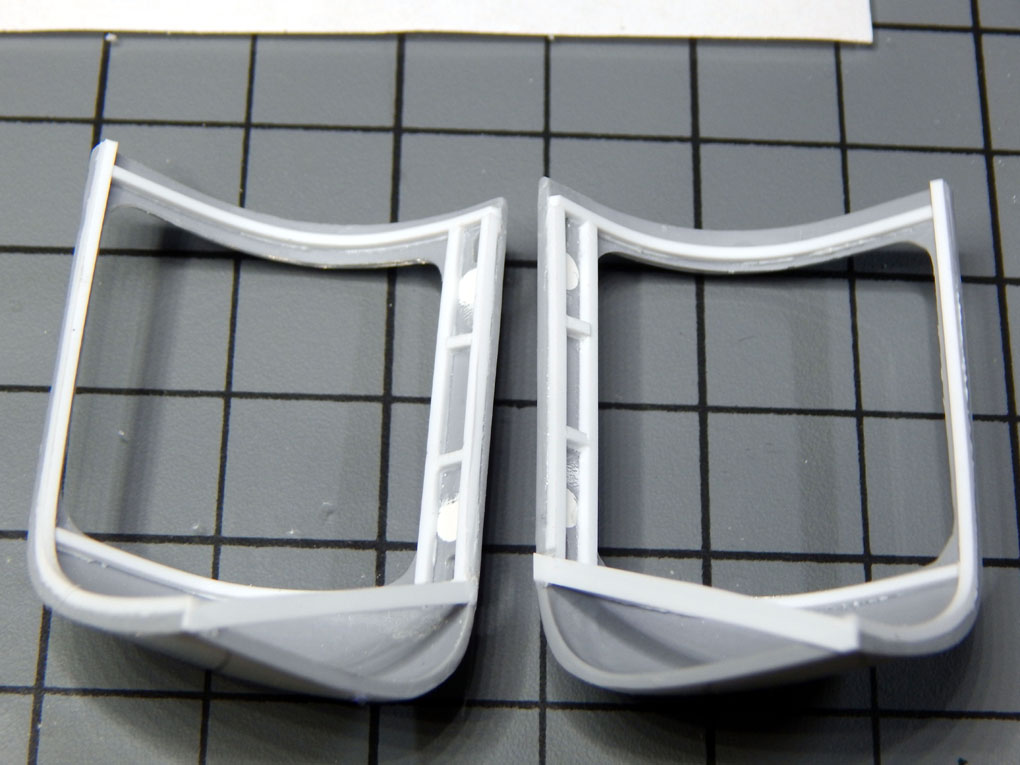

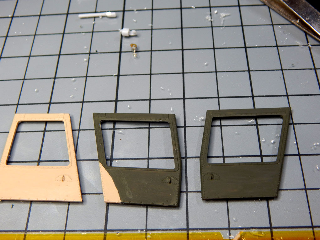

While waiting for the putty to cure I used some styrene square rods to detail the framework on the rear doors and a strip of sheet styrene for the lower braces.
I am working on the details between the supports and then need to detail the rear section benches and floor. Once these are done I can paint the port side and start adding the wiring that goes on the port side. I am hoping to start on the starboard side by the end of this coming week.

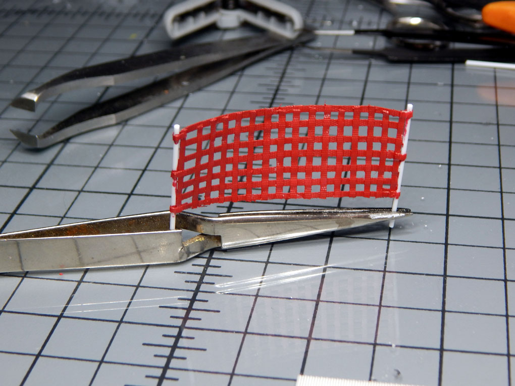

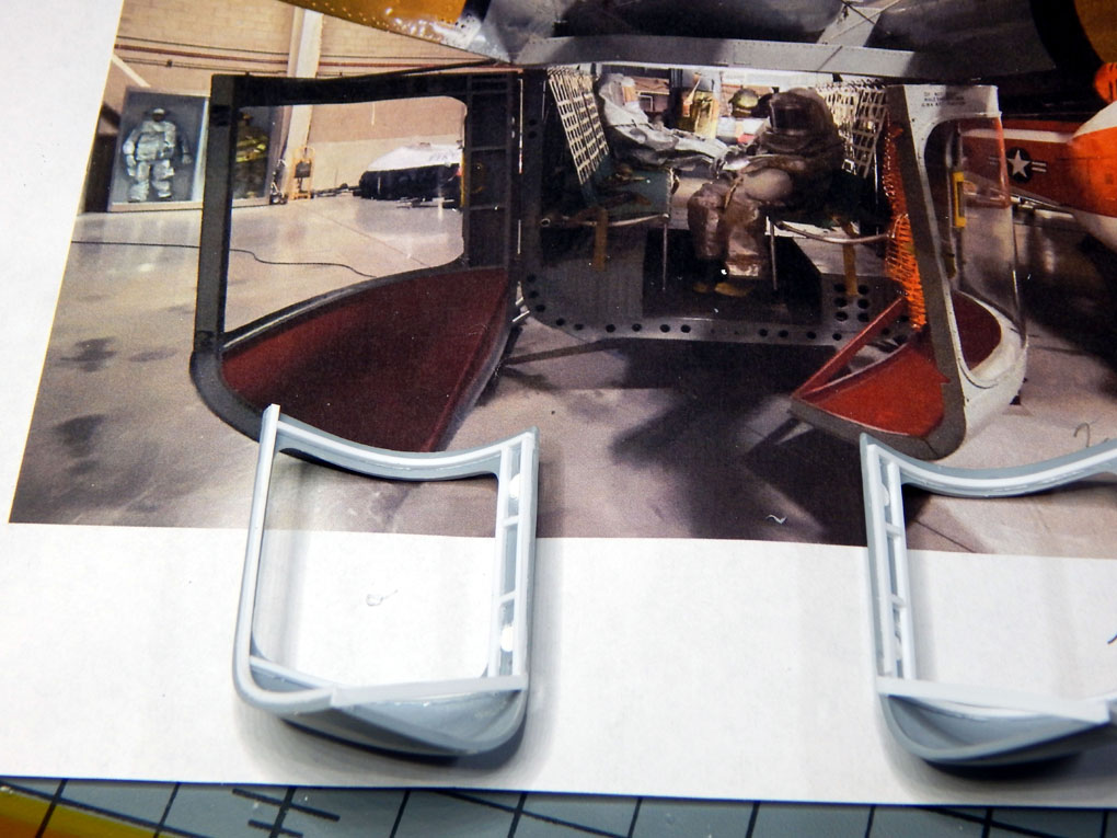

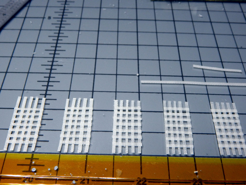

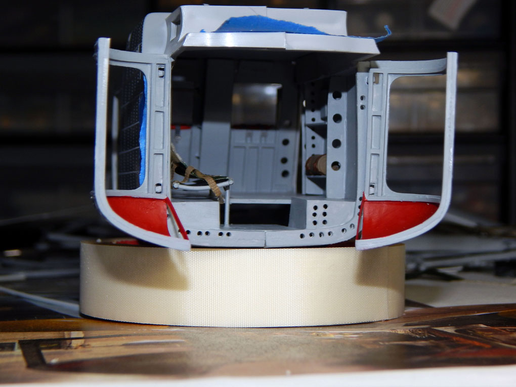

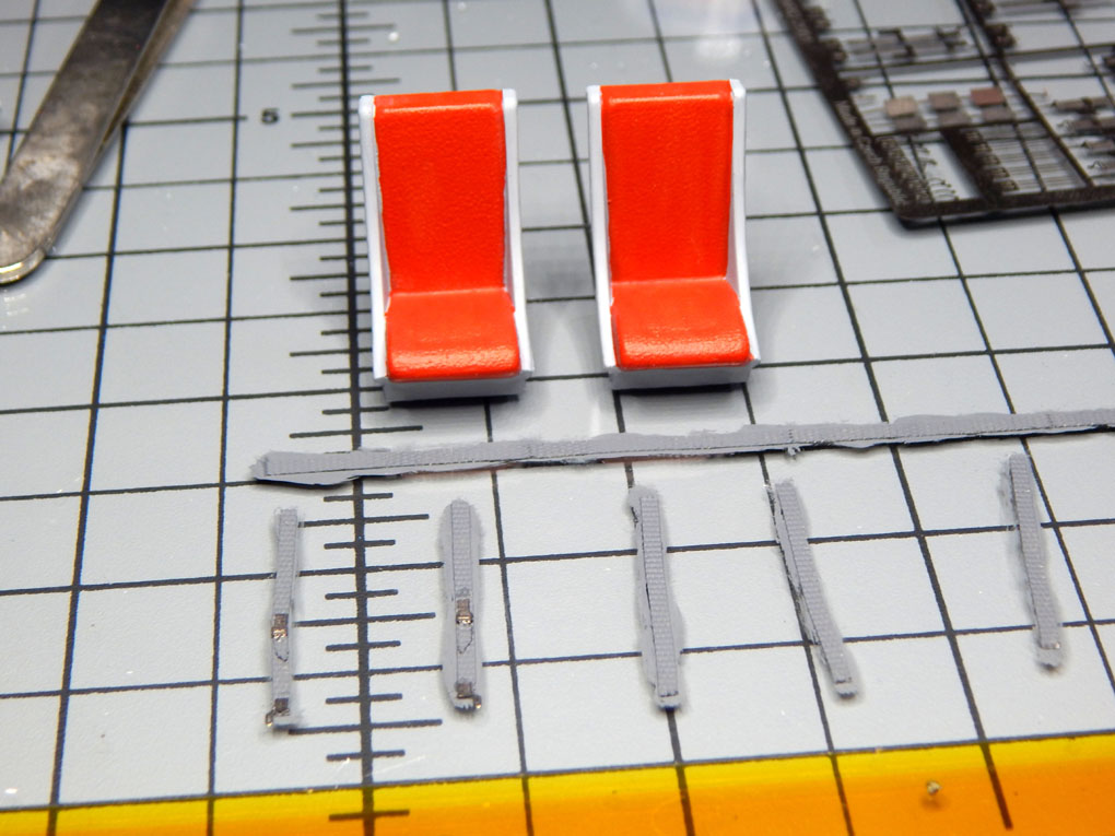

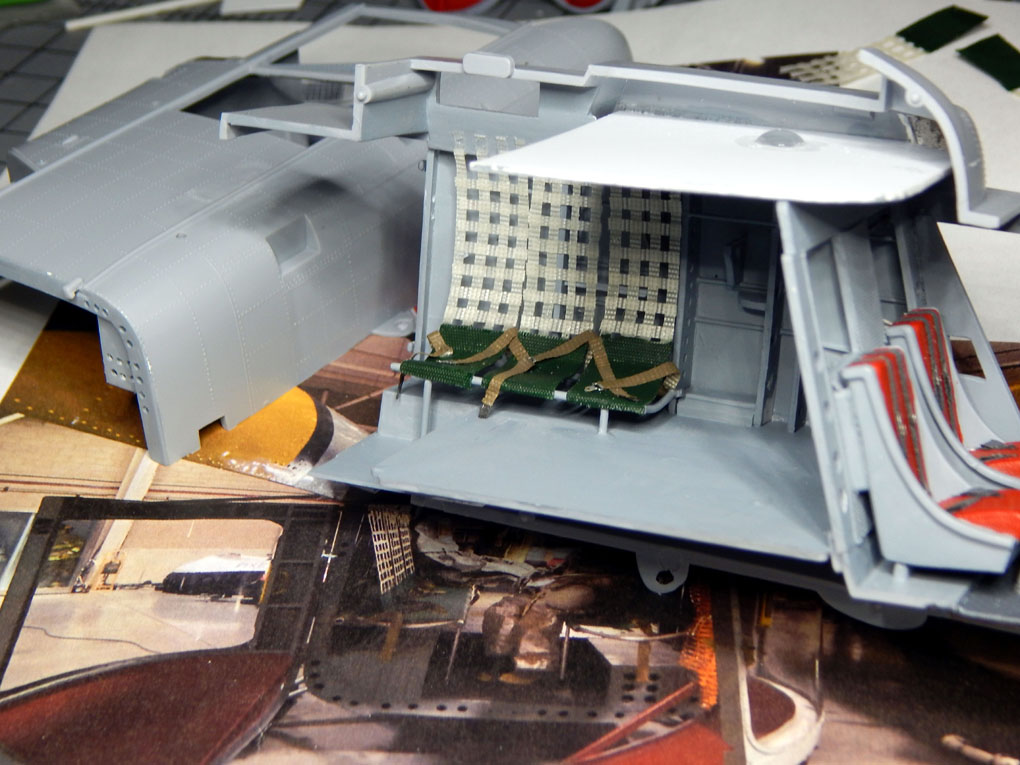

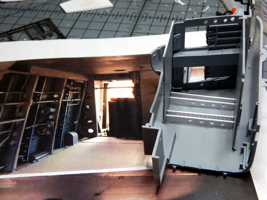

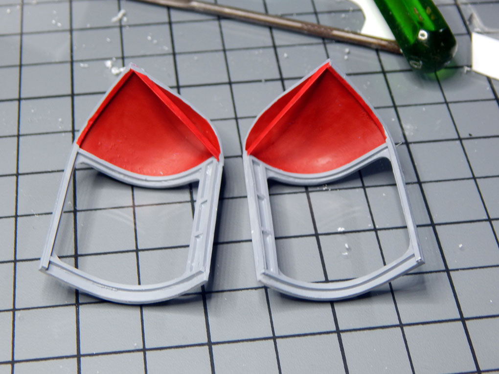

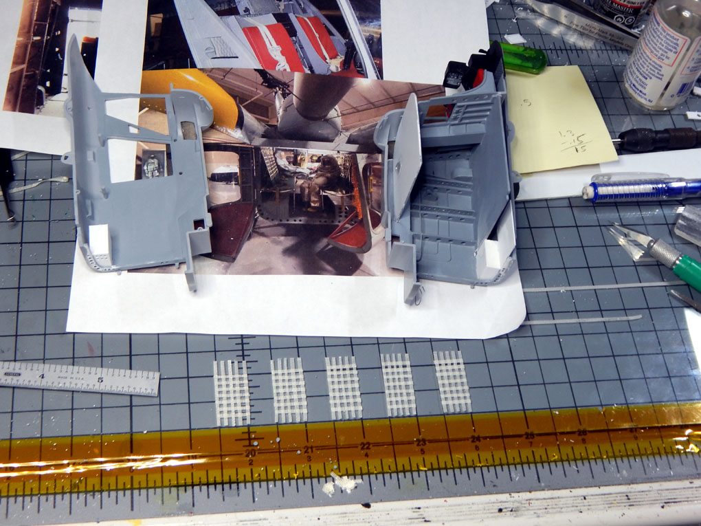

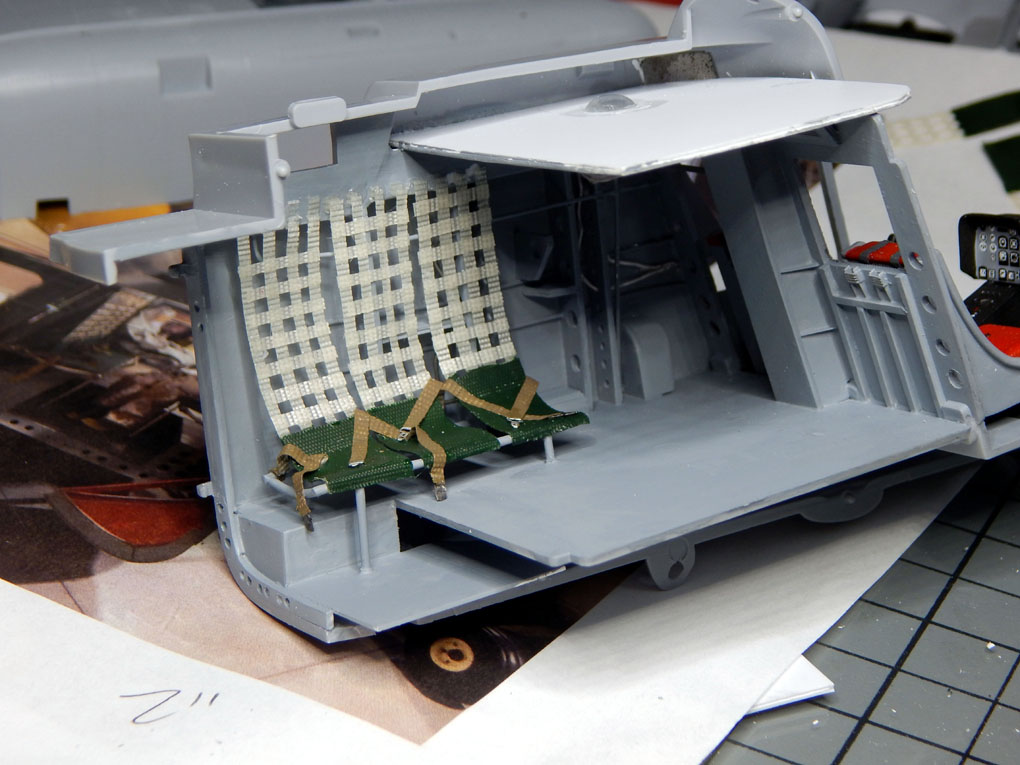

The third week of the Huskie I worked on detailing the aft section of the interior. First I panted the interior of the rear doors. The lower section is red and the upper section is the interior grey. Then using styrene square rods I framed the rear edge and drilled out the holes. The port side of the interior was also painted with the grey. The reference photo shows a cutout in the floor so using some sheet styrene I made the side extensions. There are two rows of seats along the rear sides with a cargo net type of back. I used some cloth tape to make the netting. I am now working on making the seat frames out of round styrene rods and will use cloth tape for the seats.
I still have more details to add to the port side but I needed to order some more sheet styrene for the shelves that need to be added and still make the wire cables. Then I can start on the starboard side details.
You can see all the photos and details from the start in the build log at: https://davidsscalemodels.com/build-log/1-32-kaman-h-43b-huskie-helicopter/

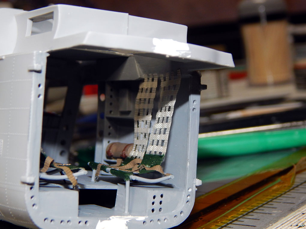

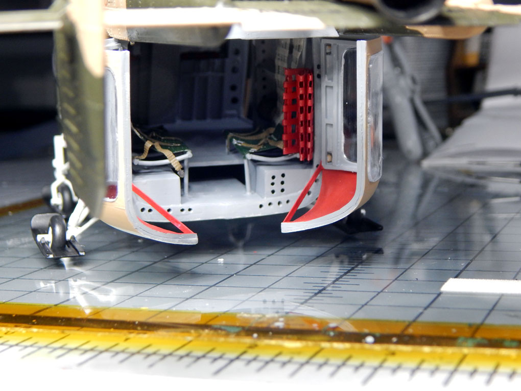

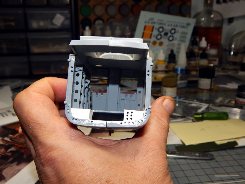

The fourth week of the H-43B Huskie I was able to finish detailing the interior in the crew area and assemble the fuselage halves. The seats were installed onto scratch built frames and then the seat belts were installed.

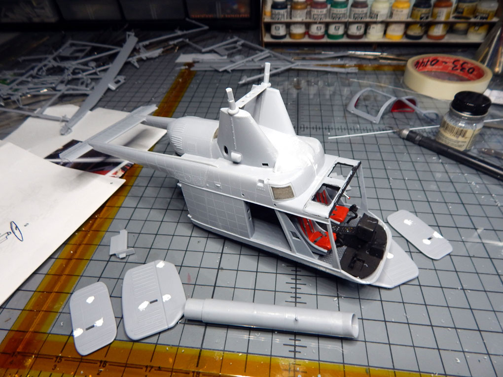

Moving over to the starboard side I added the supports and shelves. Installing these took a little time so that the floor and roof lined up correctly. The fuselage was then glued together. Only a few areas required putty. The starboards seats were then installed. I did a quick check on the rear doors on how they fit and aligned to the fuselage.

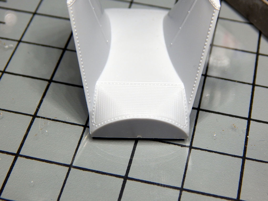

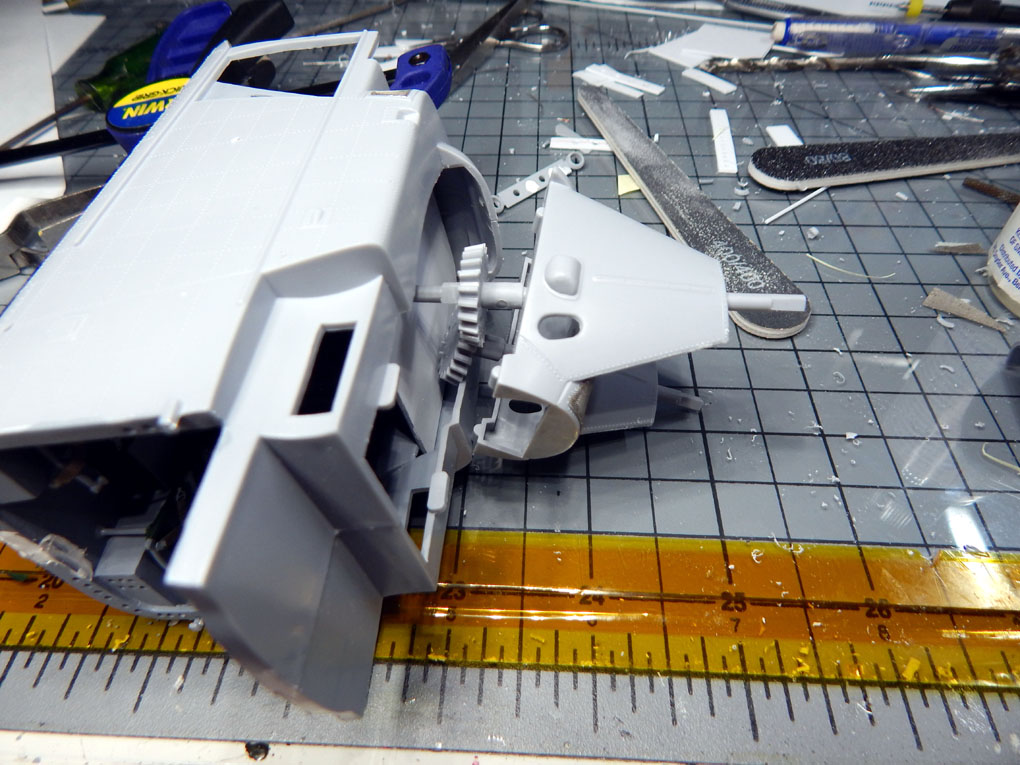

While the putty on the fuselage was drying I started working on the engine/rotor assembly. There is a large screen on the aft side of the assembly. I cut the plastic screening and installed a metal screen. The rotor shafts required a lot of filing and sanding to make them smooth and to install the gears that keep the rotors aligned.
I went to check the fit to see how the rotor assembly aligns to the fuselage and found out I have a huge problem. The gear assembly is huge! Since I added a roof there is no room for the rotor assembly to mount to the fuselage. The kit has the gears sit way down into the crew area! At this point I do not think there is enough room in the rotor assembly to re-design the gears and fit them inside. I will look it over this week but if all else fails the rotors will not spin.

Love those seats!
Cool how 'soft' detailing, as well as being interesting on it's own, adds veracity to the 'hard' elements of the actual airframe, by contrast, and in this case, by adding a very easily relatable 'human' element of webbed seating we might all have experienced, even if it was just a lawn chair in the 60s and 70s!

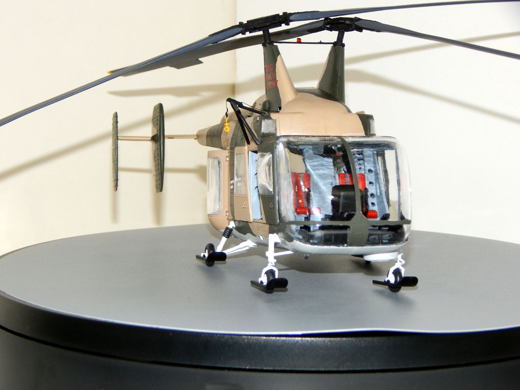

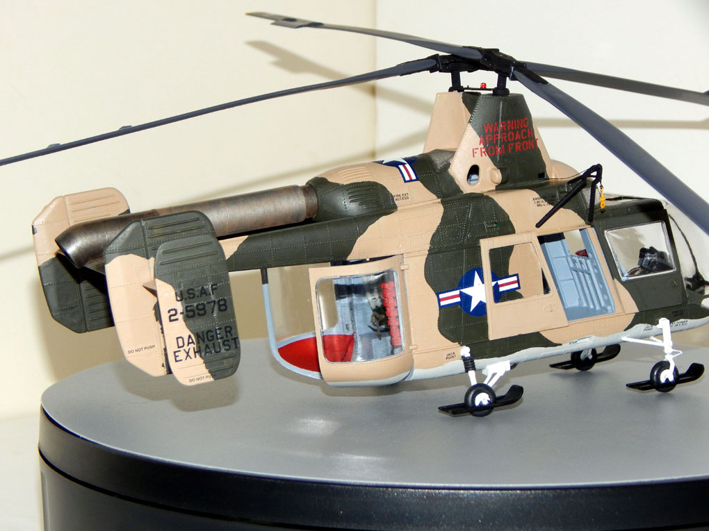

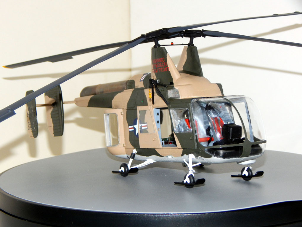

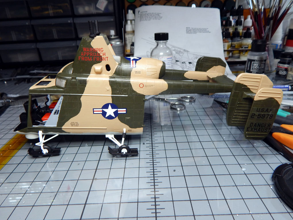

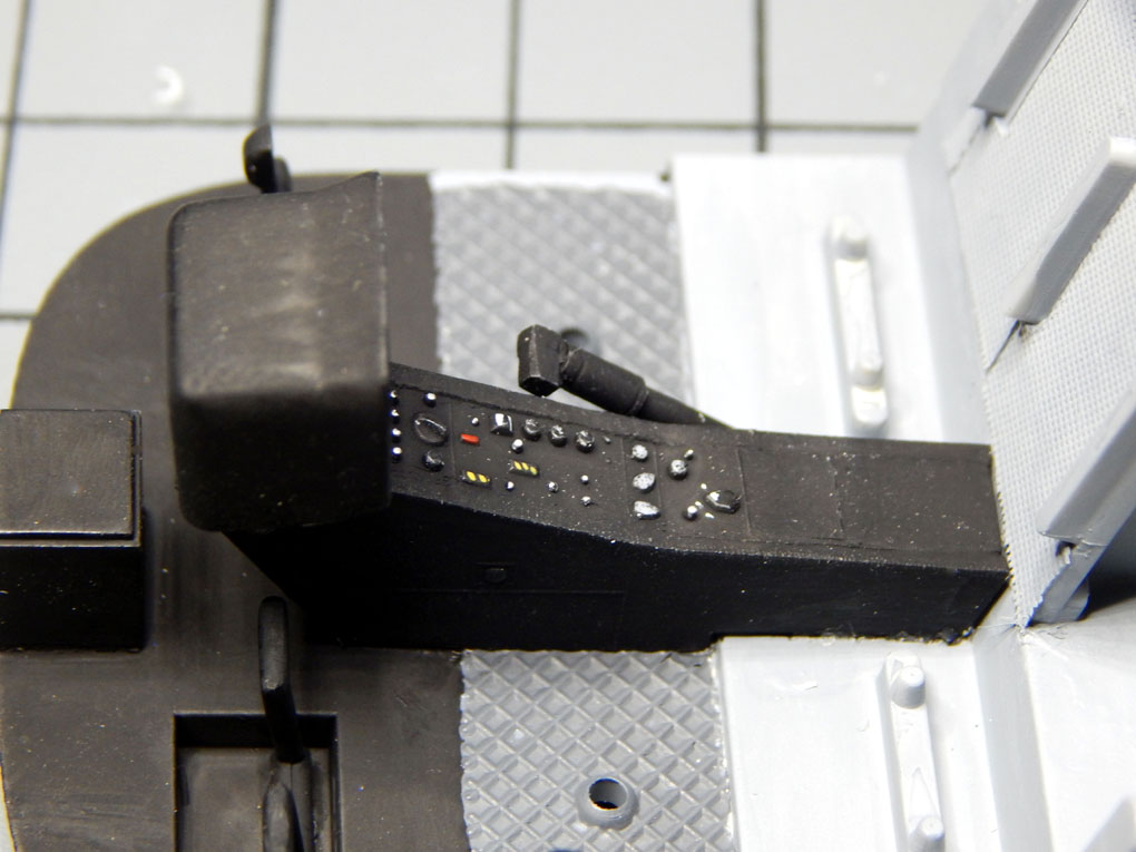

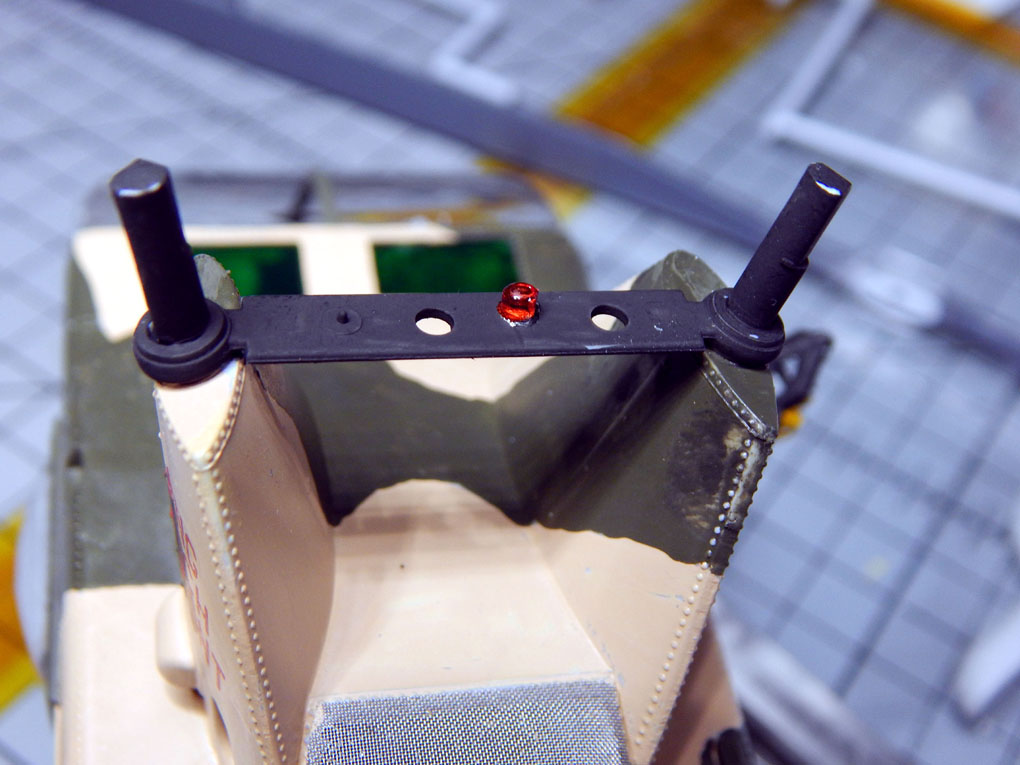

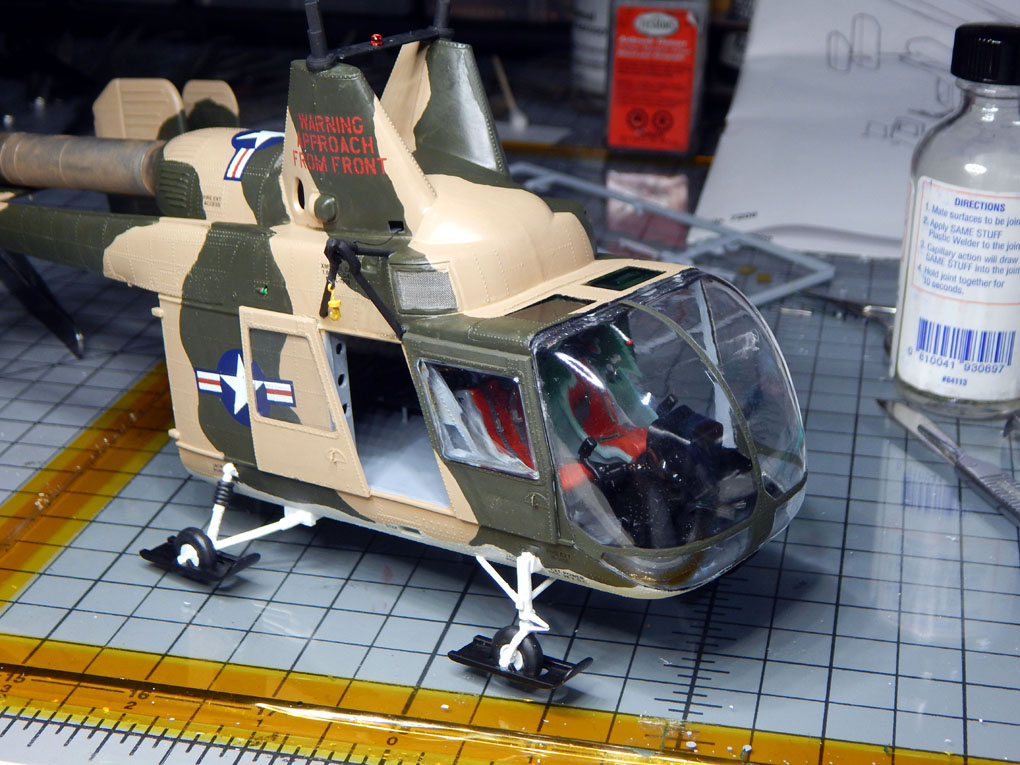

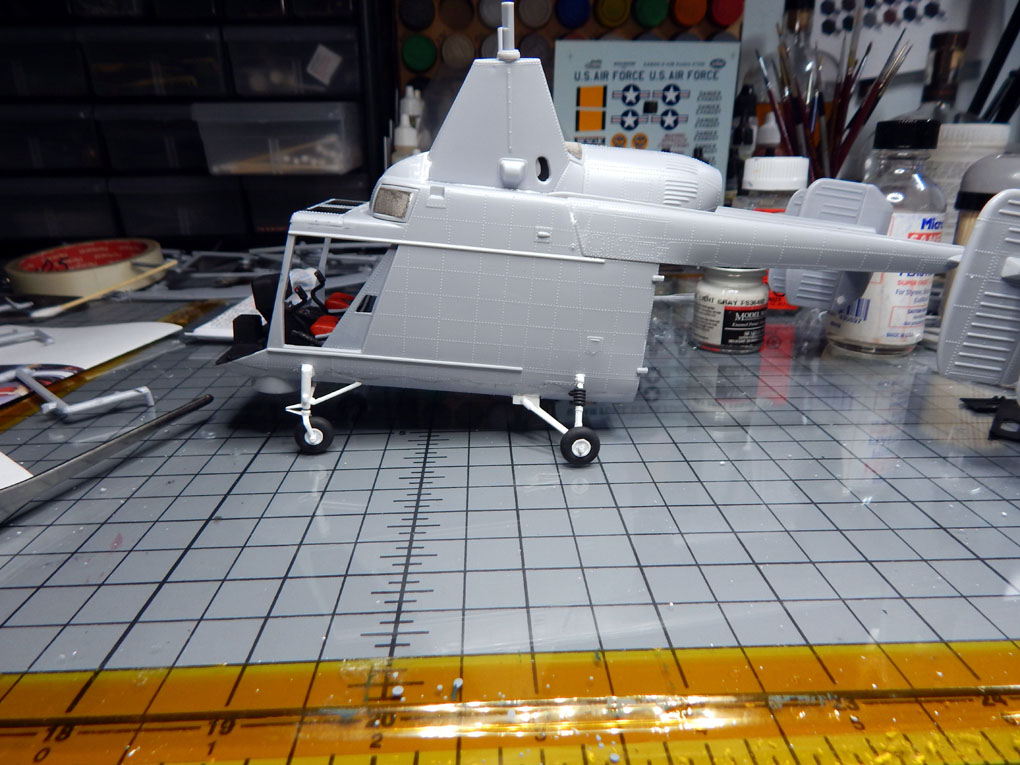

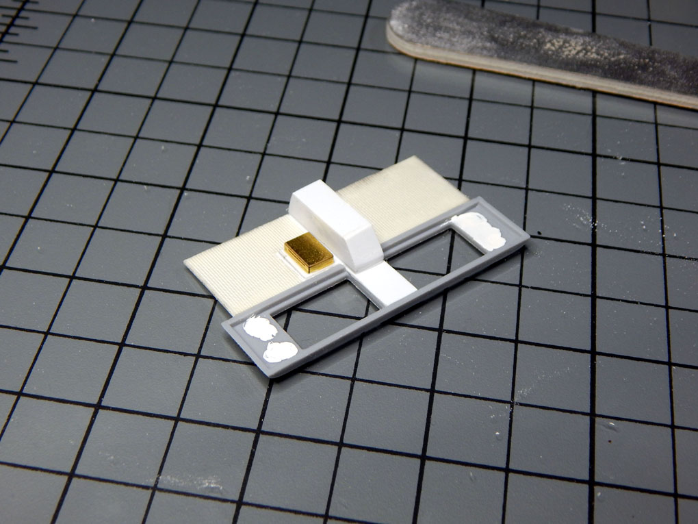

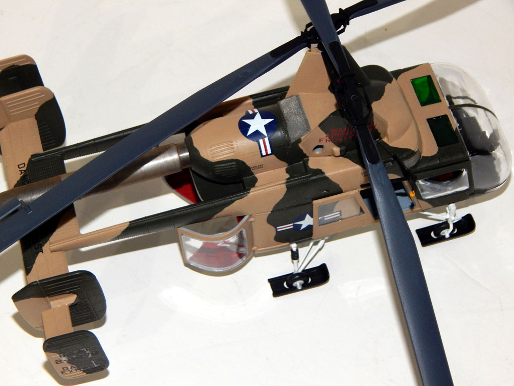

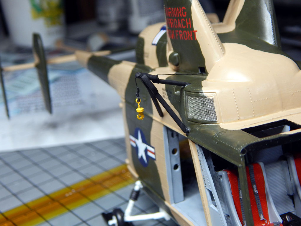

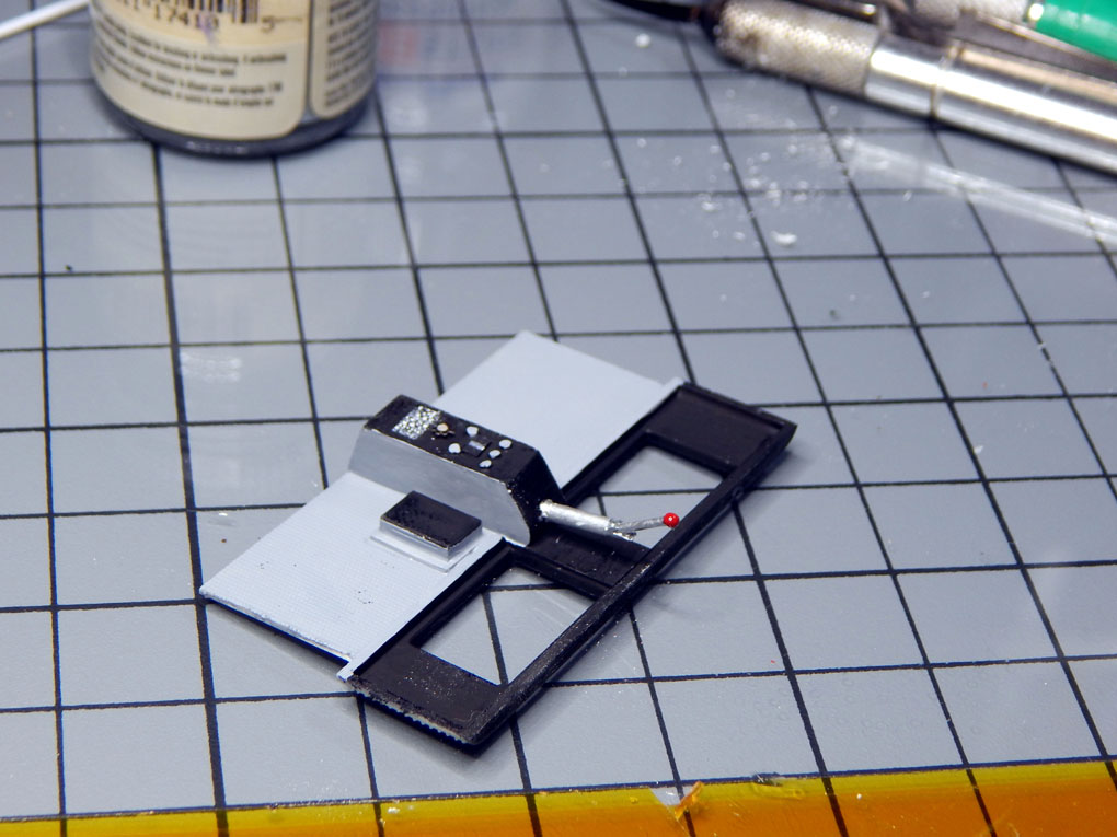

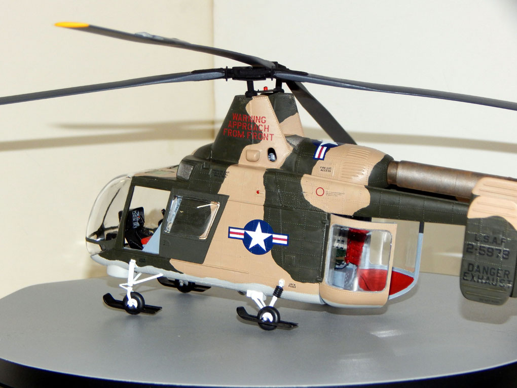

The fifth week of the Huskie Helicopter I started off by doing some cleanup on the fuselage and adding some of the minor details. The kit does not include the overhead console in the cockpit so using some styrene, photo etch, and cloth tape I scratch built the console assembly. For the knobs and switches I cut small pieces from thin styrene rods. There is a long lever on the front of the console. I used some styrene rod for the base and a piece of wire for the lever. I used some acrylic gel to for the knob on the end of the lever.

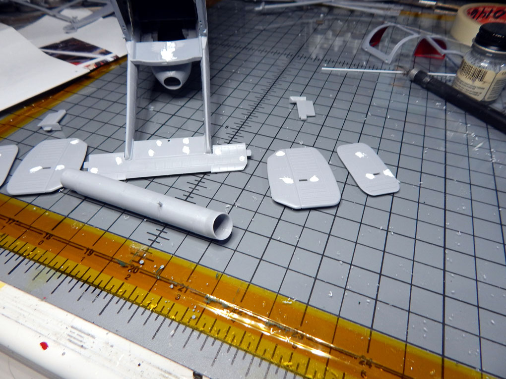

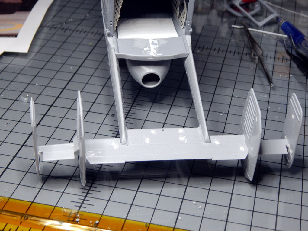

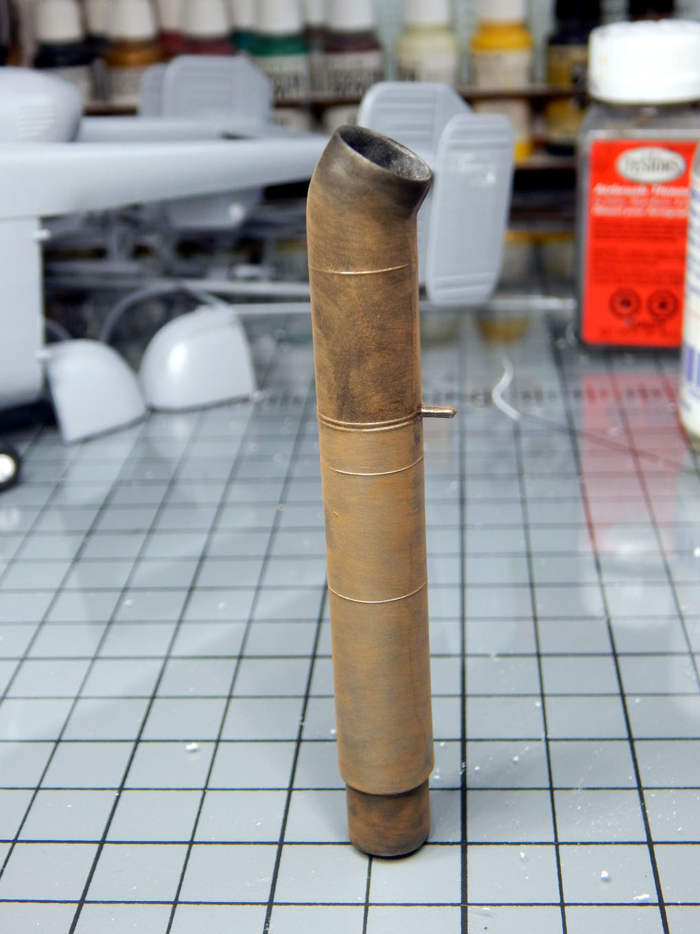

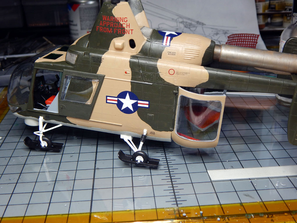

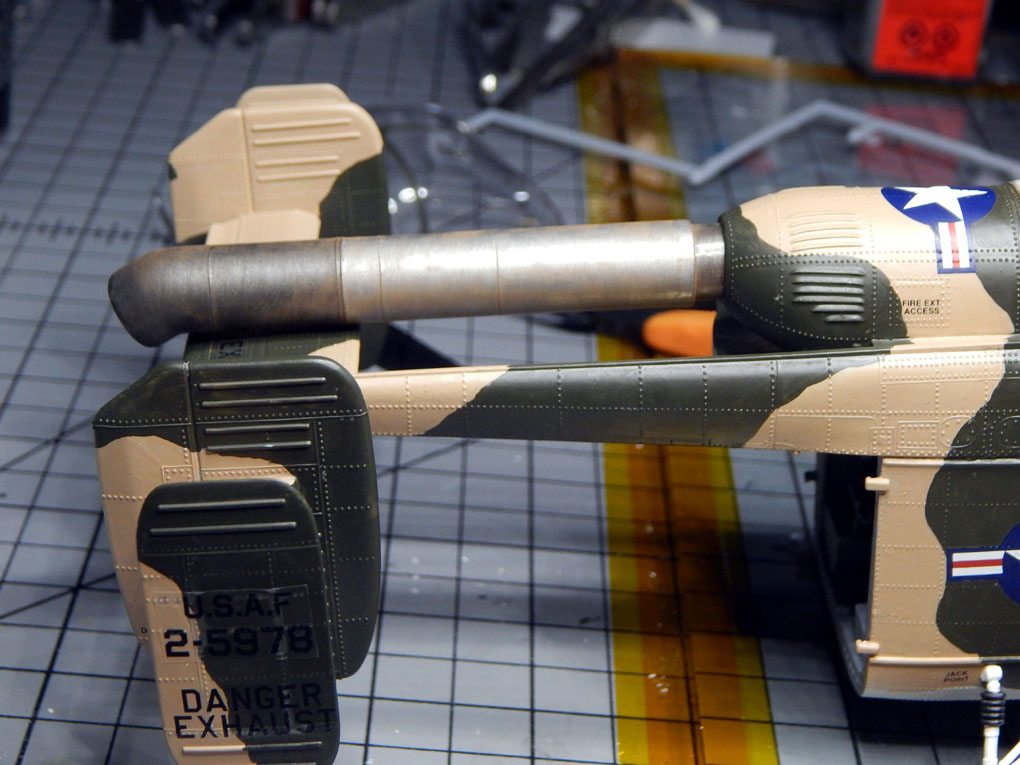

The overhead console was installed and I worked on the tails and booms. The tails had numerous mold marks that needed to be filled with putty. The exhaust tube was assembled and sanded smooth. I also sanded the exhaust end to thin out the plastic as it was way too thick. The tails were installed and required more putty on the outside surface.
Finally I worked on the landing gear. The struts required a lot of trimming due to a lot of flash. I removed the kit molded strut arms and replaced these with some photo etch versions. The landing struts were then mounted onto the fuselage. The landing gear wheels were cleaned up and painted and the skis had some deep mold marks which required putty.

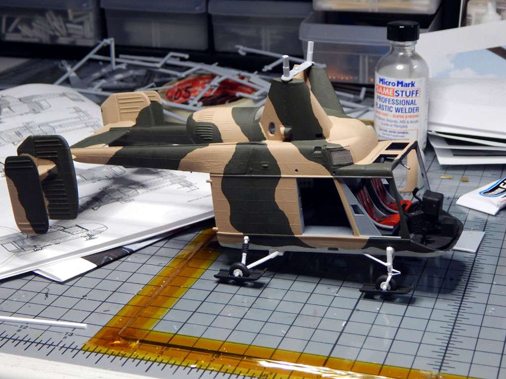

The next week I am hoping to finish some more details and start the painting of the helicopter. I will be painting it in the typical South East Asia camouflage used during the Viet Nam war.
