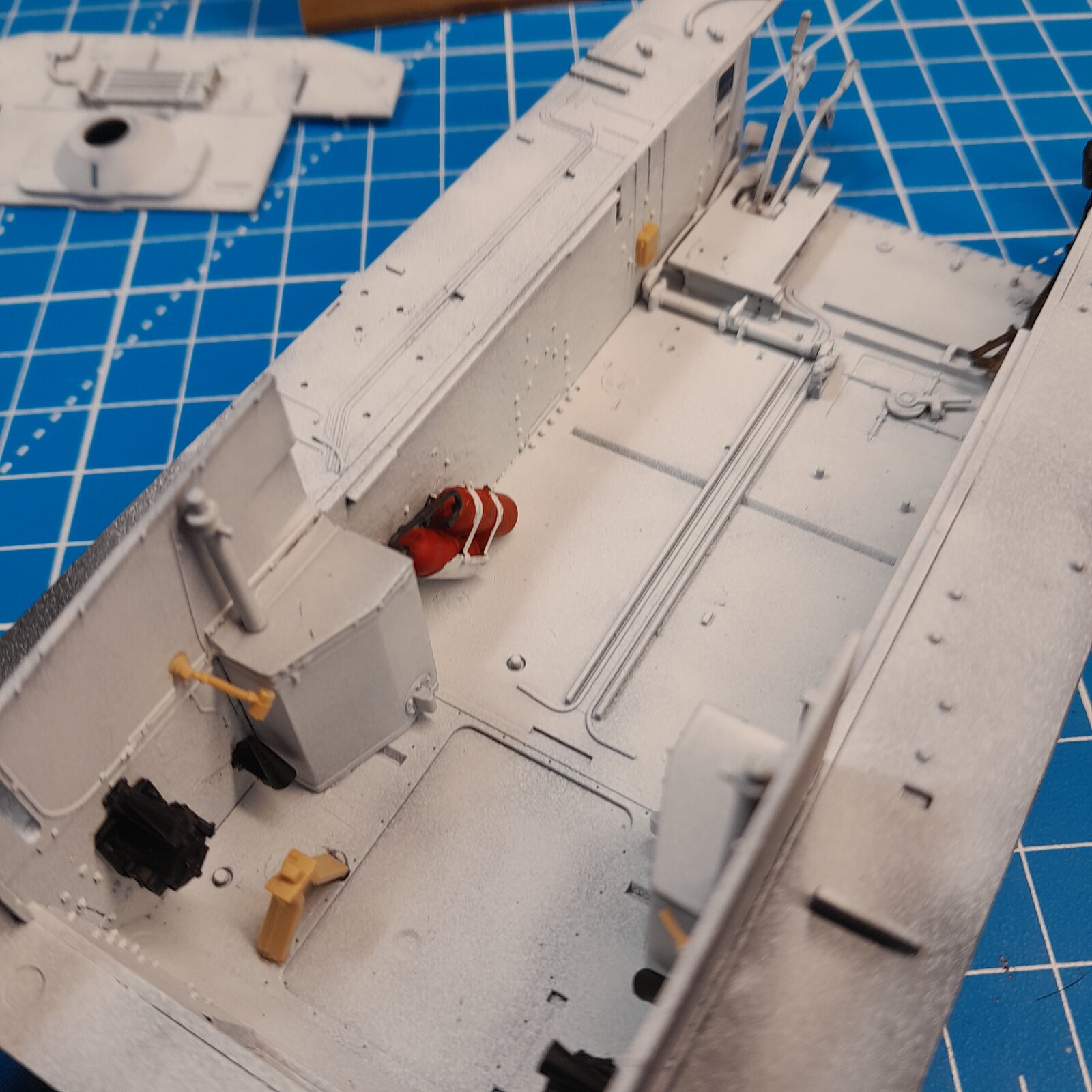

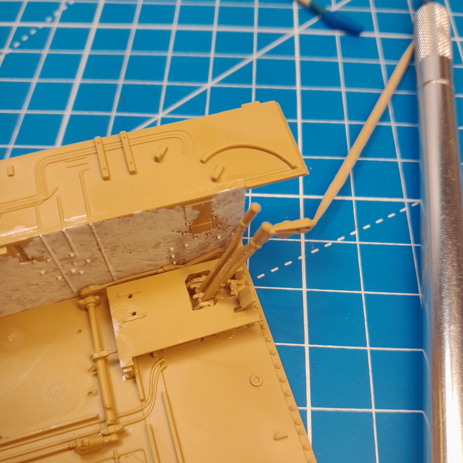

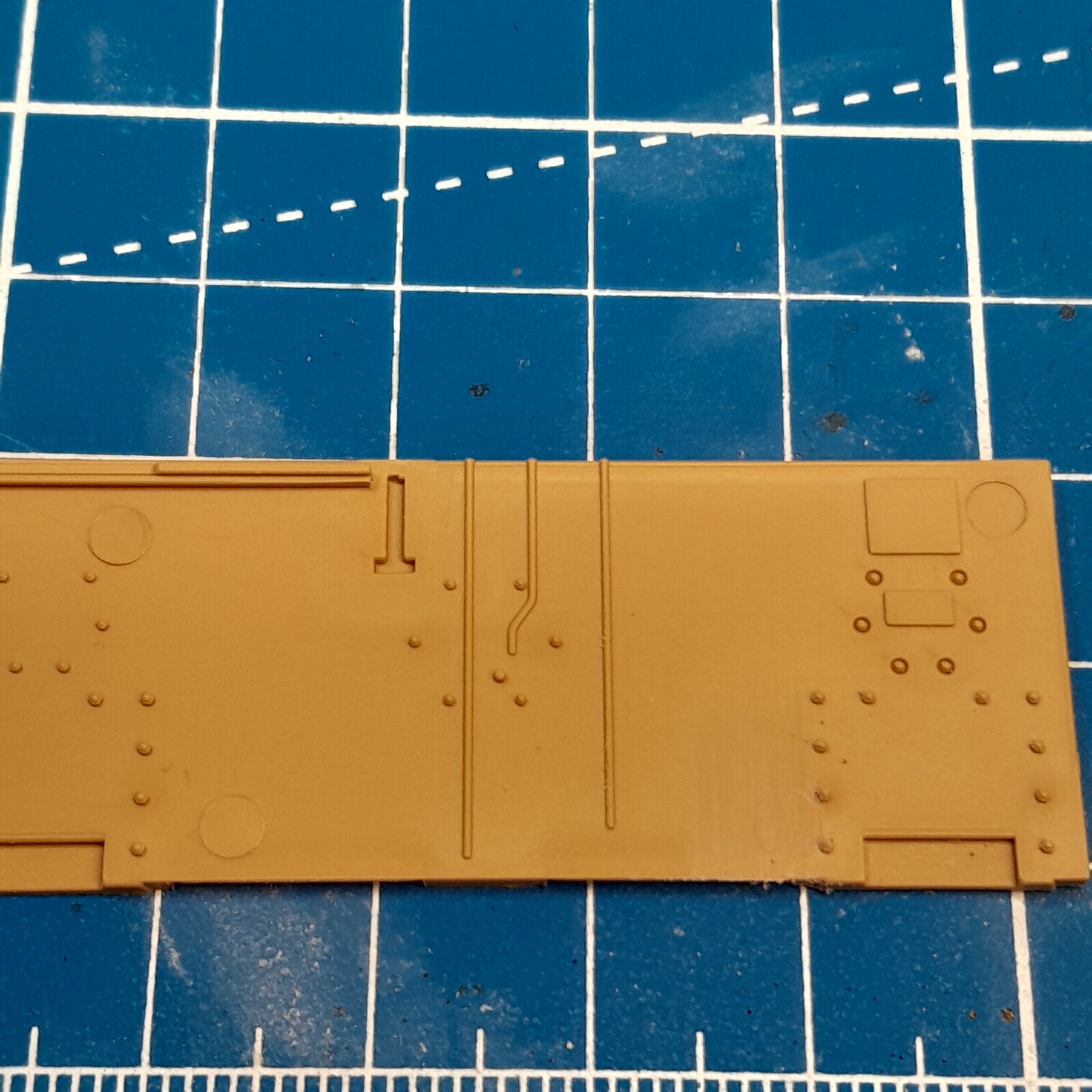

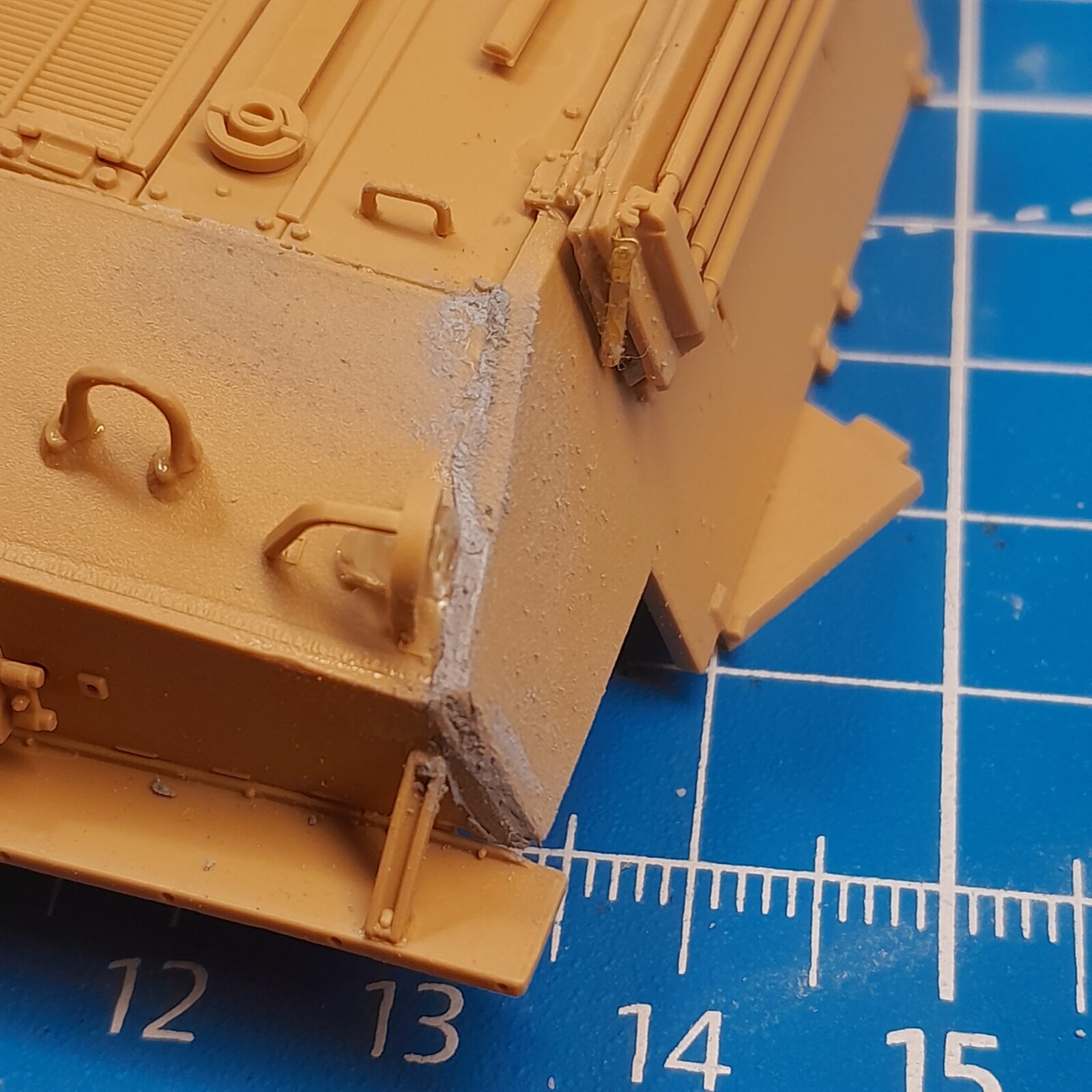

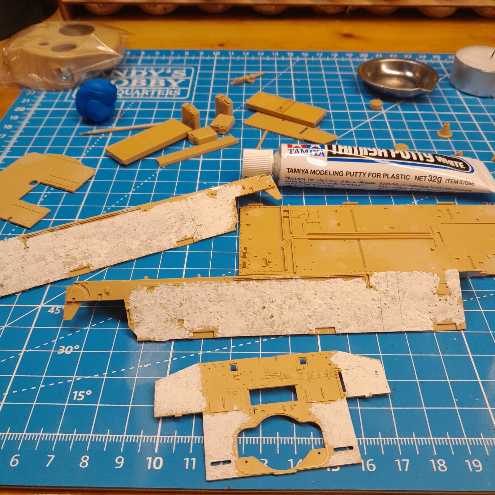

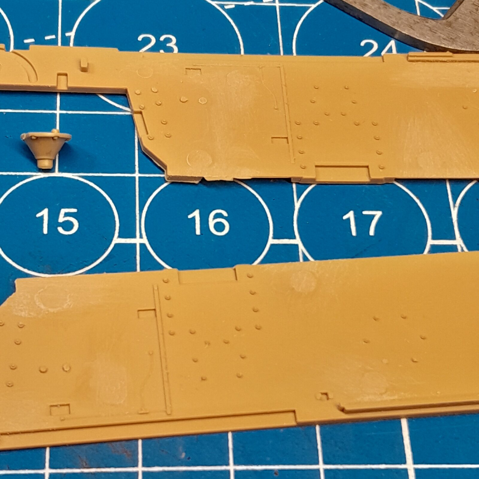

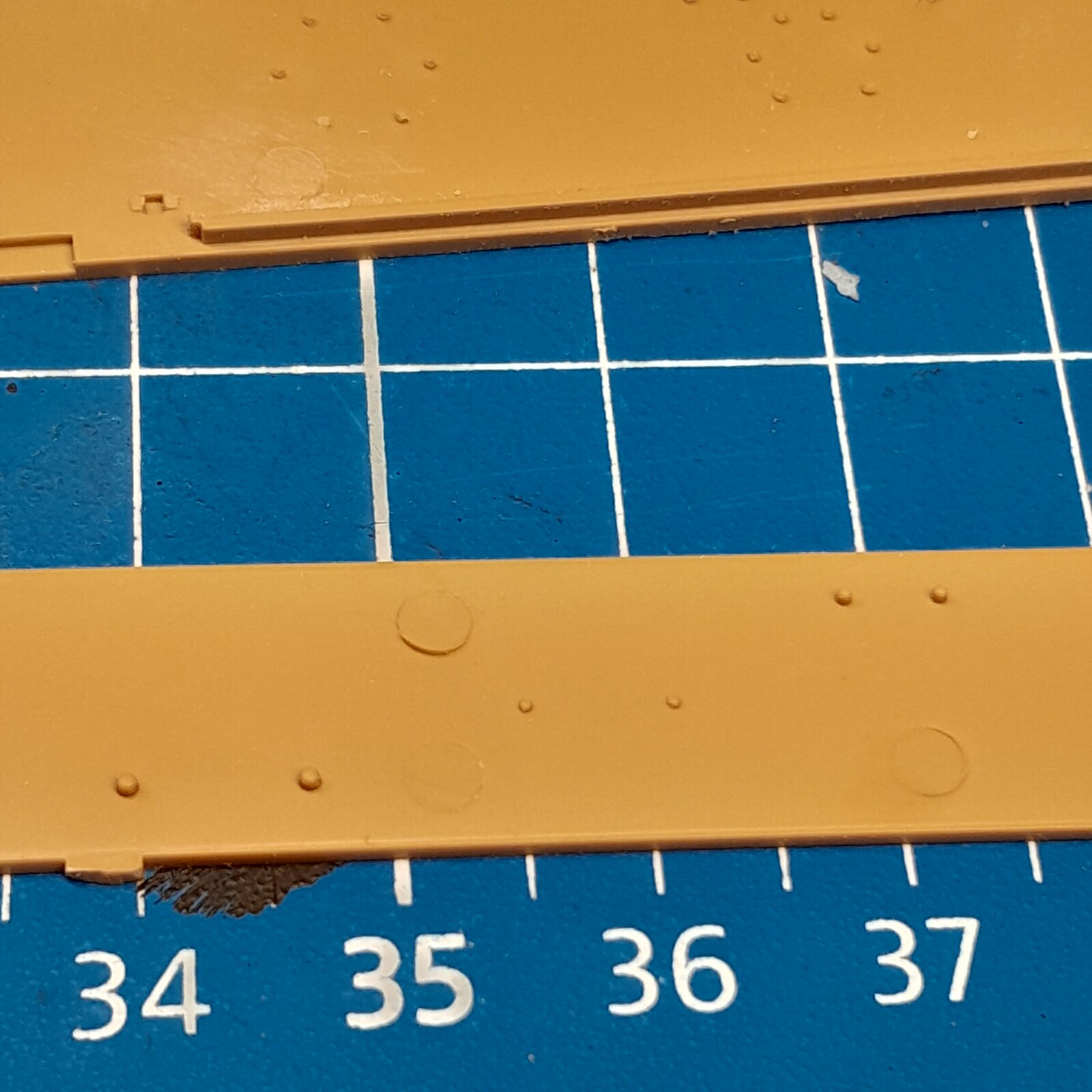

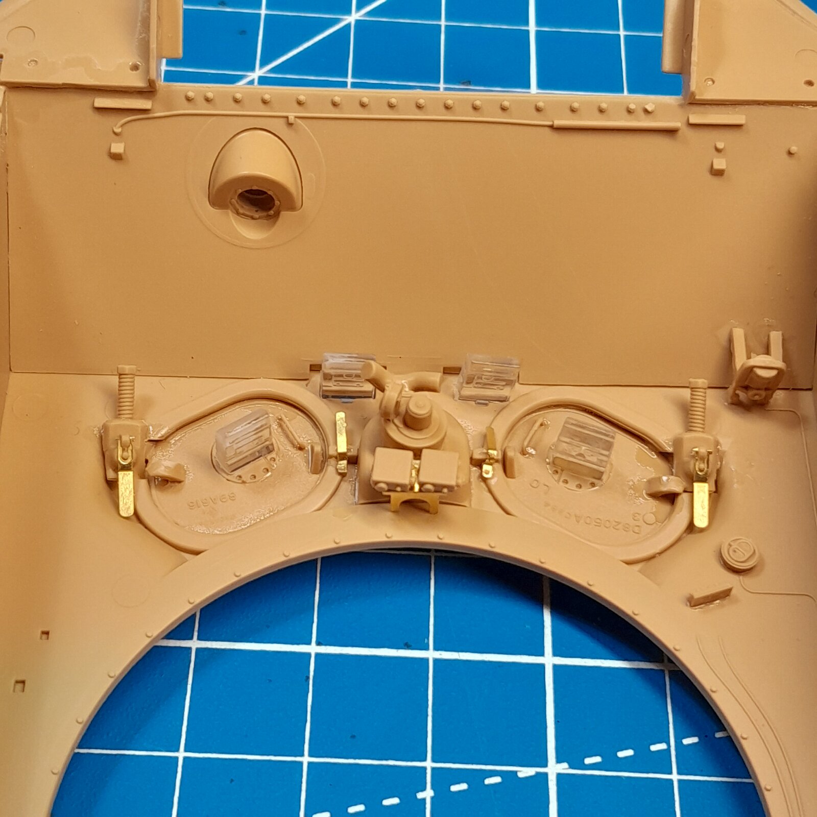

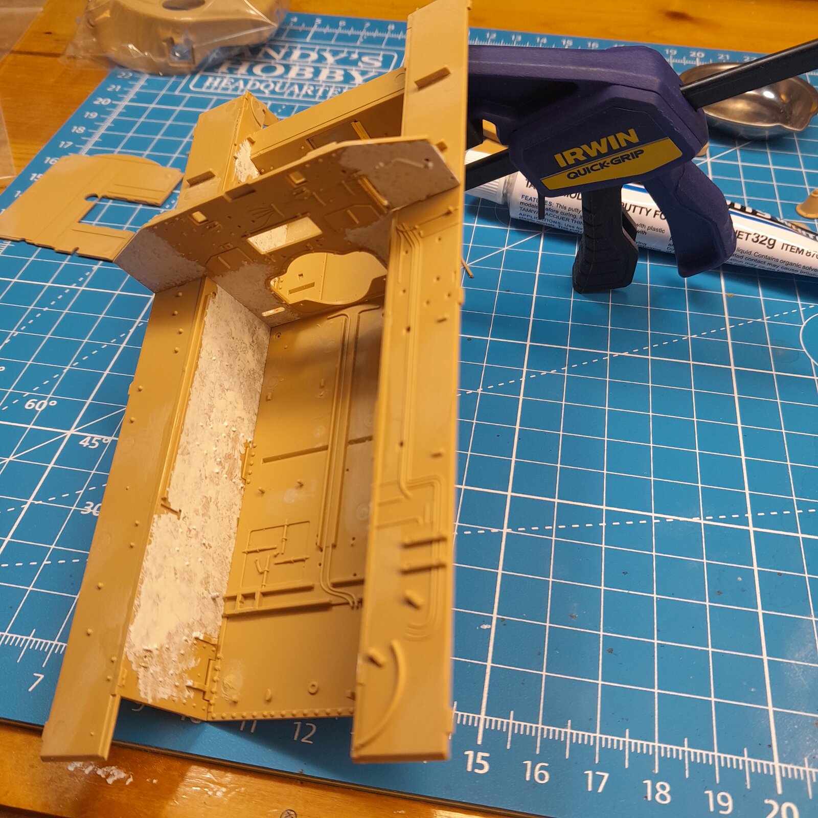

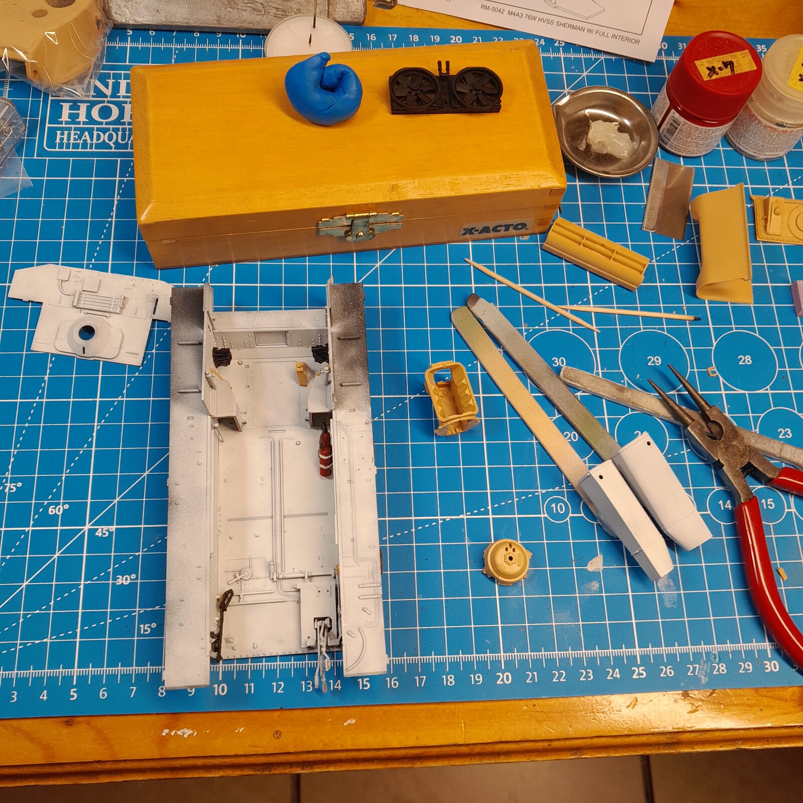

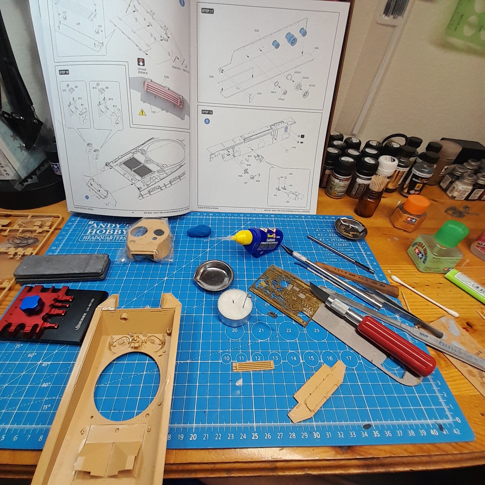

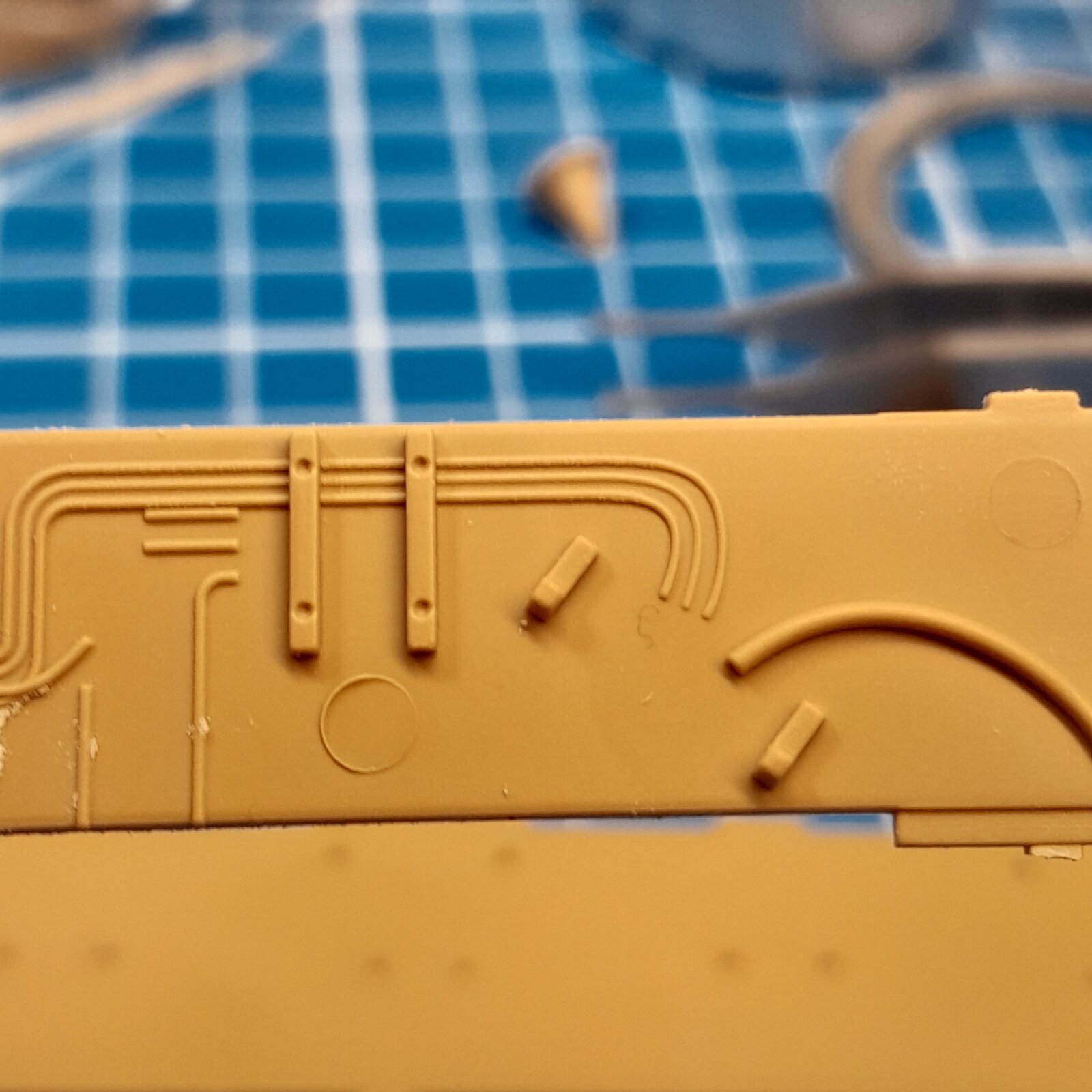

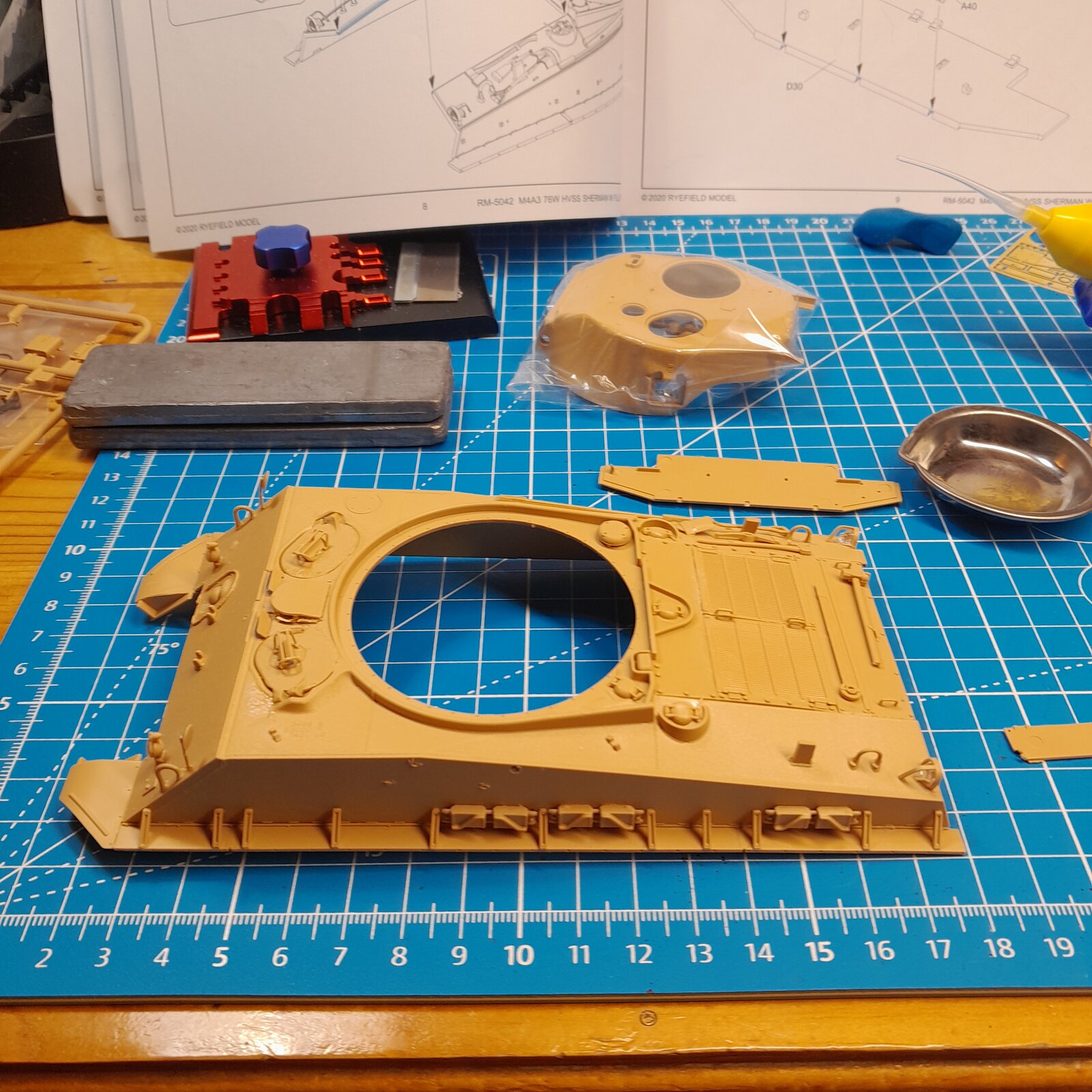

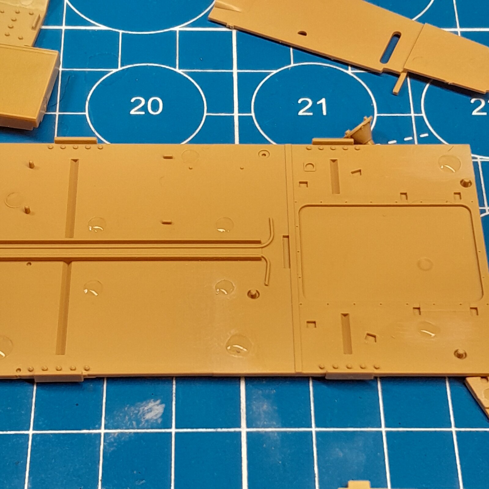

All right I'm back. Been busy with Father's Day and 36 year anniversary. Holy poop, I'm not young anymore. Okay just working on it slow mainly because I don't know what the heck I'm doing. And I want to get it right. Give me an airplane kit with no instructions and I'll get it built. But I've only Built one tank before this and it wasn't with an interior. So right now I'm going through the interior panels and sanding down raised sink marks and filling in the indented ones with super glue thick. I usually use basic putty but I saw something on YouTube where he used super glue and sanded it down so I think I'll try that. Also I think the seam in the back end? I think if I roll out some two-part epoxy super thin I could make a respectable looking weld joint? So I'll get all the sink marks worked out and use some thinset and a brush and get some texture on the walls and go from there.
