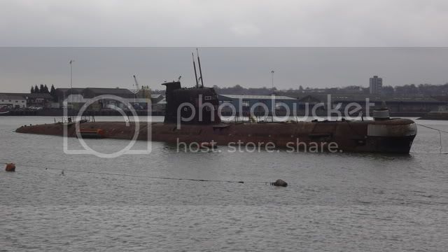

Found this on a local river where I live
Don't see many Russian subs knocking about on English rivers
Had to look this one up..she is the Soviet Foxtrot class hunter/killer Sub U-475
