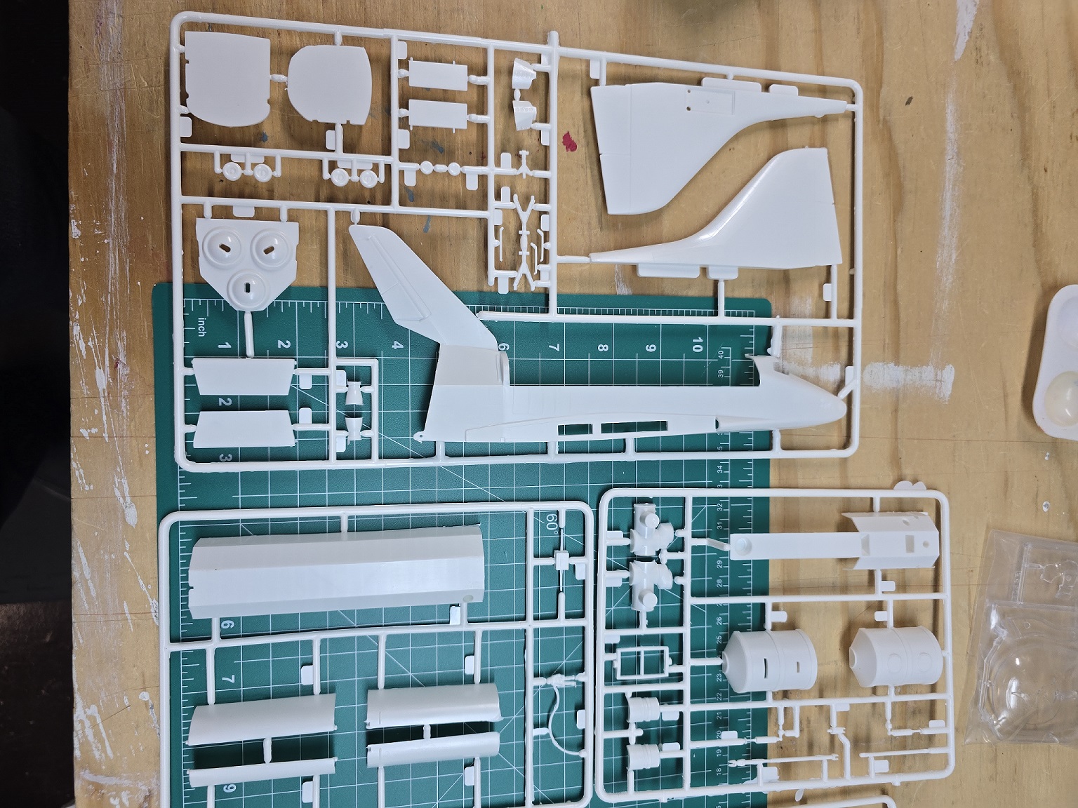

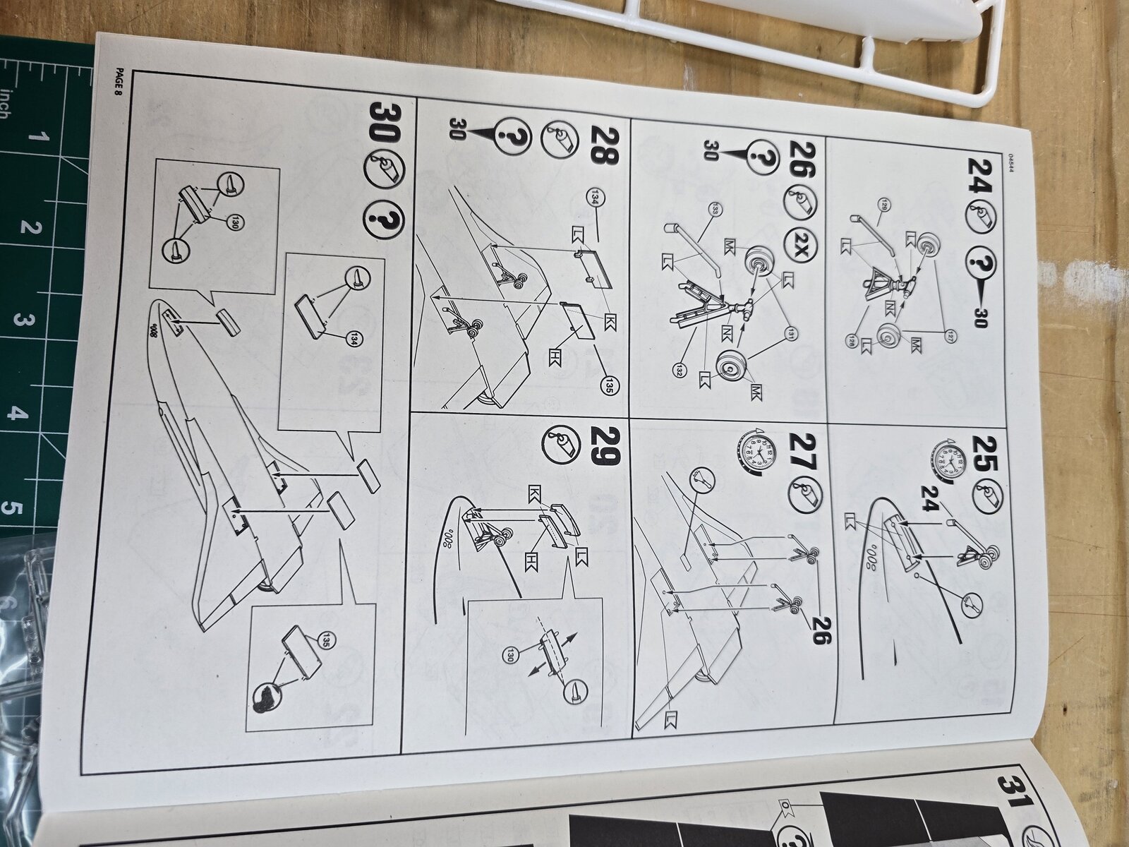

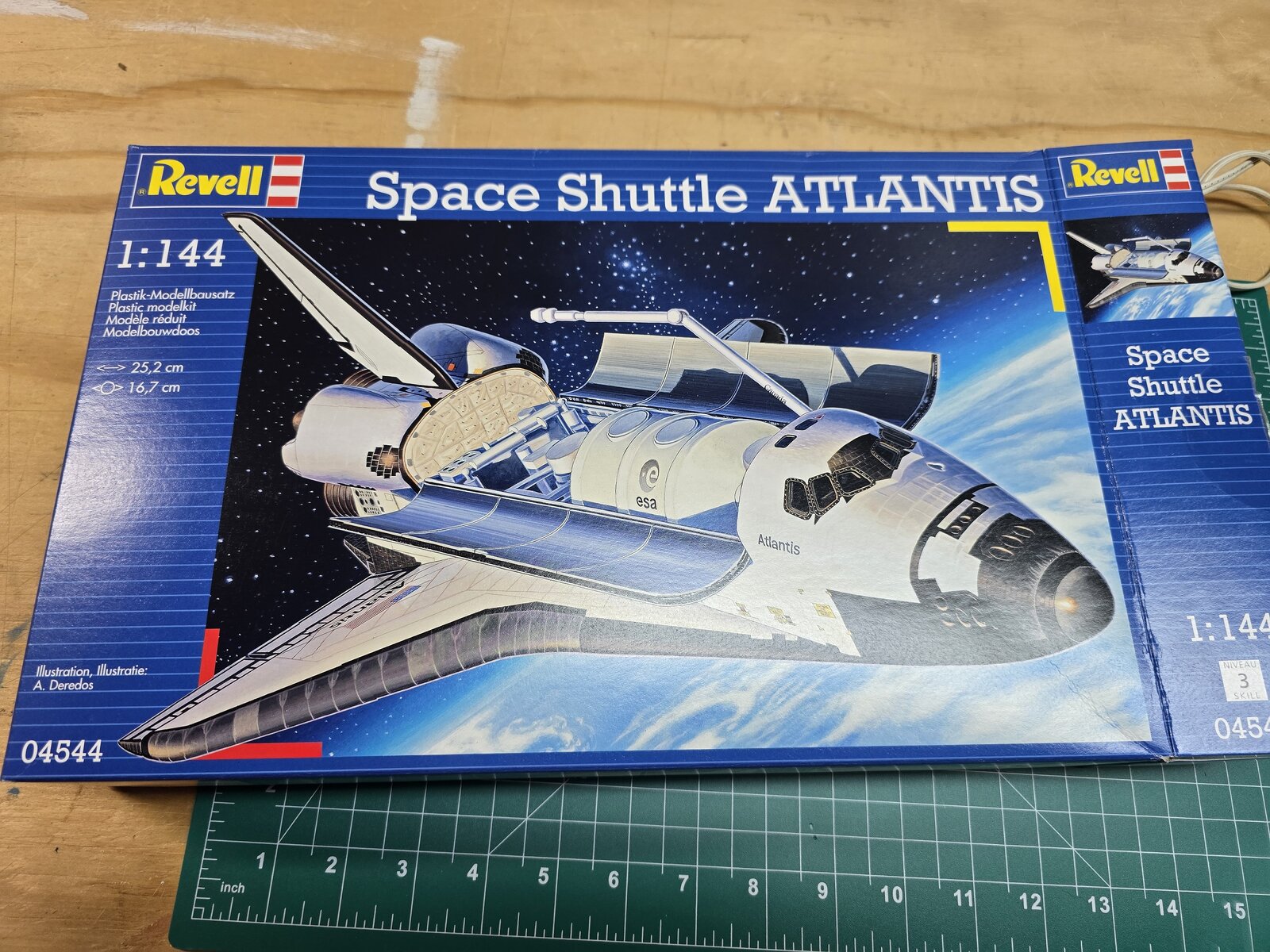

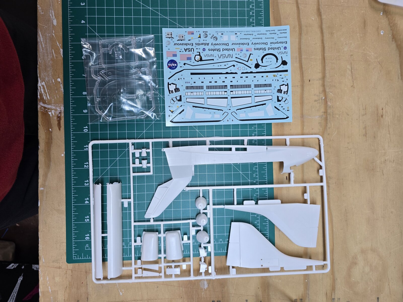

Needed something to do over the winter, so I decided to try a model. There are three white sprues, 1 clear sprue, a variety of shuttle decals, and instruction book. The book appears to be clear and notated well. I Noticed decent amount of flash right away on many pieces. I cut the first few pieces out to see how the fit was, and I think it's going to give me some challenges. Did some sanding and filing which helped a bit. I think I'll spray prime the entire sprues to make it easier, then figure out the best time to paint pieces or sub assemblies. We'll see how this goes....

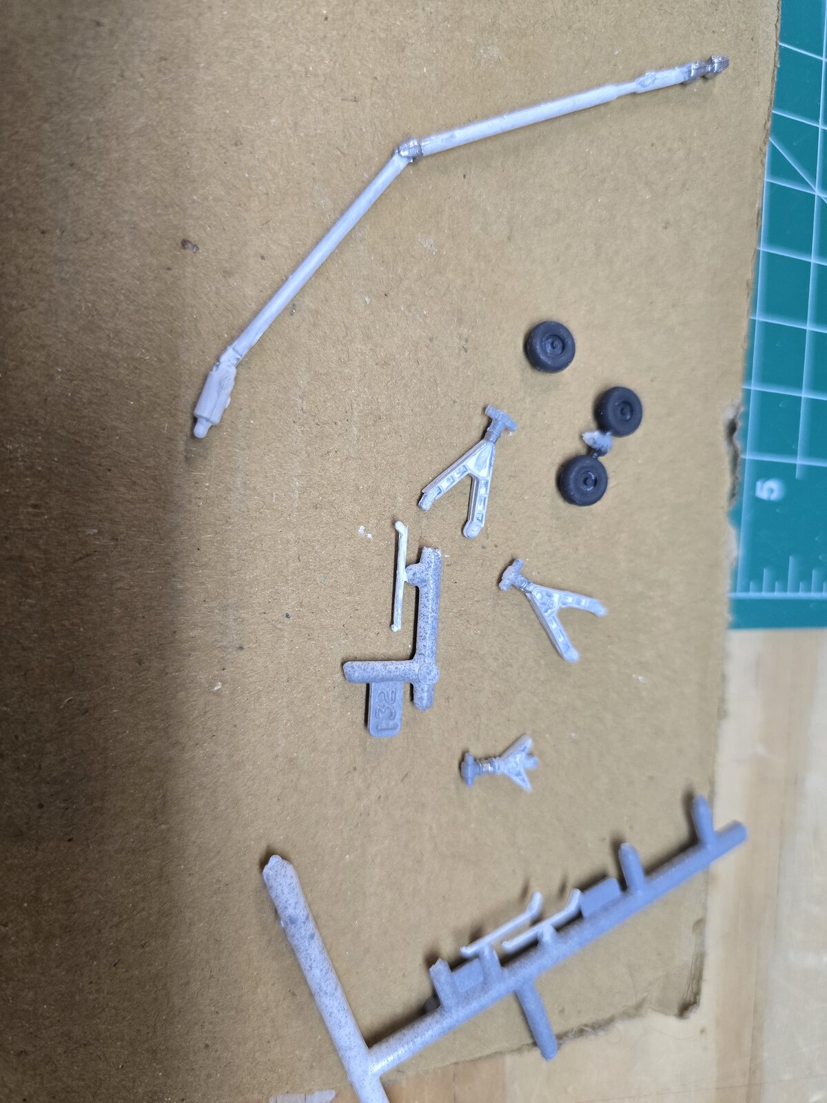

Hope you'll pay particular attention to that Canadarm! ;)

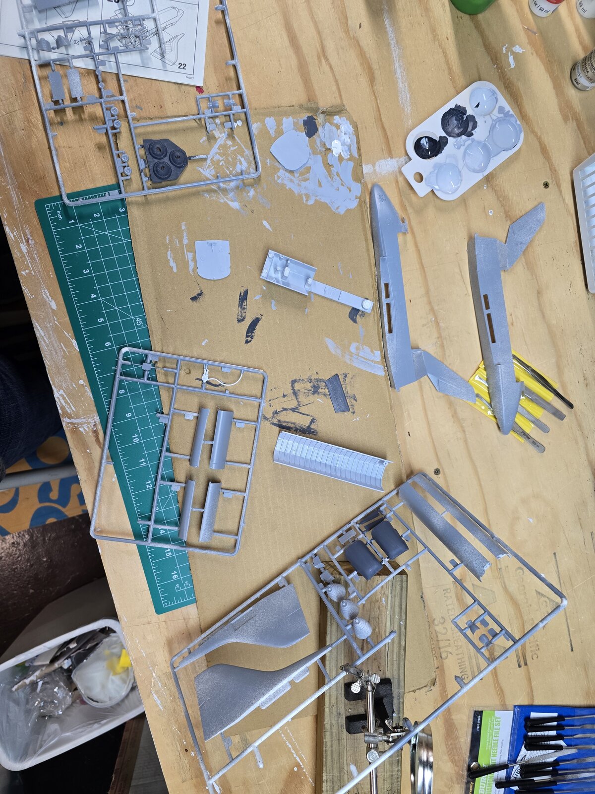

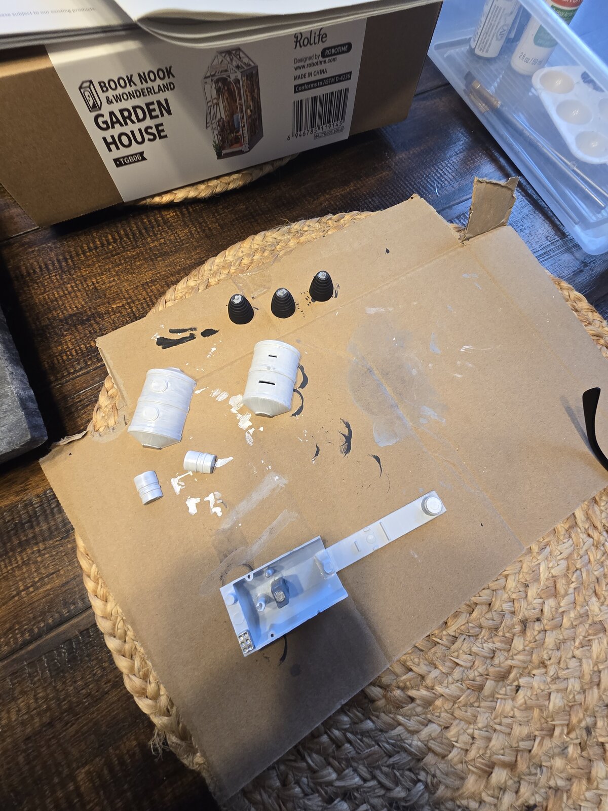

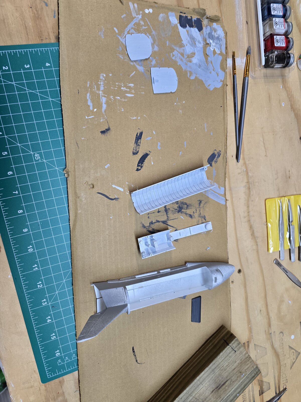

Well, there are 4 white sprues, not 3, lol. Didn't really know if it would be better to paint before assembly, or afterwards. Going to do a bit of both so if I build another I'll lnow better. The two parts that make the fuselage took a fair amount of filing to line up decently. Using general purpose craft paint because it's here and I didnt want to invest a bunch of $ in model paint for this one kit. I'll reevaluate that stance in the future if need be. It isn't ideal and doesnt lay down like I want, bit it will do enough to bring this girl to life.

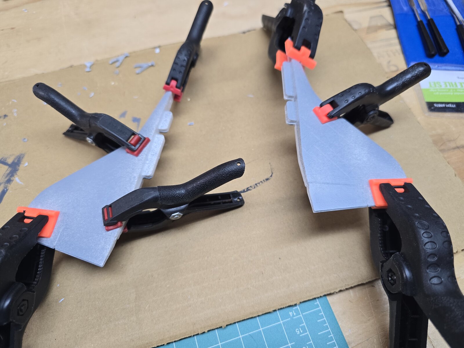

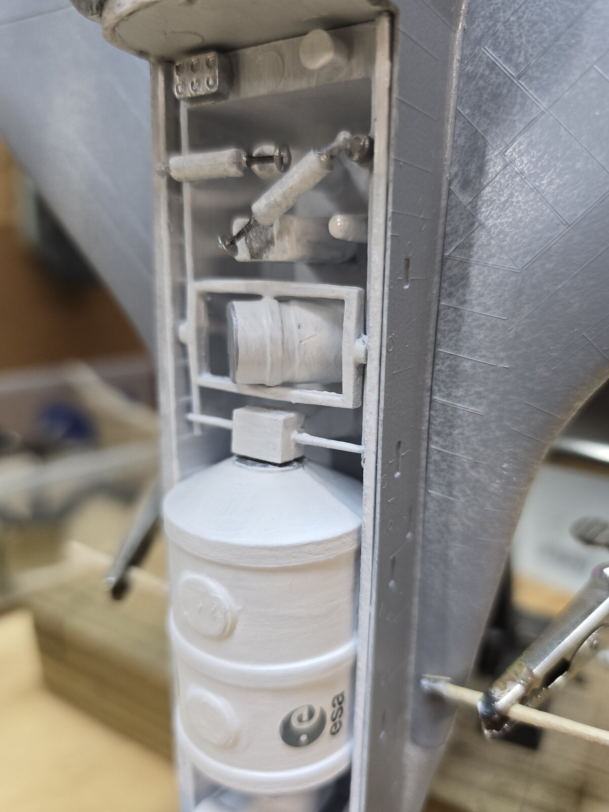

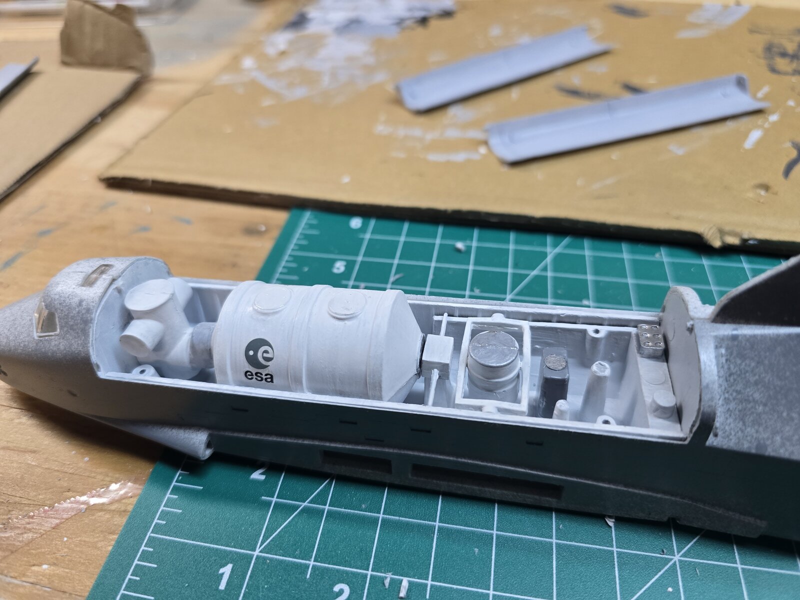

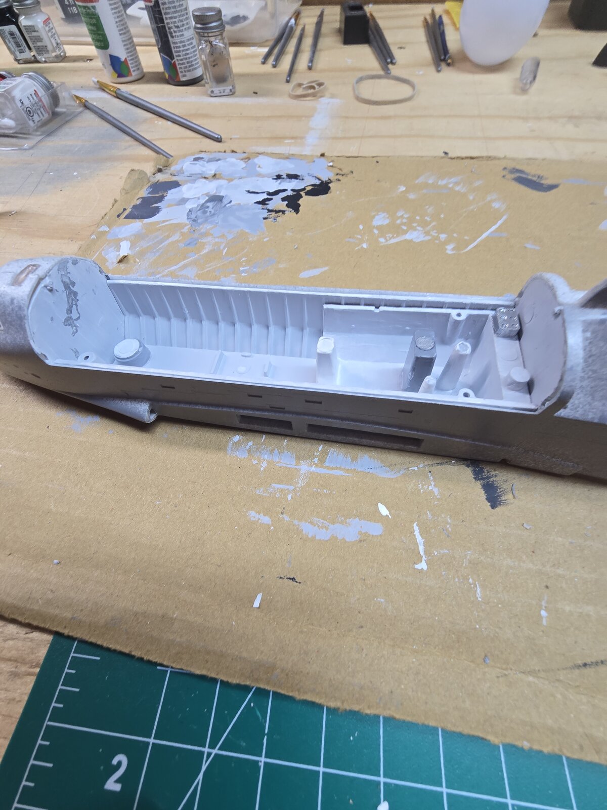

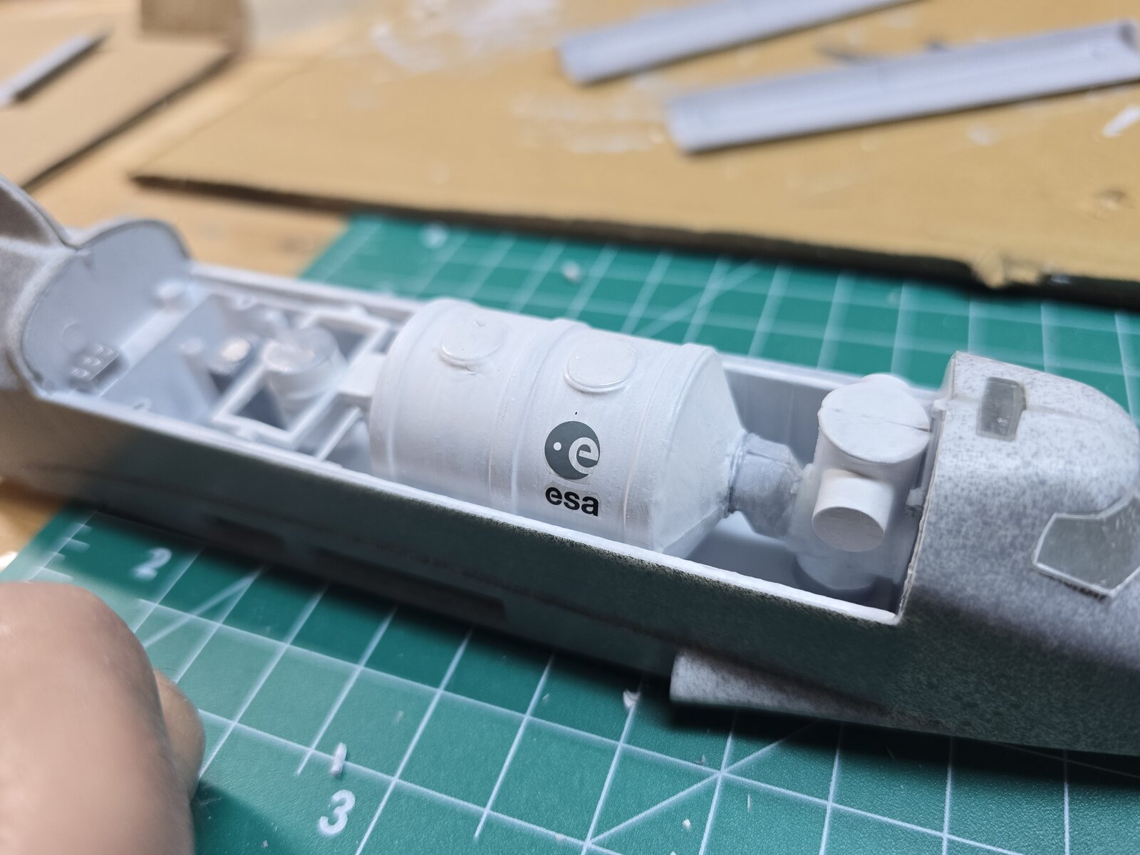

Got the wings fitted and glued, inise of.bay doors primed, and radiators primed. The cargo bay of the orbiter is beginning to look like something too. Did ok with the decals on the ESA module for a newbie. The fit between some sub assemblies is rough looking, but didnt wamt to file and trim excessively and potentially ruin parts altogether.
.. I know eh? I guess that is something we'll get better at with experience. I'm still learning, so others please jump in!
I found that filing works to a point, and sanding too, but in some situations, scraping gives me better control. There are special tools, but a sharp #11 blade, with just a little pressure, makes a great scraper pulled sideways along a mold line on a convex surface, removing a minimum amount at a time.
Like @TimM63 , no less than 400 grit sand paper, and then carefully, avoiding scratch marks in the plastic that need even higher grit to remove.
With cylinders and other rounded features, I've started using sanding sponges, and they work great because of how they conform to the shape and don't flatten the cylinder!

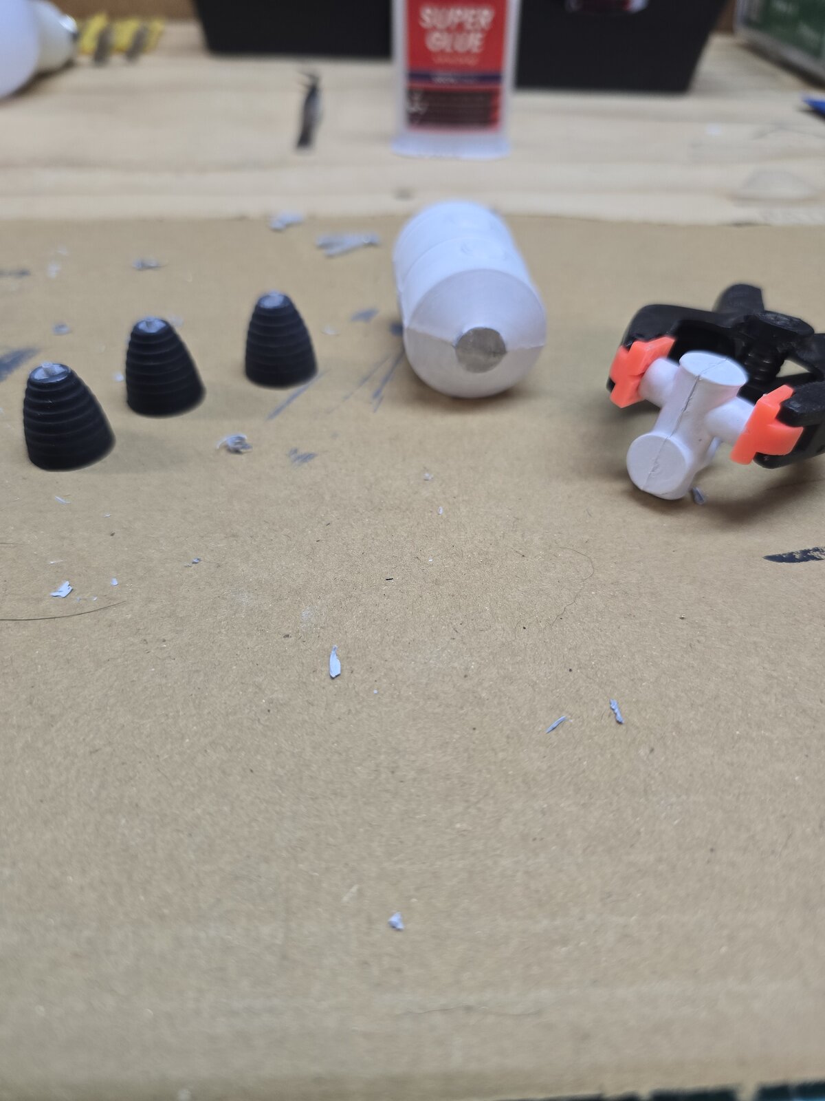

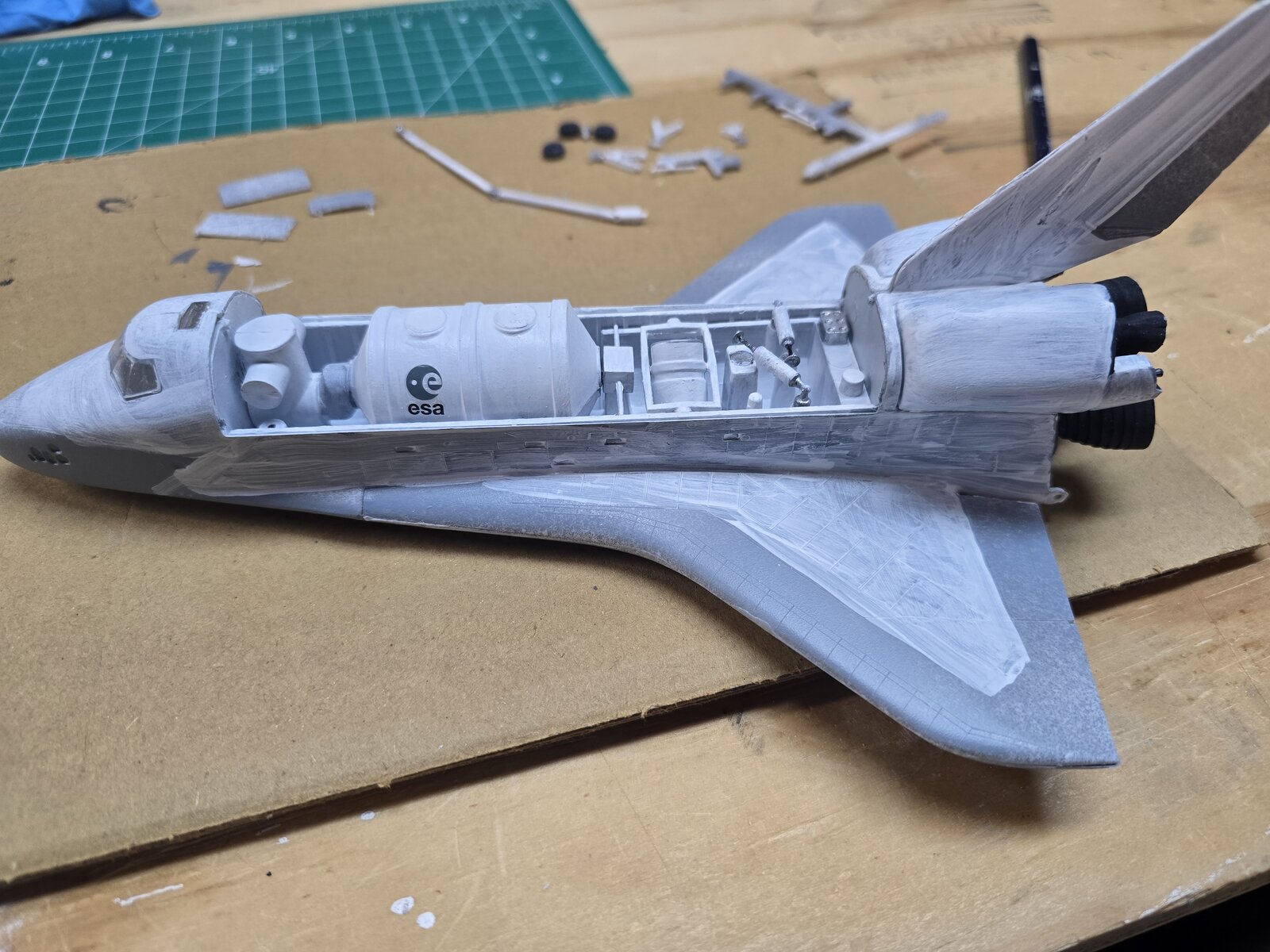

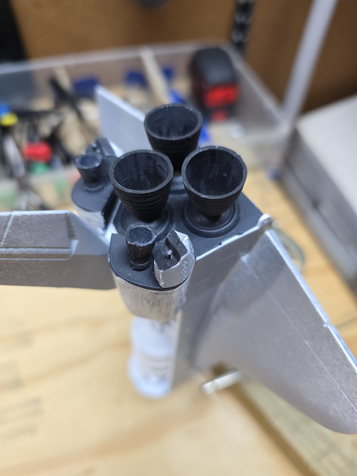

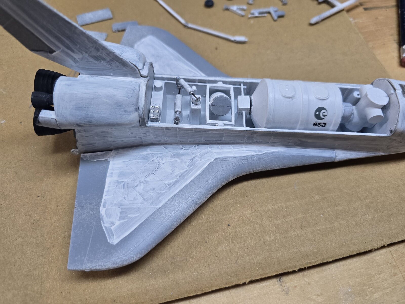

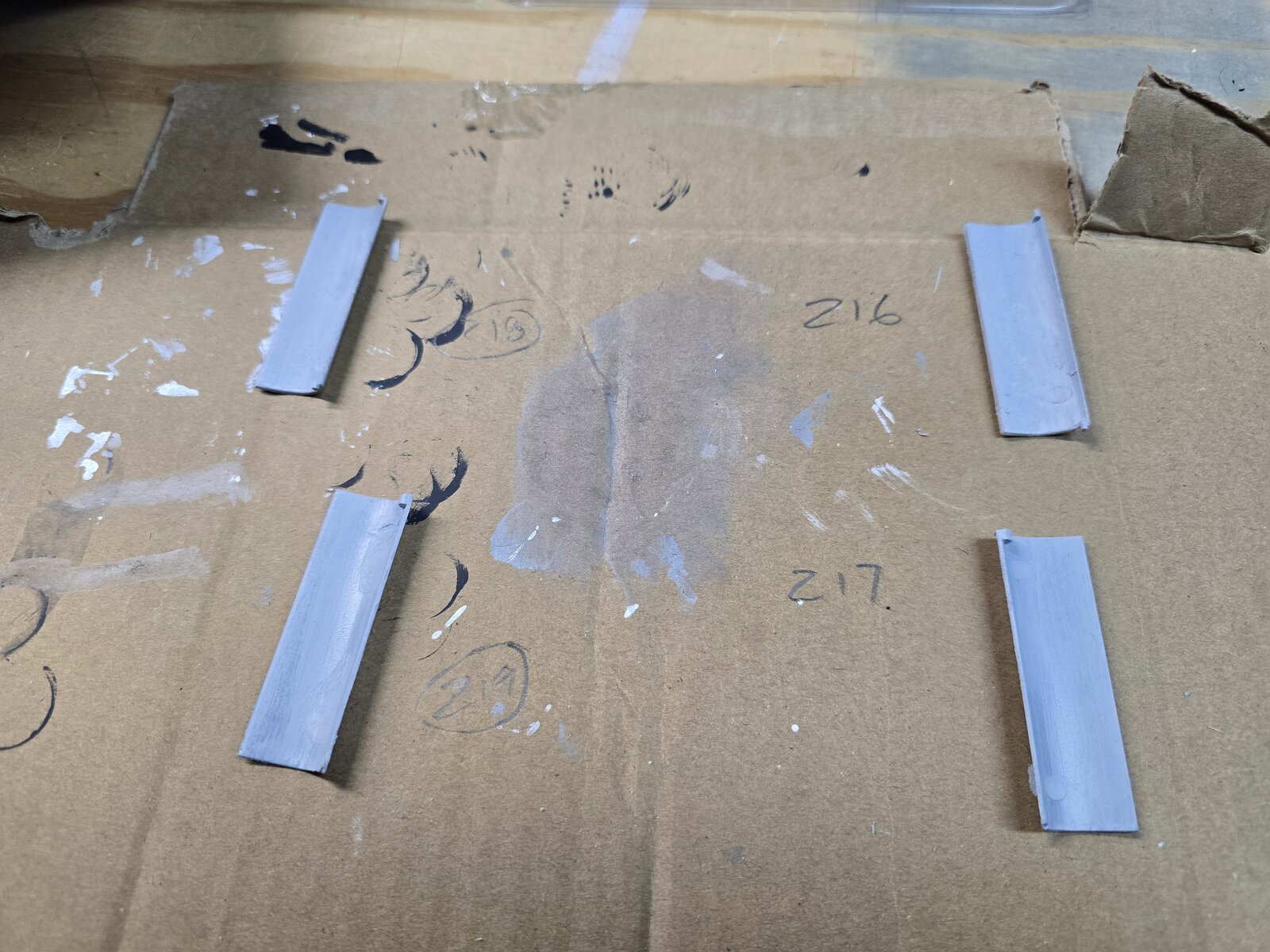

Thrusters and wings are now on the orbiter. The radiators are painted, but not glued to the vargo bay doors yet. I'll.probanly wait to do that until Im done handling the vehicle so much. Starting to think ahead as to how I'm going to paint the main body and underside-....spray paint in the spring? Brush it? Hmmmm.....

So there are all kinds of brush strokes on the body. Ill see how subsequent coats cover. I may have to save the bottom for weather that I can spray paint in. I'll mask whats completed and spray...
I'm learning as I go and as I do, the shopping list does too, lol.
Tamiya are very thin paints and are often best built up in layers.
Just make sure you let the first layer fully dry, otherwise each layer you paint over will just eat at the old layer and wipe it away
White (or various off whites) are a very hard color to brush on and hide brush strokes
They can be brushed on, but I find over large flat areas it is just so much better with an airbrush
If it was me, I think the easiest approach without and airbrush would to spray it white with rattle cans, and brush paint on the black
You also do not have to wait until spring. I prime models all throughout the winter outside. Just make sure to quickly go out and come back in rather than leave the cans/model sitting out there and avoid days with lot of moisture in the air

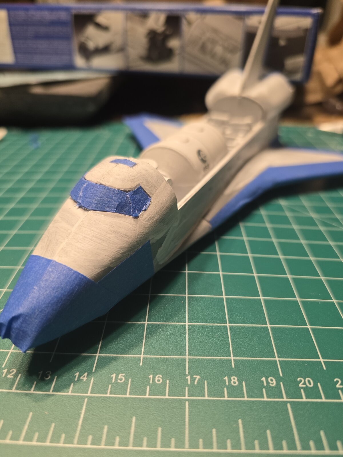

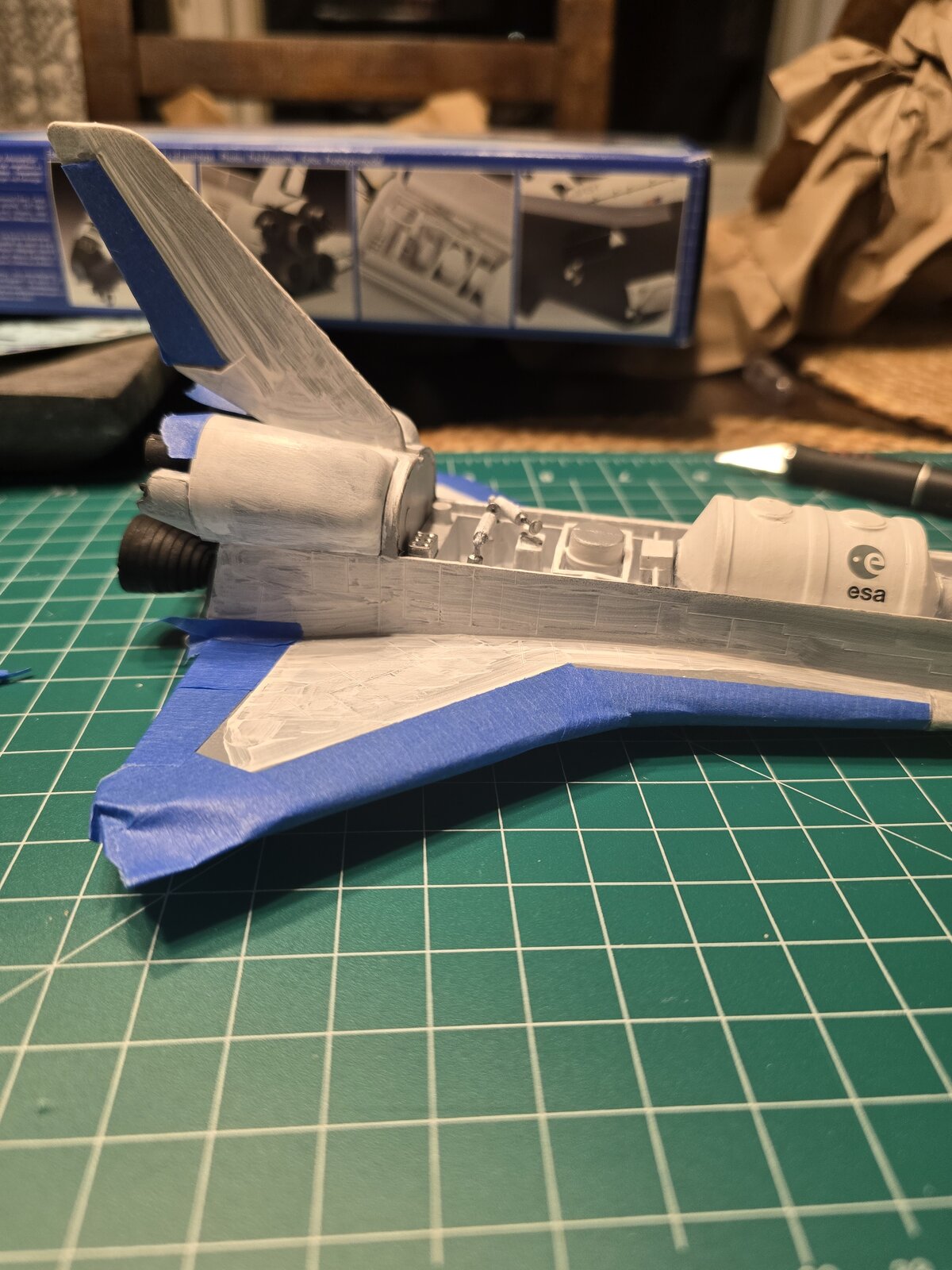

Decided to give rattle can a try, so I started masking this girl up. Not sure how I will cover the rear thrusters, but Ill figure something out. When weather seems not too damp per blakeh1's counsel, I should be ready to spray her. Next I'll need to watch some videos on how to do these decals because there are a bunch...and many are quite small!
