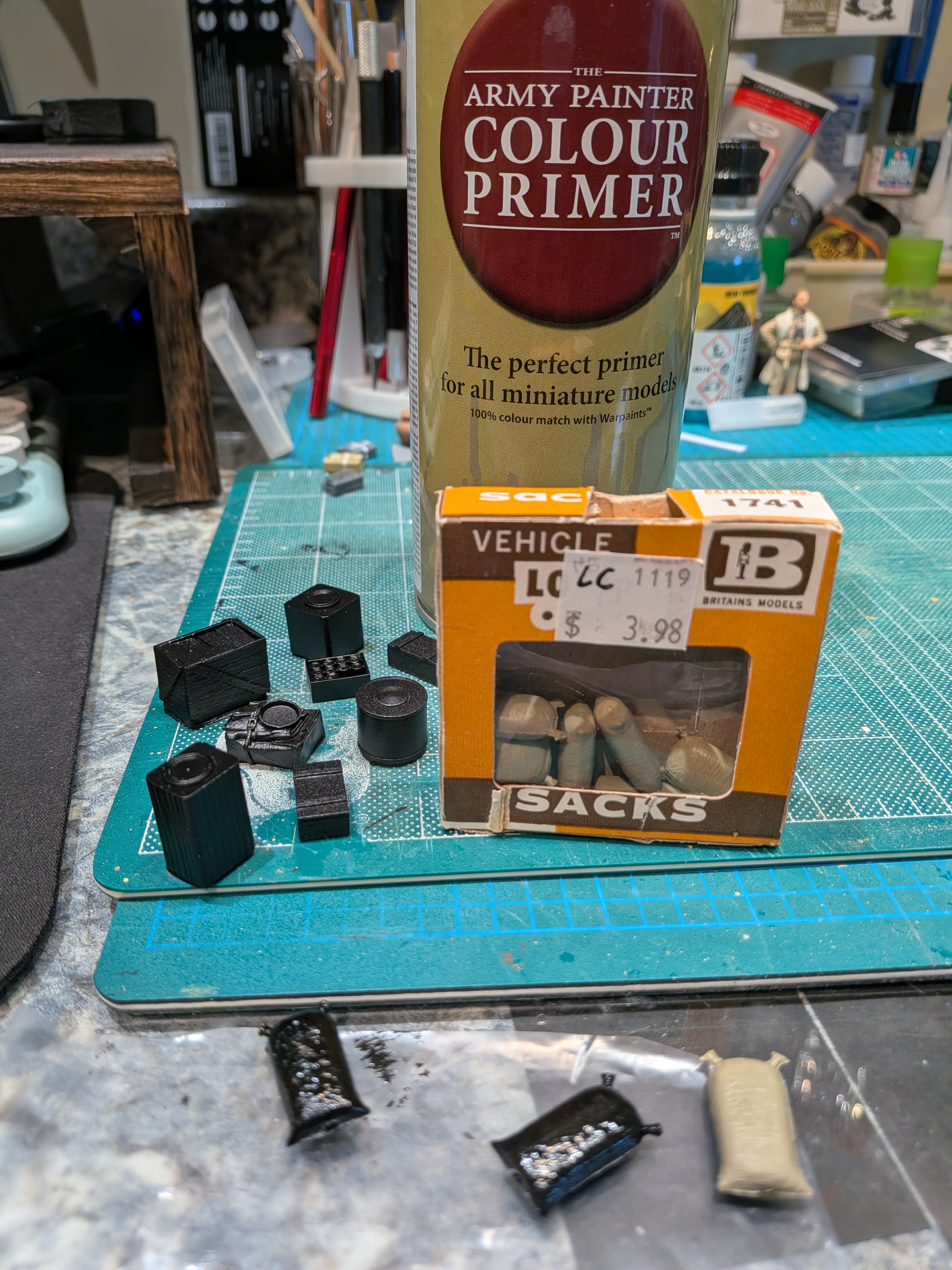

Got a bunch of aftermarket accessories together, mostly resin. Along with two 'sacks' in a more rubbery material.
Primed with Army Painter black primer from rattle can.
One hour later, retrieved from spray booth, all felt dry to the touch.
Two days later, the sacs are glossy, sticky and definitely not dry!

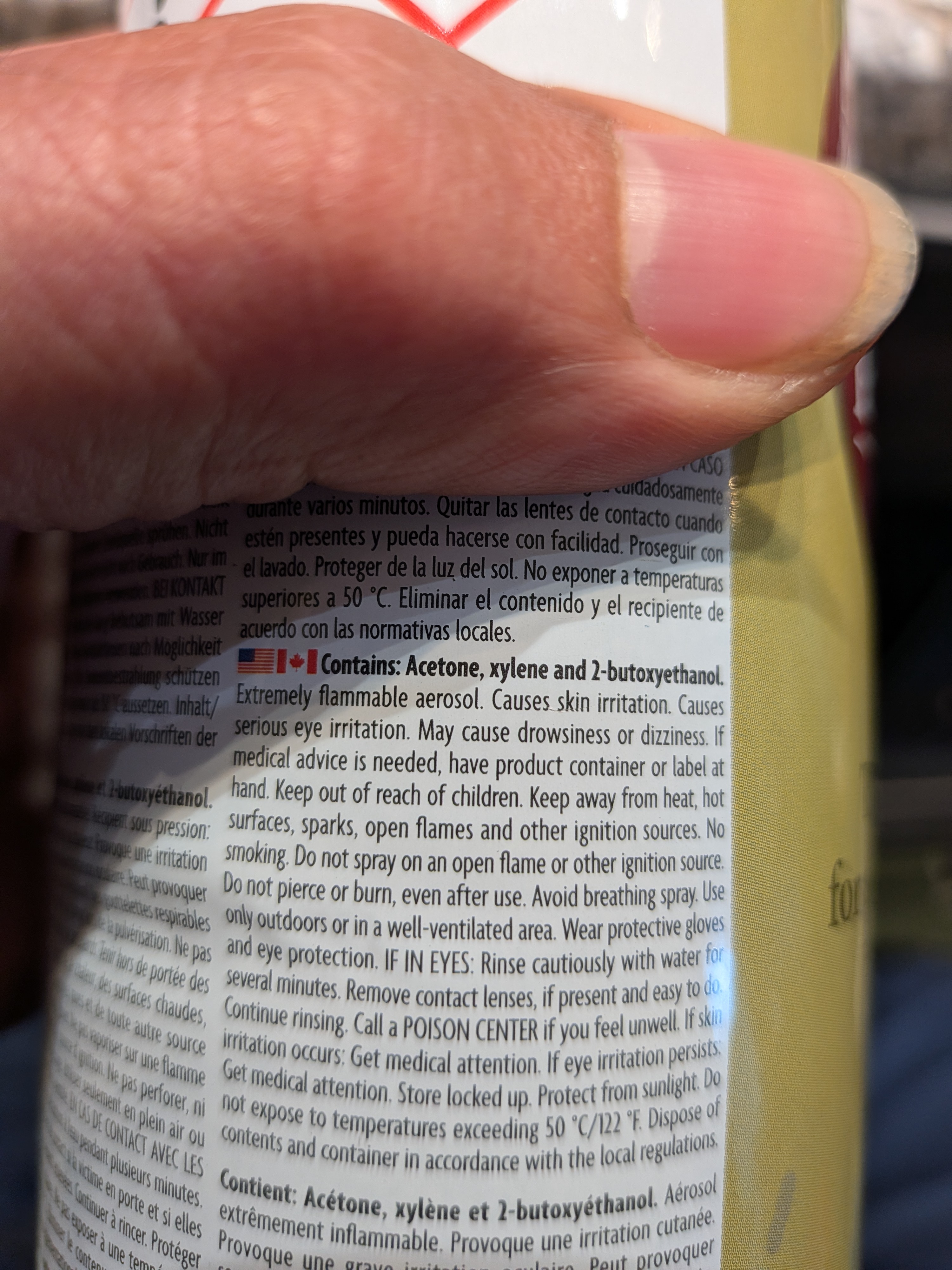

Close inspection of paint label reveals ingredients:
Probably not salvageable, but any suggestions on either how to stabilize, or remove the paint before it dissolves the sacs? 🤔
Yup, I have a knack for digging up "interesting"! 😆
  • They have a seam which runs all the way around.
  • Also what looks like an injection point on the bottom.
  • They are rubbery enough that I can bend them and they bounce back.
Bought these years ago on clearance table for railroad and dio supplies.
mmm , that xylene is the only one out of that 3 that could be the issue
You can probably just scrub it all off with a toothbrush and soapy water
it's def an alkyd with all that dimethylbenzene in there , so any alkali solution like super clean , oven cleaner etc if it won't come off with just bristle violence in the sink
