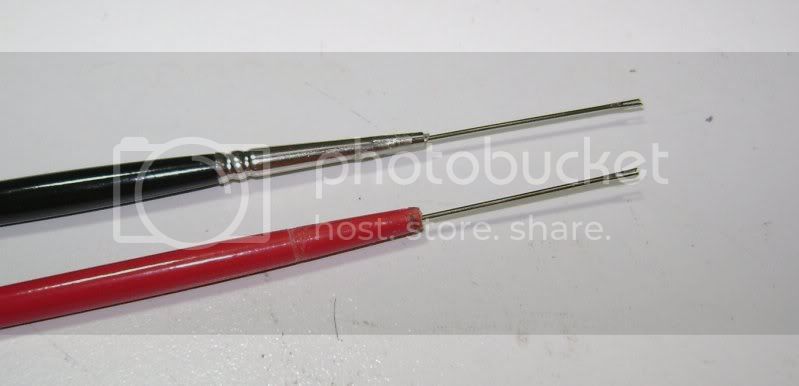

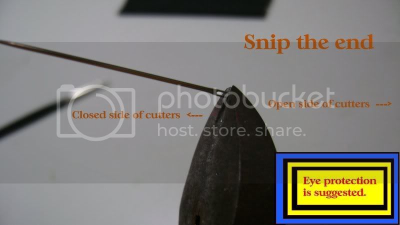

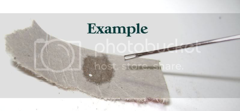

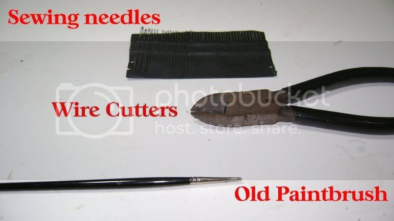

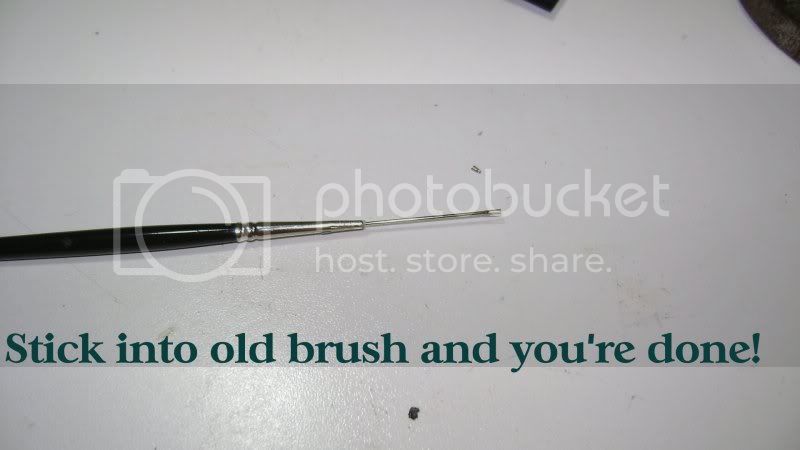

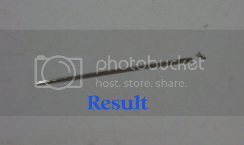

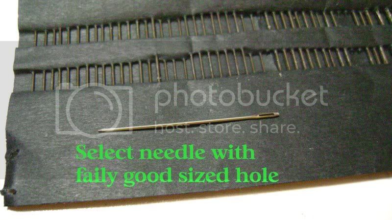

Ferris928 New Member Joined May 7, 2009 Messages 623 Aug 12, 2010 #1 I got board so I thought i'd do a tool post. Here's how to make a cheep and affordable glue applicator. Cheers!

Grendels Active Member Joined Nov 24, 2009 Messages 9,092 Aug 12, 2010 #3 I was looking for exactly something like this a week ago. Great tip.
Elm City Hobbies Active Member Joined May 7, 2009 Messages 3,239 Aug 12, 2010 #4 This is the much more economical version of the tool that Micro-Mark sells Ferris' solution is much better and cheaper than the $7 these guys want for the same thing.

Dano1945 New Member Joined Jul 23, 2010 Messages 80 Aug 12, 2010 #5 Great idea. "Straight to the point". ;D
DreamKnight Active Member Joined Dec 8, 2009 Messages 1,160 Aug 14, 2010 #7 Ferris828 said: I got board so I thought i'd do a tool post. Here's how to make a cheep and affordable glue applicator. Cheers! Click to expand... Wow, very very nice. I need to make one of these. Mind if I make this to an article for the resources section. Mind if I do that Ferris?

JMac cut. glue. paint. repeat. Joined May 24, 2009 Messages 2,812 Aug 14, 2010 #8 Wow I just tried this Ferris, work great - beats the sharpened wooden toothpick I was using. Thanks for the tip.

Ferris928 New Member Joined May 7, 2009 Messages 623 Aug 15, 2010 #9 @DreamKnight: Sounds good to me! @JMac: You're welcome!
