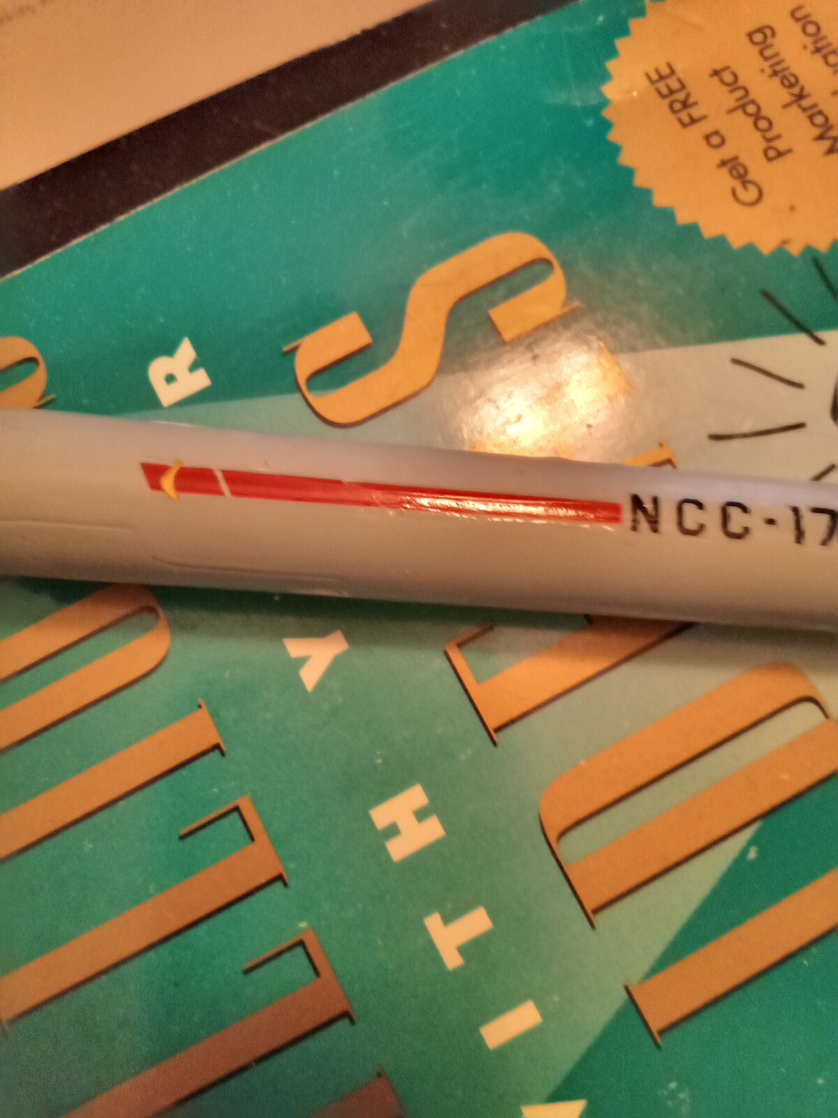

UPDATE: I have found a builder on YouTube that built the most exact replica of the production Enterprise I've ever seen. He used Polar Lights decals on this and I'm shocked to see how well his turned out. I'm wondering if my gloss coat isn't heavy enough so I have built one nacelle out of the box of spare parts I've built up now. I seam puttied and sanded and painted the nacelle. I put four coats of clearcote on. I used the collection of extra PL decals I have and put the nacelle registry number and stripe on to see how it goes.
So far, I'm on like coat 10 of Micro Sol and the entire upper edge of the decal where NCC-1701 is curling away from the model surface more and more severely the more MicroSol I apply.
The builder in the video indicated in his decal application video that it took a lot of work to get the decals to look good but did not give any info as to how many coats etc. does the trick. So I'm going to keep coating this thing until it dissolves if necessary to find out.
Regardless, this is RIDICULOUS that these decals are so hard to work with. It's the damn film. It's as thick as plastic wrap. In comparison, the decals from PNT Models at Federation.com are much much thinner and react IMMEDIATELY to MicroSet/Sol treatments.
More to follow....

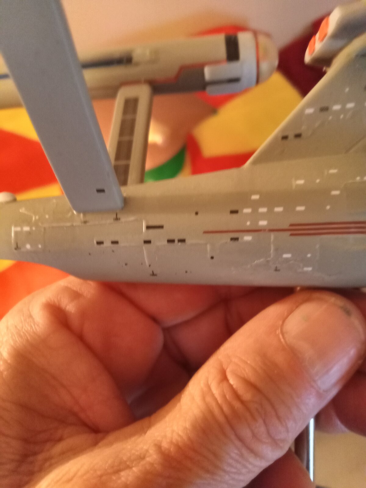

17:42 CST. Okay. I've spent the WHOLE DAY saturation bombing this decal experiment with MicroSol and Walthers Solvaset while using a damp paper towel to constantly press these decals into the surface of the nacelle. I don't know how many coats I've applied now - 20 at least and here are the results:
So that's as good as I could get it. And that isn't good enough.
I don't know brother, if the decal is down as far as it can go, and it looks like it is, that is all you can expect. How is this impacting the lights? Am I just not getting it? Would not be the first or the last time!

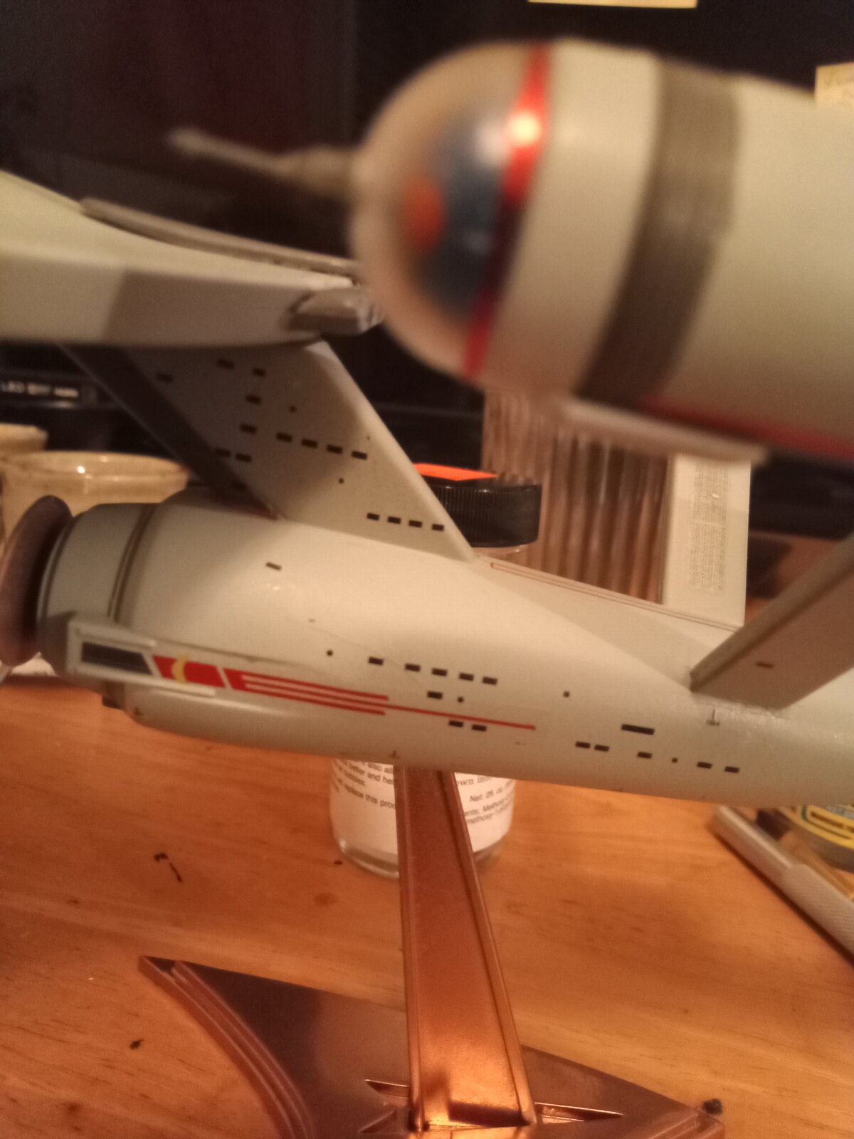

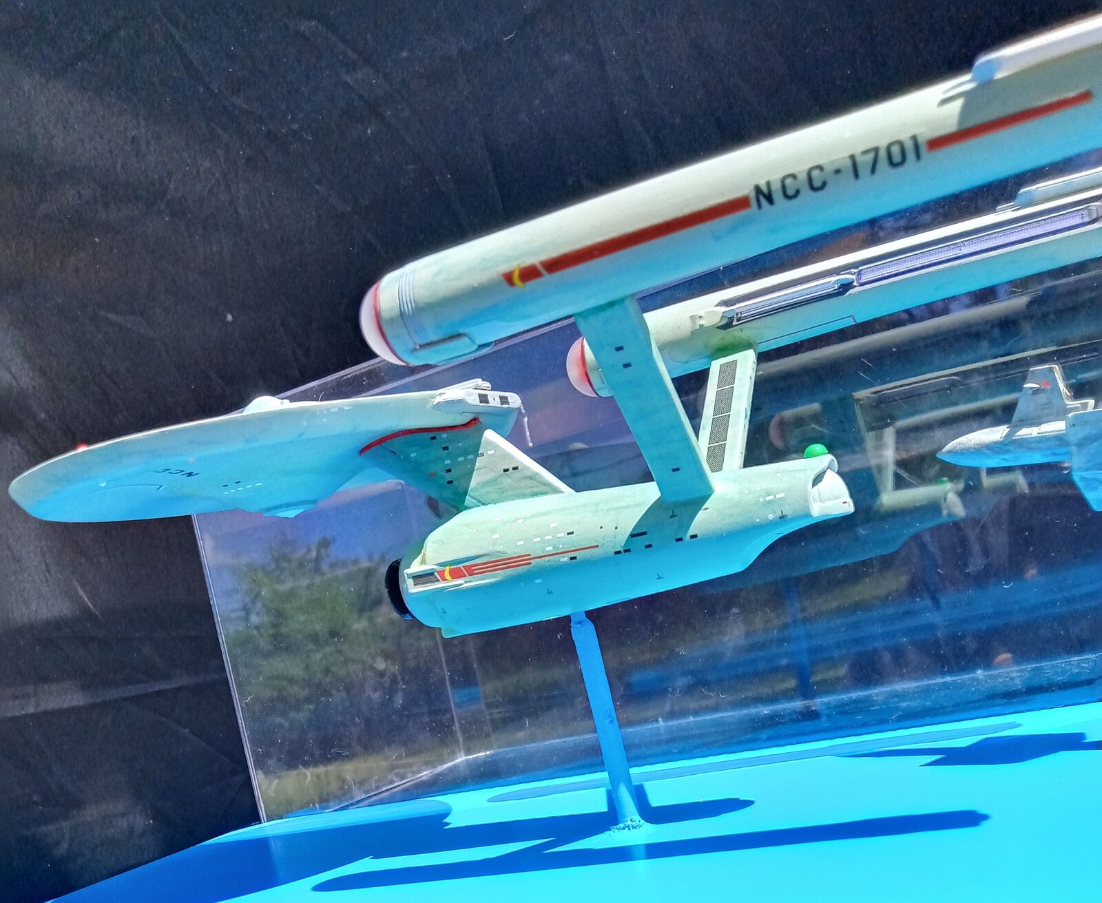

It's not as far as it can go. The very edge along the top and bottom, whole length the edge is slightly raised and won't relax. Here is a picture of the decals I used that are aftermarket:
IMG_20250216_222025_HDR.jpgThese are the aftermarket decals made in house by Federation Models. No comparison. These do what they're suppose to do with setting solution and I didn't spend a whole day just getting one decal to look marginal at best.
Oh and that out of alignment window...it tore in the application and I repositioned it but slipped out of alignment before I noticed it. I'm going to paint over it, use my window drilling templates to sketch out a new one and paint it in.

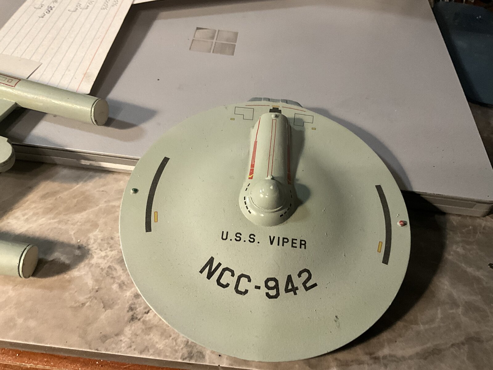

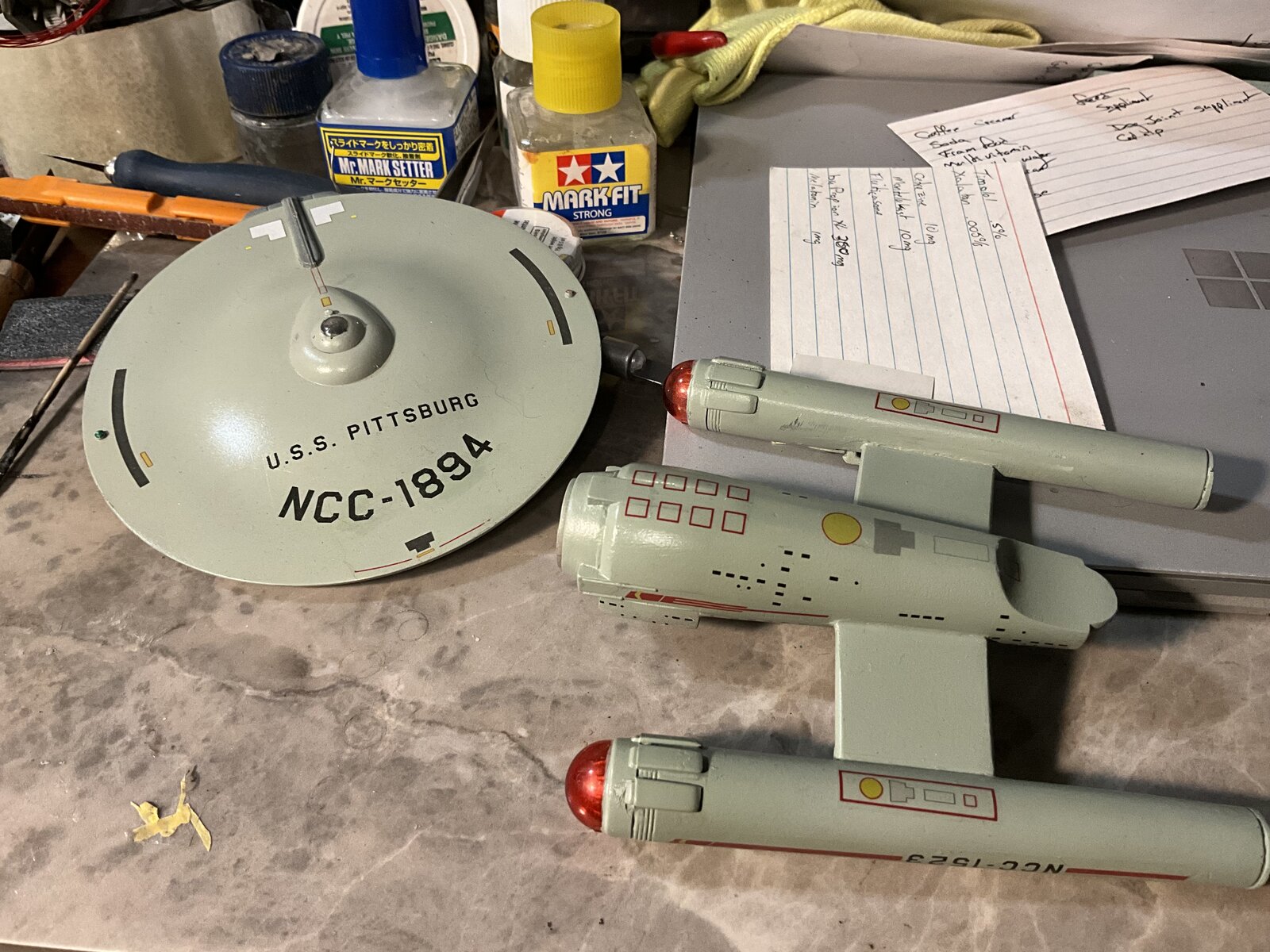

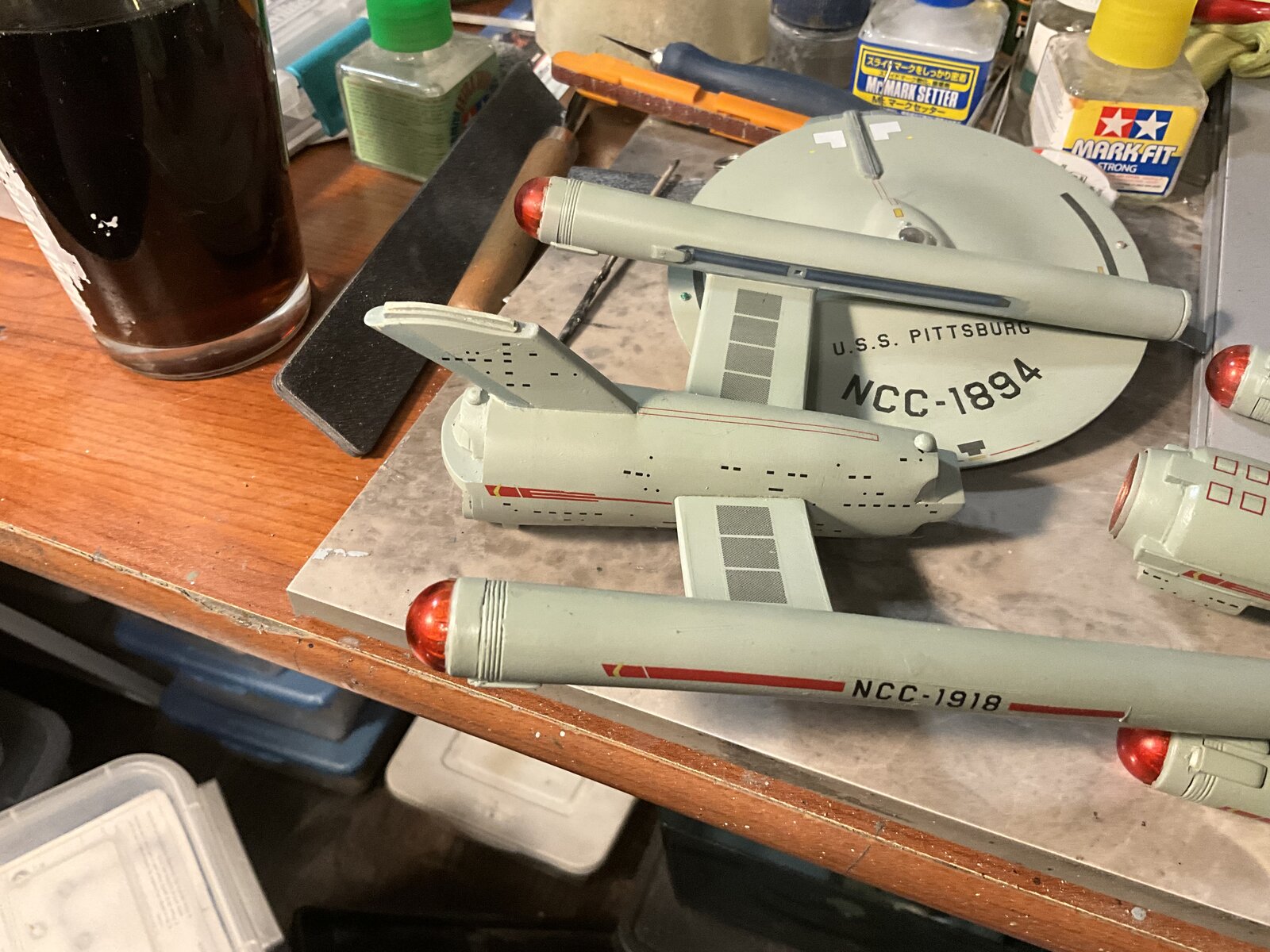

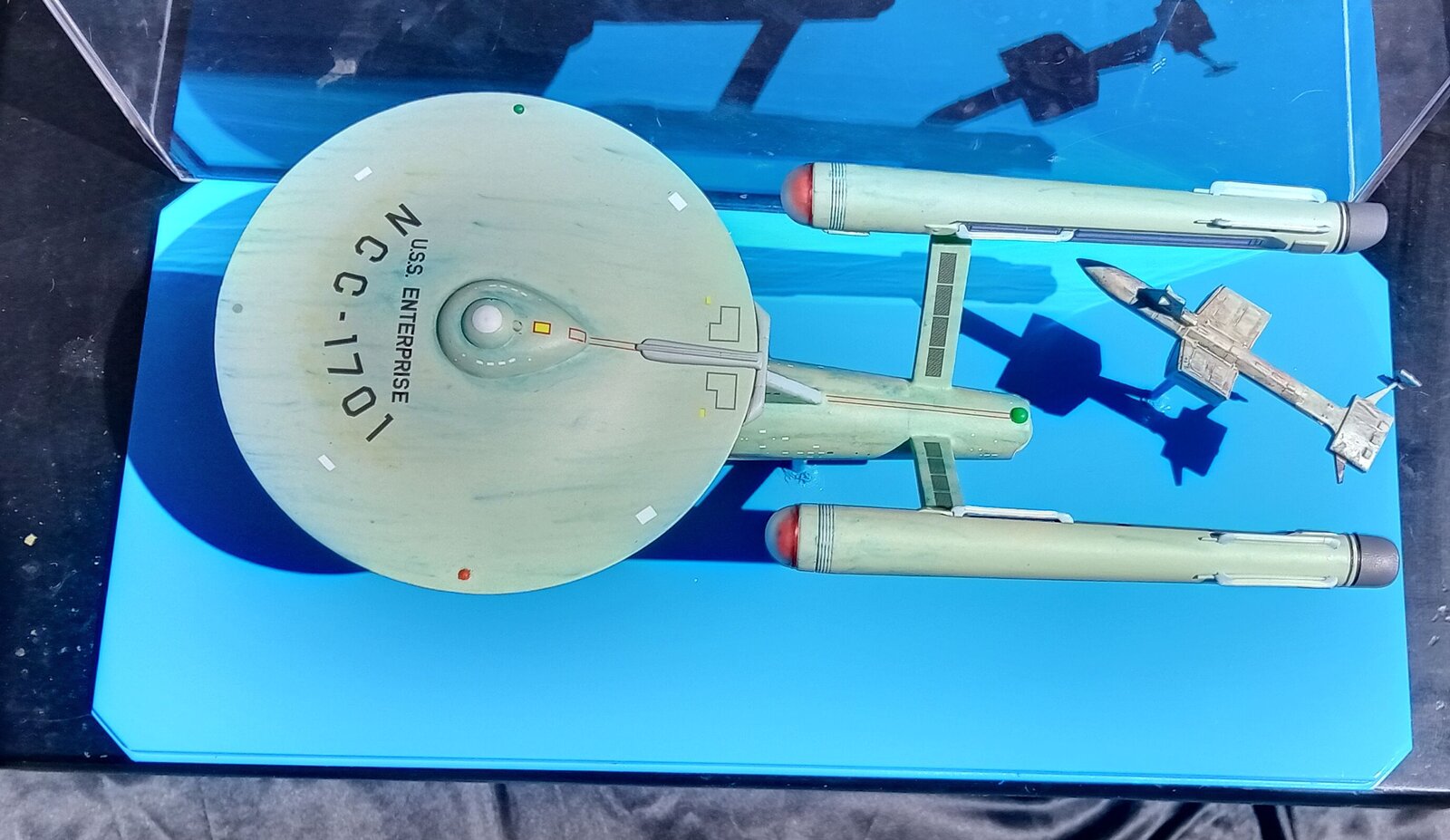

Here's my current project. These are custom decals but I don't have the makers contact info.
Wow. That's awesome. So you don't use any setting solution at all? I'd like to get insight in how you modify kits like that. I'm retired now, I've got lots of model kits still in the box I've been lugging around for twenty years and now I'm getting back into the hobby again. Are those the standard 1/1000 nacelles? They look like they came from a bigger scale kit-the AMT maybe? Also, this style you are building looks very much like the New Jersey class heavy battlecruiser from Star Fleet Battles. That is definitely something on my punch list. Making a New Jersey class out of a Constitution class.

Thank you for the updates and tips! And thanks for the decal links. I did find the Etsy decals in a search and bookmarked it. Good to know they're top notch. I'll be ordering several sets soon. It looks like you're using a gray-green shade of paint. I've been using AS-29 Gray Green cans. It's too dark so my next step is to cut it with white 50/50. That should lighten the green down to the subtle shade it was on the shooting miniature. The second pilot I just did I painted blue gray because the first two pilot ships were blue gray, the production went to gray green.

The modifications were made using parts from here, http://www.modular-models.com/
I use setting solutions. Most of the time I use good ol' micro sol and micro set. It all depends on the subject and the decals. Most thinner decals lay great, while thicker or older ones need lots of help. I'm also leaving more excess carrier film when trimming super thin decals. These don't leave much room for play and edge curl is an issue.
For those builds, they are very much based on WWII US naval classes. I also went by the class names used by Modular models for his designs and picked names that for these categories.
