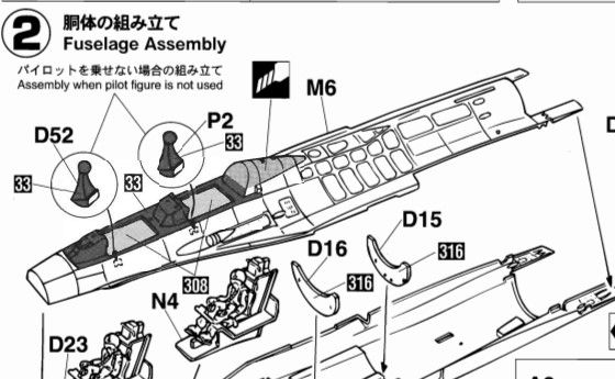

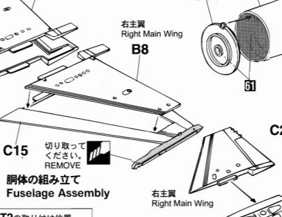

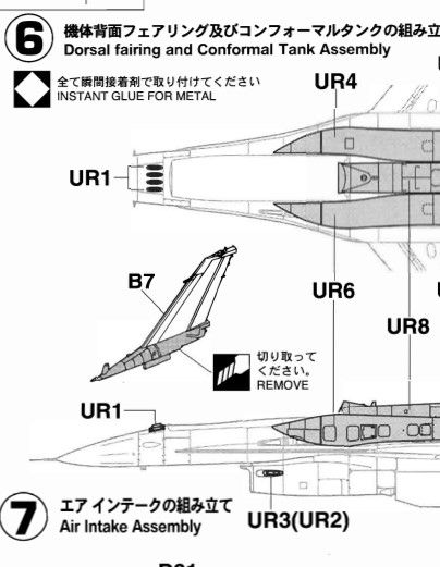

While finishing up the Mig-23 and 29 kits, I started studing the instructions for the F-16D (Block 52 Plus) Fighting Falcon 'Hellenic Air Force' kit
I noticed I have to cut & replace in three areas .... wing tip, vertical stabilizer and rear/back of the cockpit
The wing tip and vertical stabilizer are straight lines and will be no problem, I've done the same on a few armored kits, but cutting something like the rear/back of the cockpit is new to me
What is the best or easiest way to remove it
Screenshot 2023-02-13 155501.jpgScreenshot 2023-02-13 155622.jpgScreenshot 2023-02-13 155415.jpg
Are you asking the best method to cut that curve ?
I would use a thin kerf blade on a coping saw .
Actually , I'd use my ultrasonic knife but I know that's not a common tool .
Scoring with a knife tip, or a fine needle, too, and using something like Dymo tape as a scribing guide.
Someone from another forum said chain drilling will work
When I start on the F-16 I will check it out
