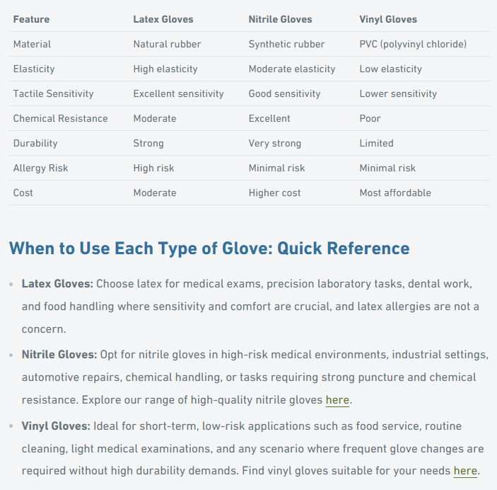

I'd advise against latex gloves from a health and safety point of view. They can cause serious skin reactions or allergies. Latex is a sensitiser.
I speak from experience.
Blue or black, I think they are the same. If they fit loosely there's a small loss of tactile feel, but since they are just for holding the larger bits it is not a problem for me. I use them when cutting/sanding/grinding on resin too, both hands in that case. I get them from the auto-parts store, cheapest I have found, and using one at a time doubles the life of the box.
I'm not allergic to latex, lots of people are, but I do not think they are as effective against the stronger chemicals as nitrile, thinking acetone and lacquer thinner. I could be wrong about that, never claimed chemistry as a skill.

I find using Nitrile gloves while airbrushing is essential. Like Jakko, I use one glove on the non-airbrush holding hand while painting. There's a lot of concern about inhaling paint and thinner vapors but these chemicals can be absorbed through the skin too. Nitrile gloves are also non-allergic (hypoallergenic). I also use these gloves for handling model parts when I don't want fingerprints on the model.
I use the blue 5 mil Nitrile gloves from Harbor Freight for $11.99 per box. These come in boxes of 100 in sizes small, medium, large, XL and XXL. I use the smallest size that I can comfortably get my hand into so that they fit snuggly at the fingertips. I've found that small details can be felt through these gloves although the 3 mil white Nitrile gloves that Harbor Freight used to sell provide the best touch sensitivity.
I do use latex gloves :) I used to have blue nitrile ones, until they ran out, but never did feel like they fit overly well whereas latex ones fit better. So I bought more latex ones last year, on the basis that I need them only a couple of times a year so I'm not worried about developing an allergy to them.
