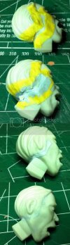

While dealing with the heads, I'm trying to use as little filler as possible to avoid a lot of sanding. I really dont want to have to try to re-sculpt any detail. So im just using a lot of plastic cement, gluing, clamping, re-gluing, and re-clamping..
This is working out pretty good, now I can just scrape away most of the seam, shouldn't need a whole lot of filling and sanding, but we'll see when we get there this thing needs to dry for a while.

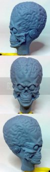

I'm pretty stoked on the Martian head. Its coming out way better than I thought. I took care of most of the seam just by scraping it away with a chisel and then I used MR. Surfacer 1000 to take care of the rest of the gaps. There is one tiny spot that needs a little more attention but its almost ready for paint.
