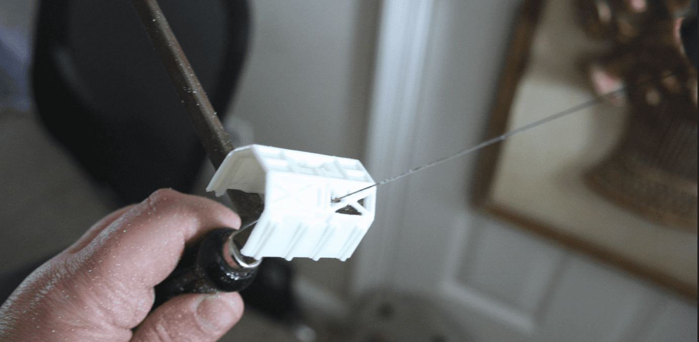

The easiest way would be chain drilling and then filing
Drill a series of tiny holes around the perimeter of the cut-out and then knife/file away the remainder .
You can get sets of jeweler files off Amazon for cheap
