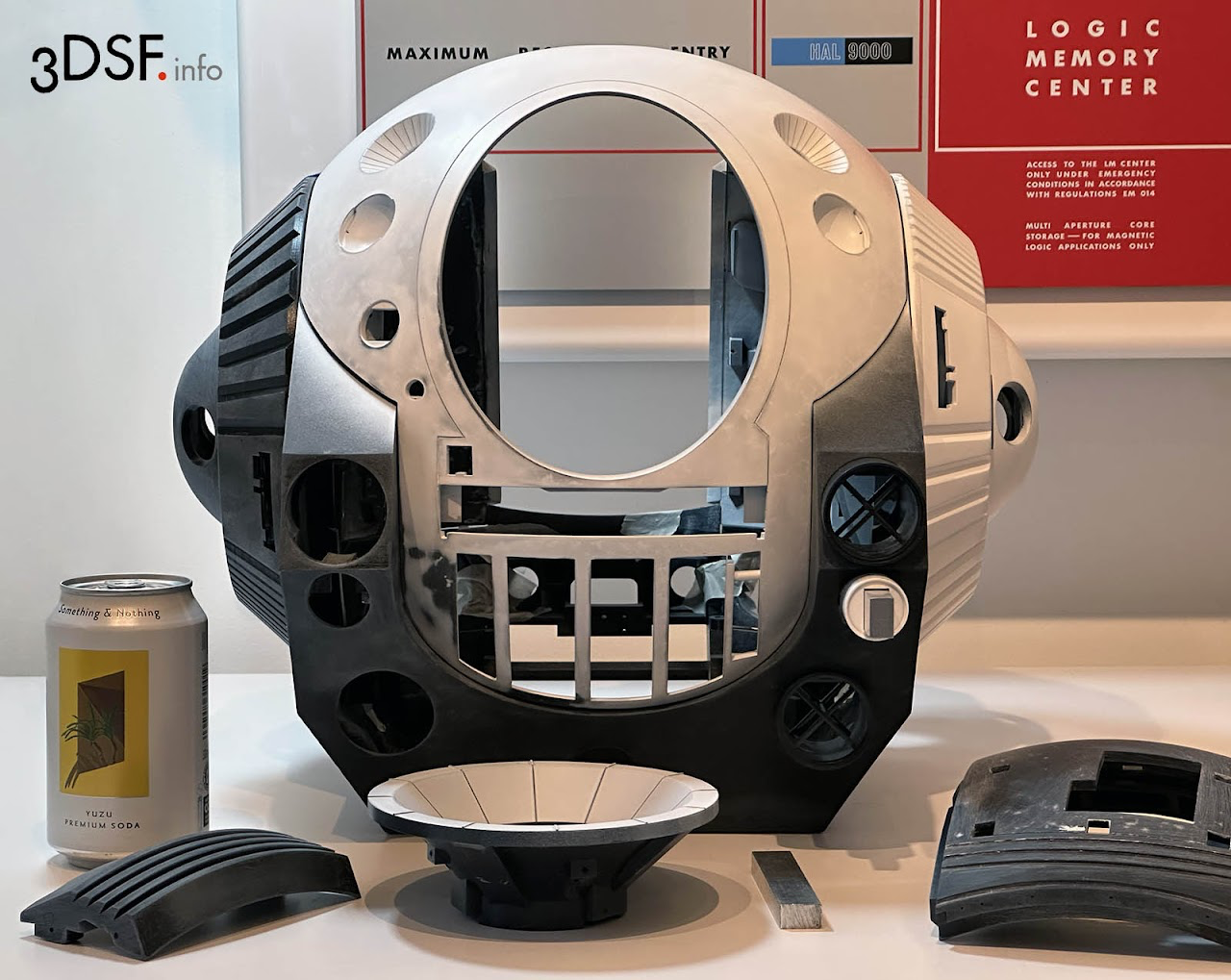

Hi, all! So I've stopped by the site from time to time over the years, but never actually signed up for an account. Finally have. And now I'm announcing a new work in progress that may be of interest: my 1:6 scale model of the EVA (extravehicular activity) pod from Stanley Kubrick's 1968 film, 2001: a Space Odyssey.

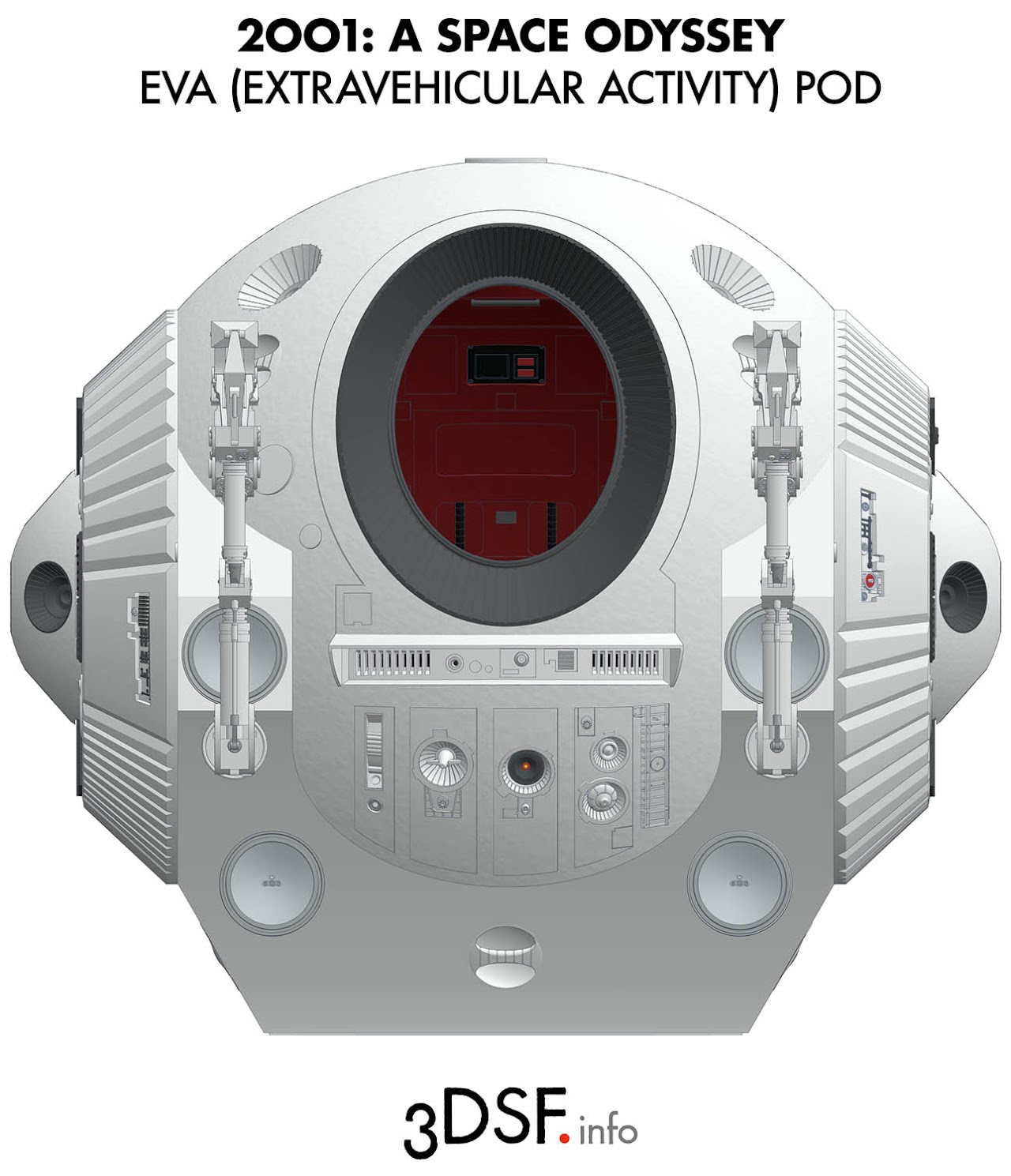

Basically, since late 2020 I've been researching, designing, and now building a superdetailed 1:6 model of the little one-person spacecraft from the movie. The digital model is complete, and I'm working on making it into a physical reality.
(330mL drink can for size)
Only production images, created from 1965 to 1966, were used as references for this model. Almost every detail is present and correct, including many aspects to the pod never correctly reproduced before.
My digital model is mostly 3D printed, and its size matches the main original shooting miniature. That's 13.5 inches tall, or 343mm in modern units.

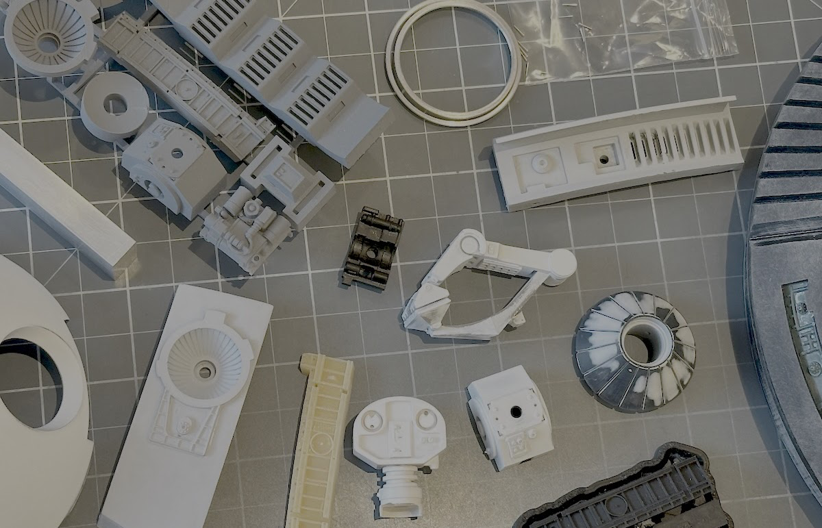

The primary material is 3D-printed industrial resin, reinforced with fibreglass and a lightweight aluminium subframe. Smaller parts mostly use lighter-weight resins capable of printing to higher levels of detail. Other materials include custom-machined aluminium, sintered PA 12 printed nylon, brass and aluminium tubing, custom-etched sheet metal, glass watch covers, miniature glass optical lenses, neodymium magnets, PETG sheet plastic, nylon and styrene posts, and sheet styrene.
The electronics consist of four ESP32-S3 microcontrollers driving high-resolution animated displays, and secondary microcontrollers driving arrays of smart LEDs. Paint is primarily airbrushed acrylic with a bit of enamel.

Note that this build is a one-off personal project. Regrettably I have no plans to make a kit or digital files available. Sorry about that. I'd be happy to answer any questions about it, though!
* For varying values of "ultimate."
I was about to ask if you planning to sell the files, then read the last bit. I guess there's so much more to what you are building, electronics and metal.
Just hoping you make frequent updates, I'd love to see this become reality!
There are many complications involved with rendering this whole thing as a kit or whatever, I'm afraid. And my priority is indeed getting it out the door in a physical form! :) Which will definitely happen - I've put too much crazy work and money into it over the past half decade to abandon it now...

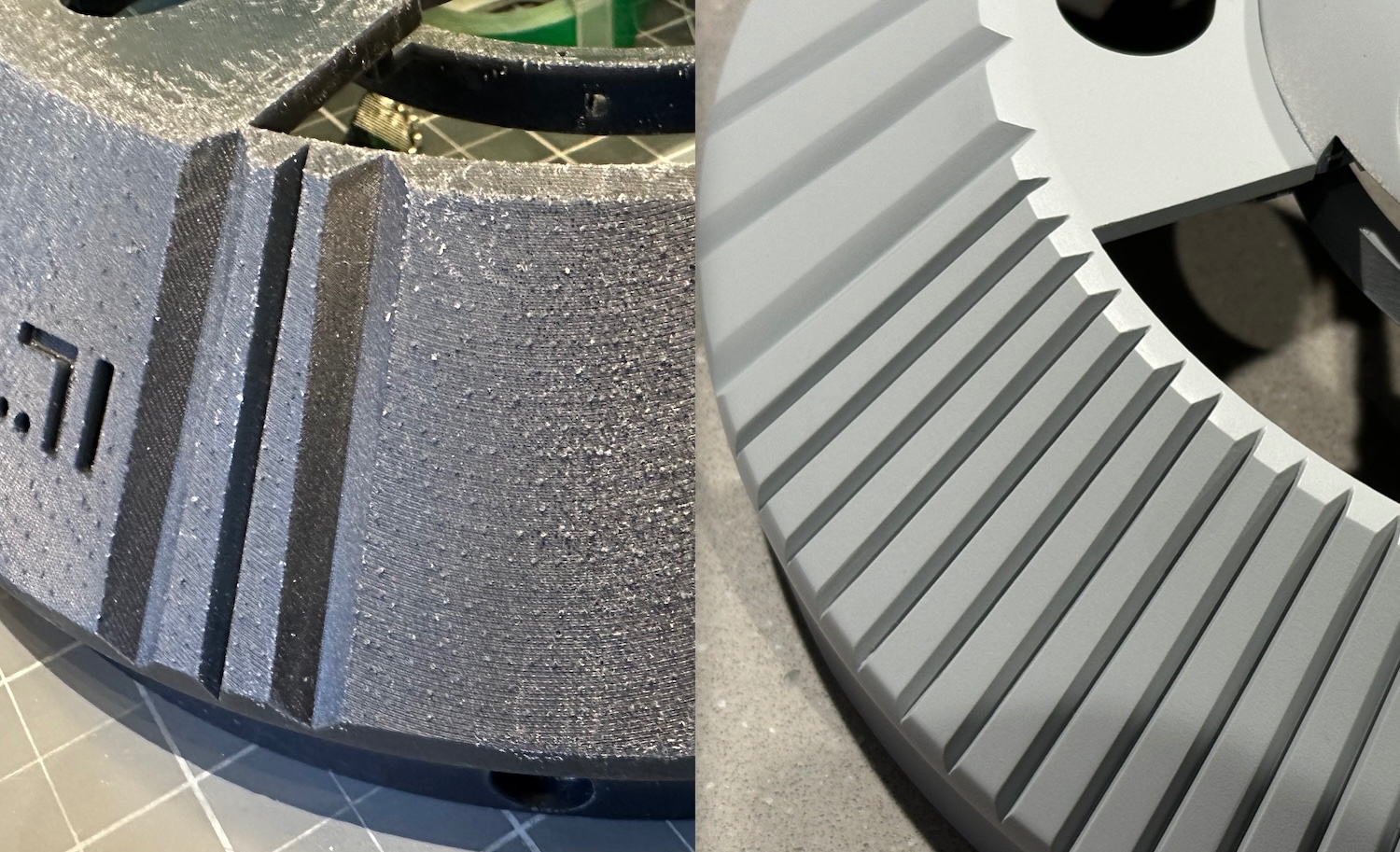

Here's a view of one of the earmuffs. The size of the pod is one of the reasons I had to get the parts printed at an industrial prototype facility. But they had printing orientation issues at the factory, and so I ended up with several parts with a ton of support divots on the sides.
So - before and after. Days of sandpaper and epoxy putty and primer.
