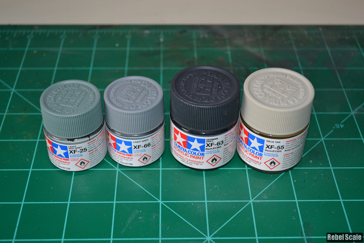

HI MANY THANKS but im not up on these A/B PAINTS SO WOULD YOU SIR MIND POSTIN A PICTURE OF THE PAINTS TO USE IF POSSIBLE
PLEASE
CHRISB
Tamiya X-/XF-series paints:
Do beware that you buy paint with a number that starts with X or XF, though! (X is gloss, XF is matt.) I mention this because Tamiya also has LP-series paint in very similar bottles, but this is lacquer-based and cannot be thinned with their X-20A thinner.
The two smaller bottles on the left hold 10 ml, the larger ones on the right are 23 ml. For anything you need more than a little paint for, get the 23 ml bottles, as you pay a lot less for the paint itself that way.
However, having said that I just tried to find out UK prices, and can only find 10 ml jars at UK web sites, generally for about £2–£2.25 or so each. (For comparison, in Dutch web shops I looked at, 10 ml is around €3.50 to €4 each but 23 ml is €5 to €5.50.)
