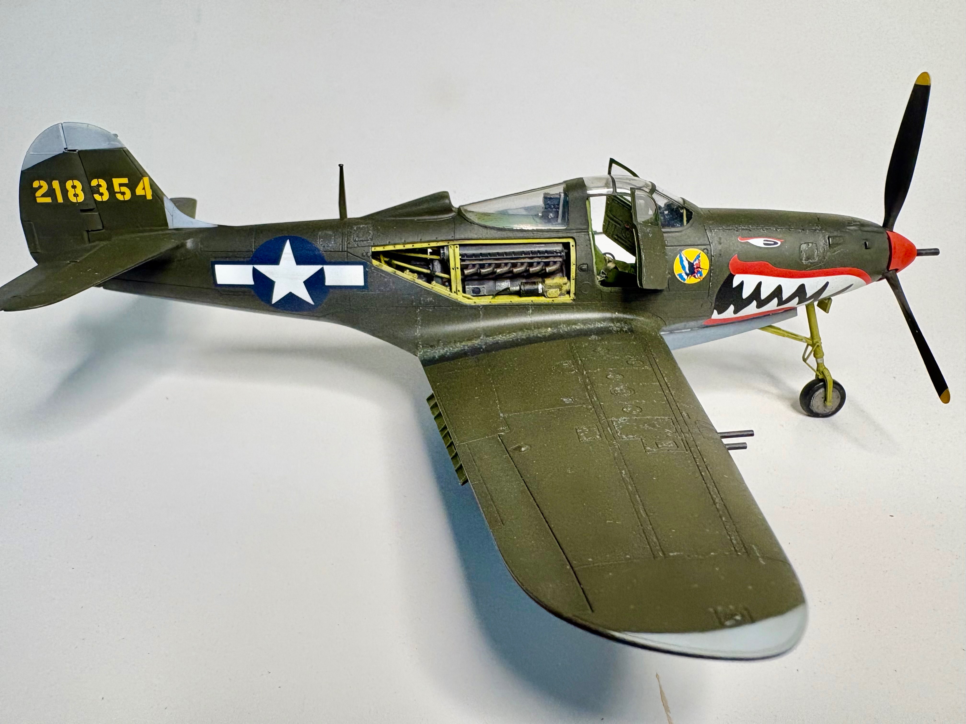

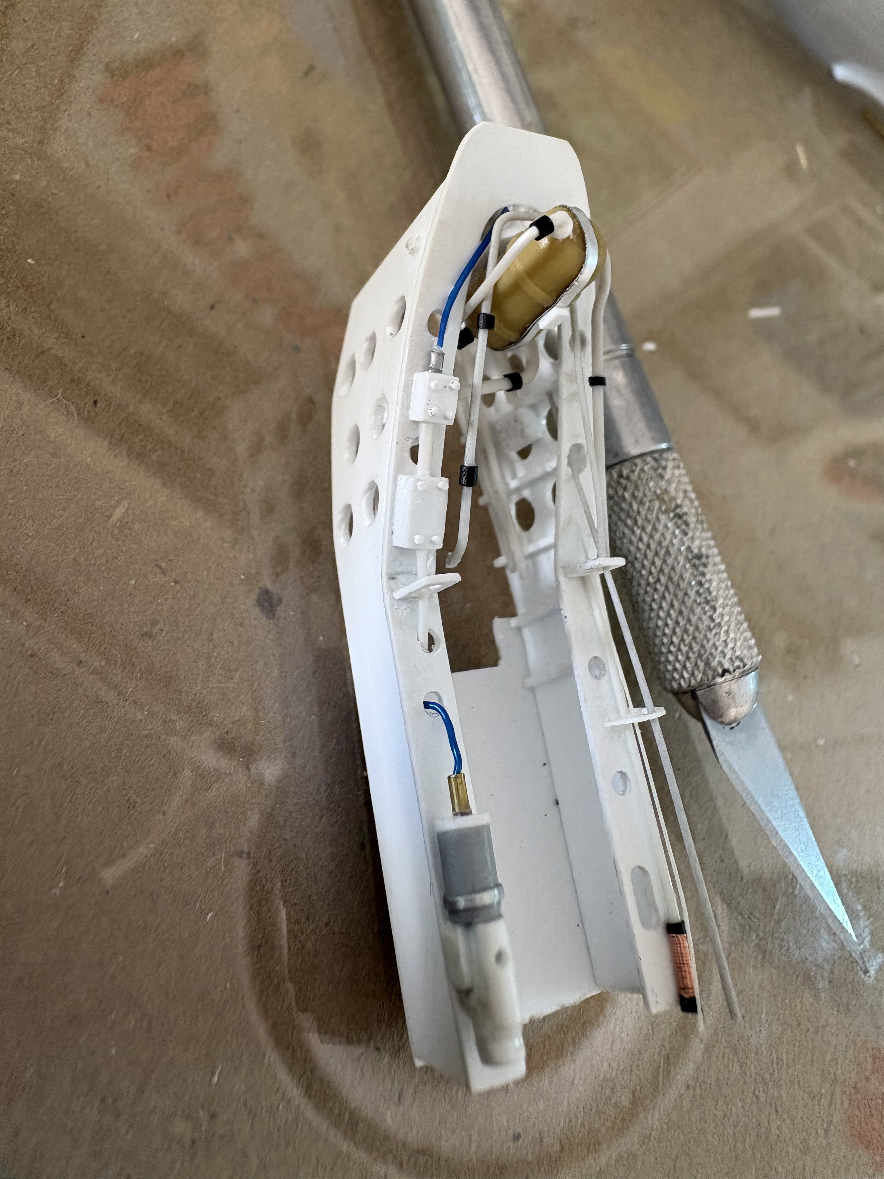

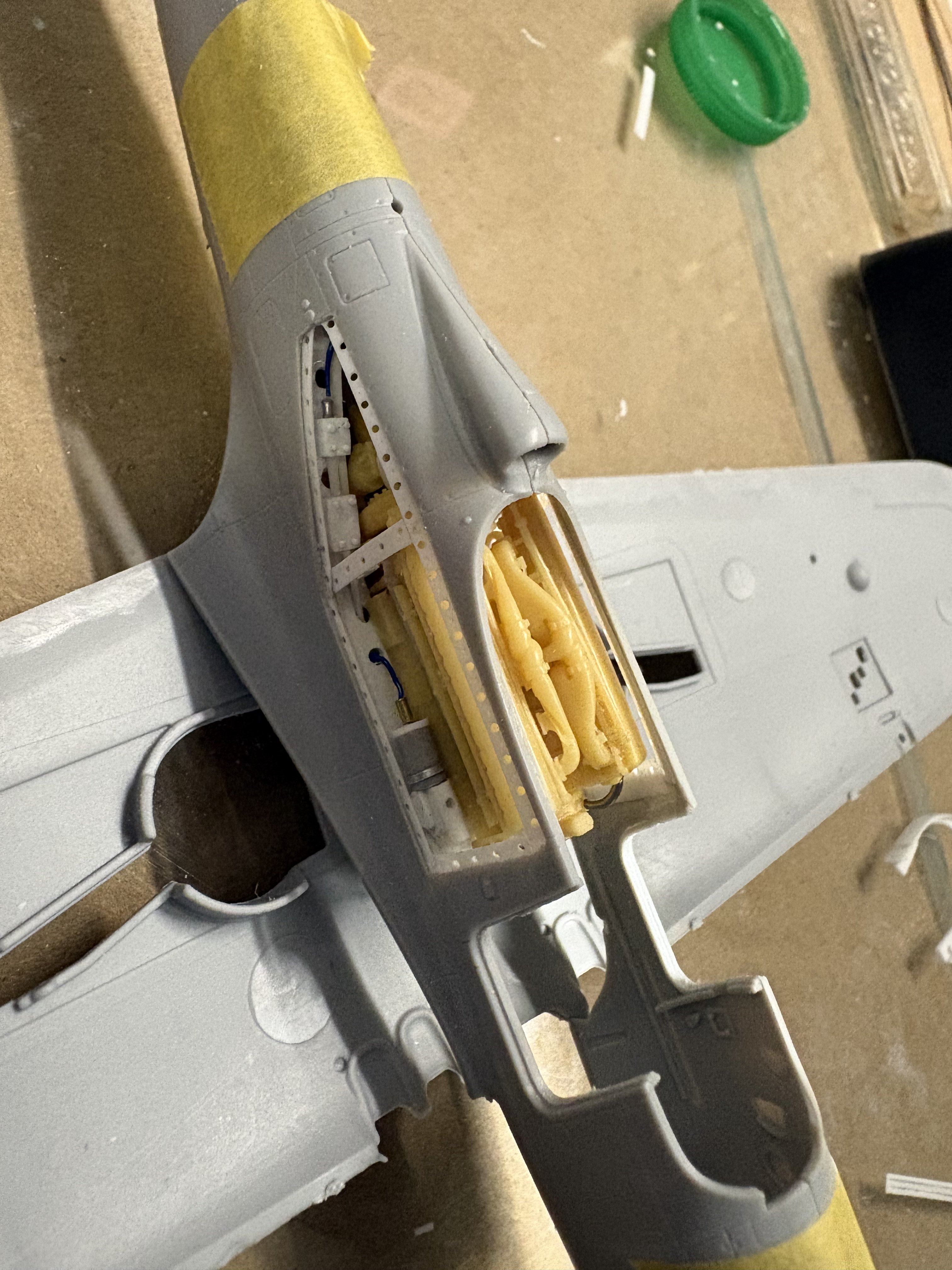

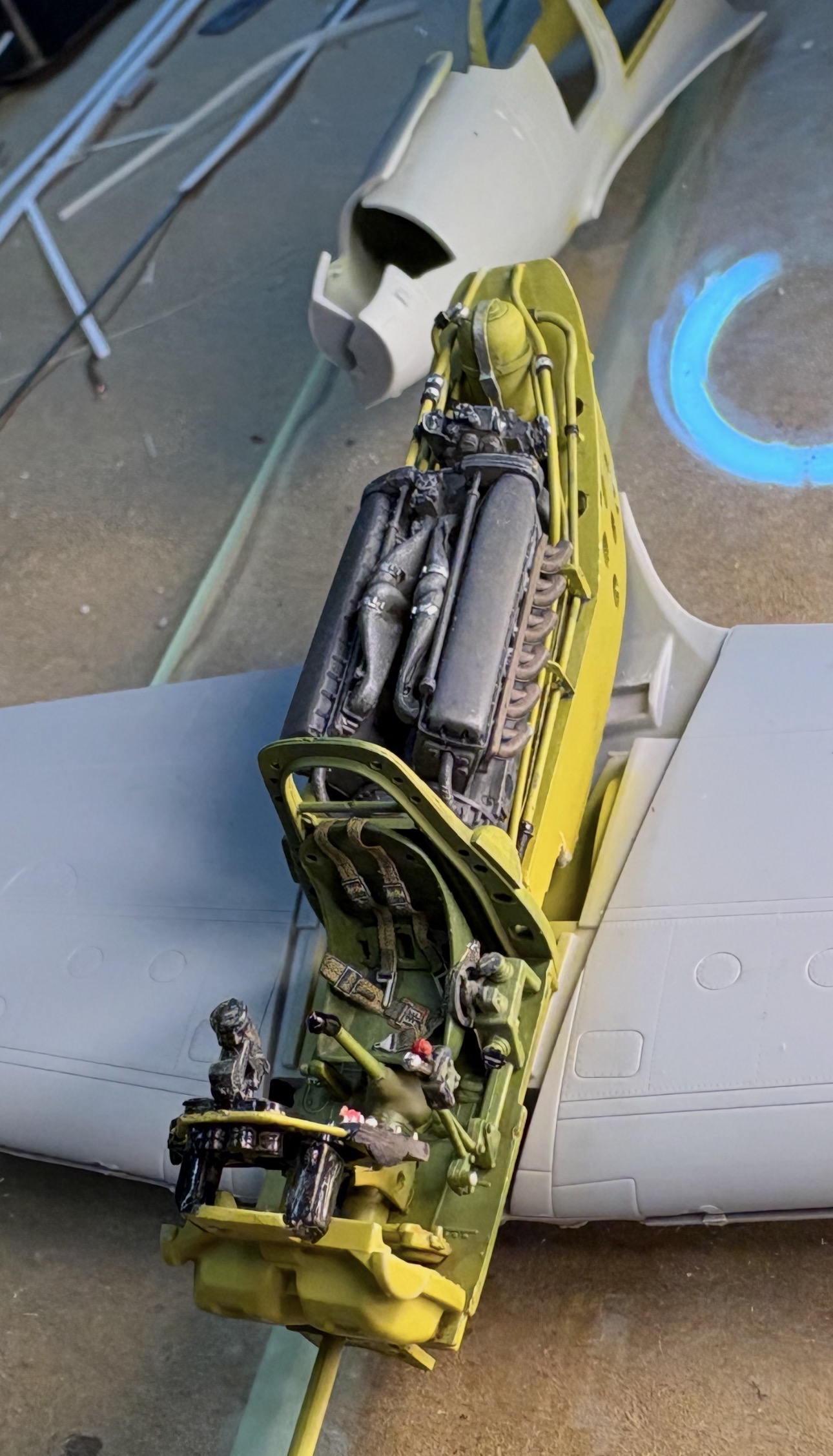

I love the Bell Airacobra. Especially it's unique and clever engineering with its mid-mounted Allison V1710. Yeah, it was weak above 15,000 feet, but ithe Allison engine didn't have the 2-stage supercharger like the Merlin and P&W radials had. It DID have a nose mounted 37mm cannon though, so that made it super cool to me. Plus it's a good looking little fighter plane overall.

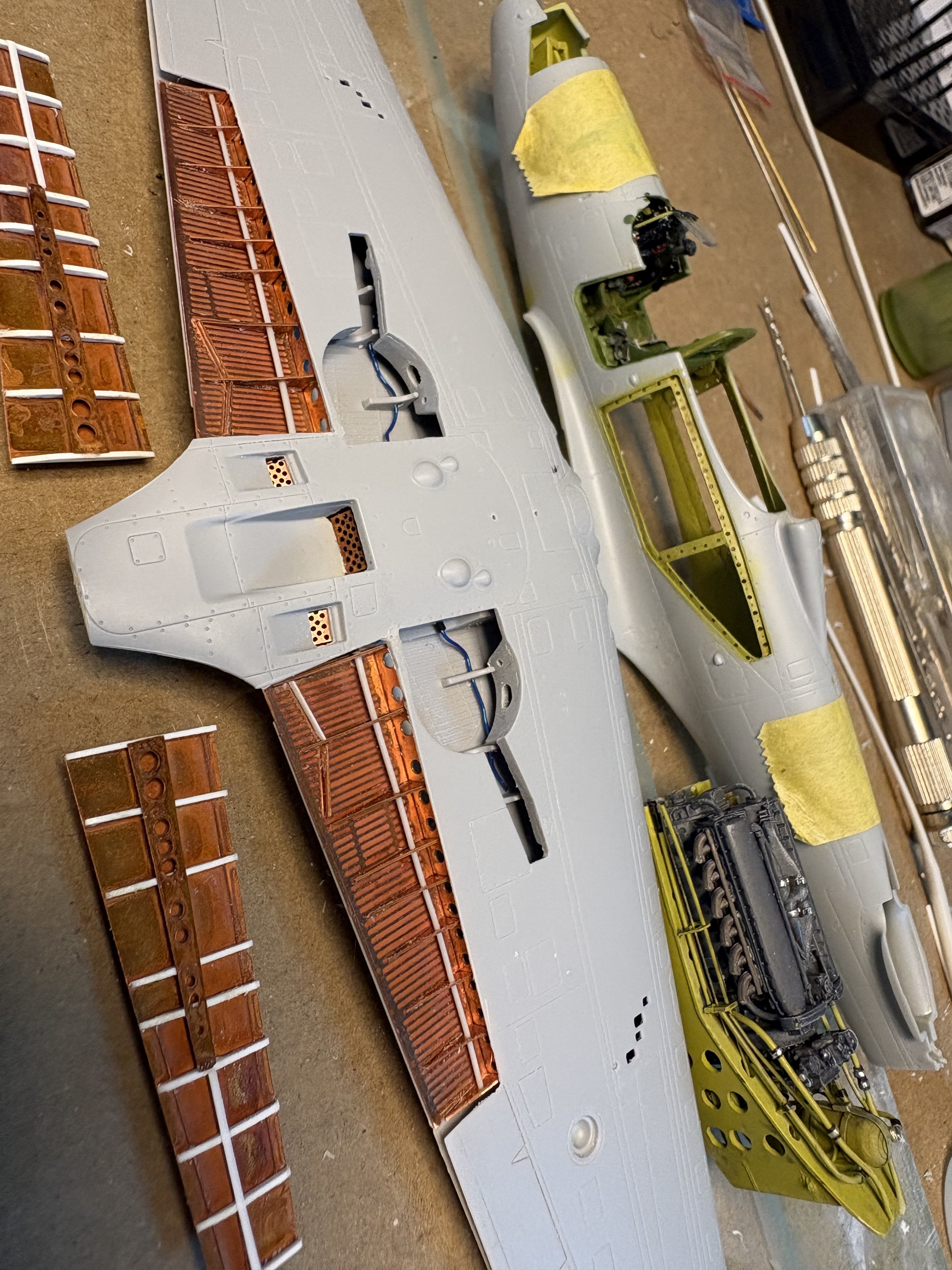

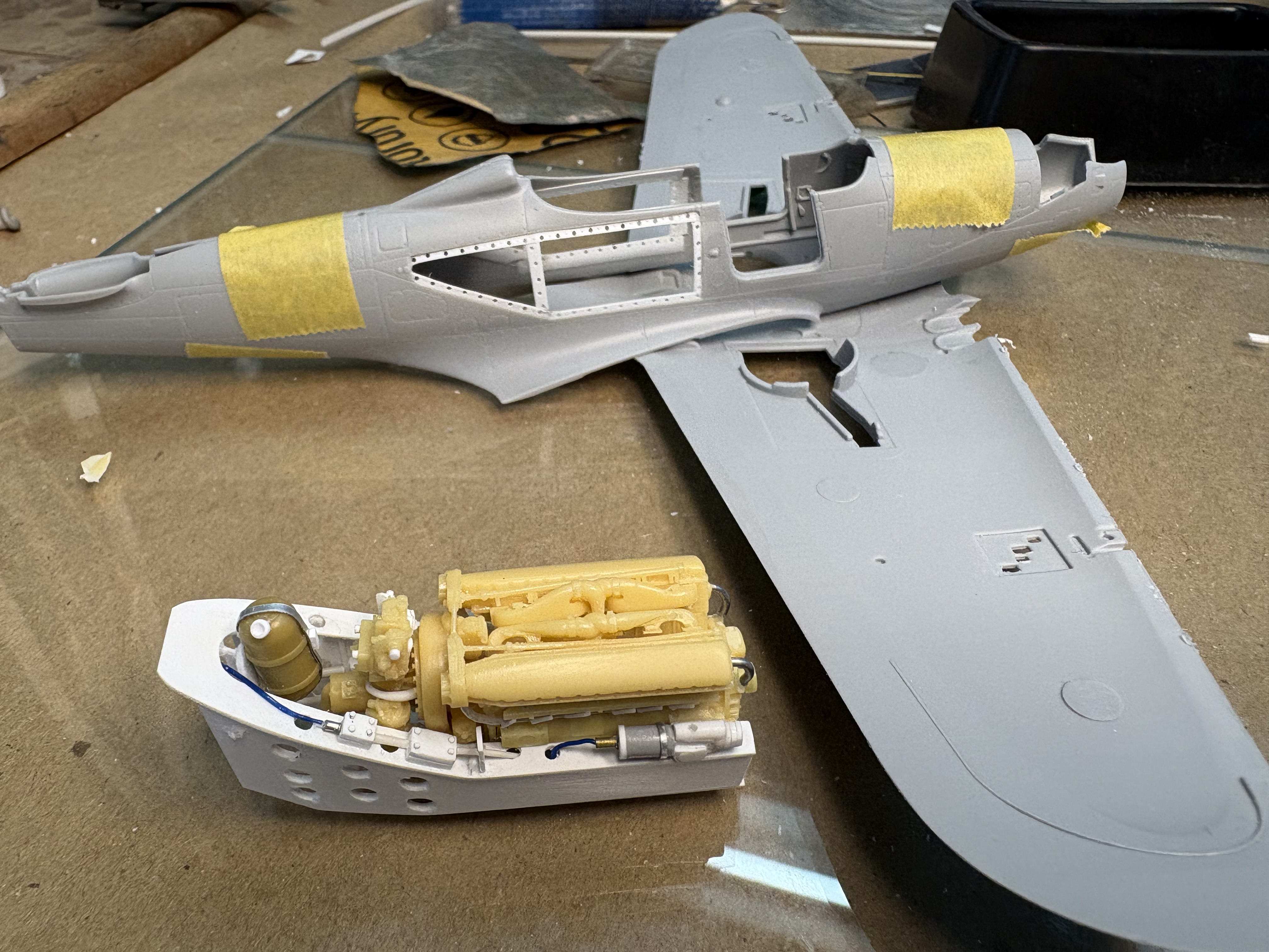

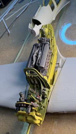

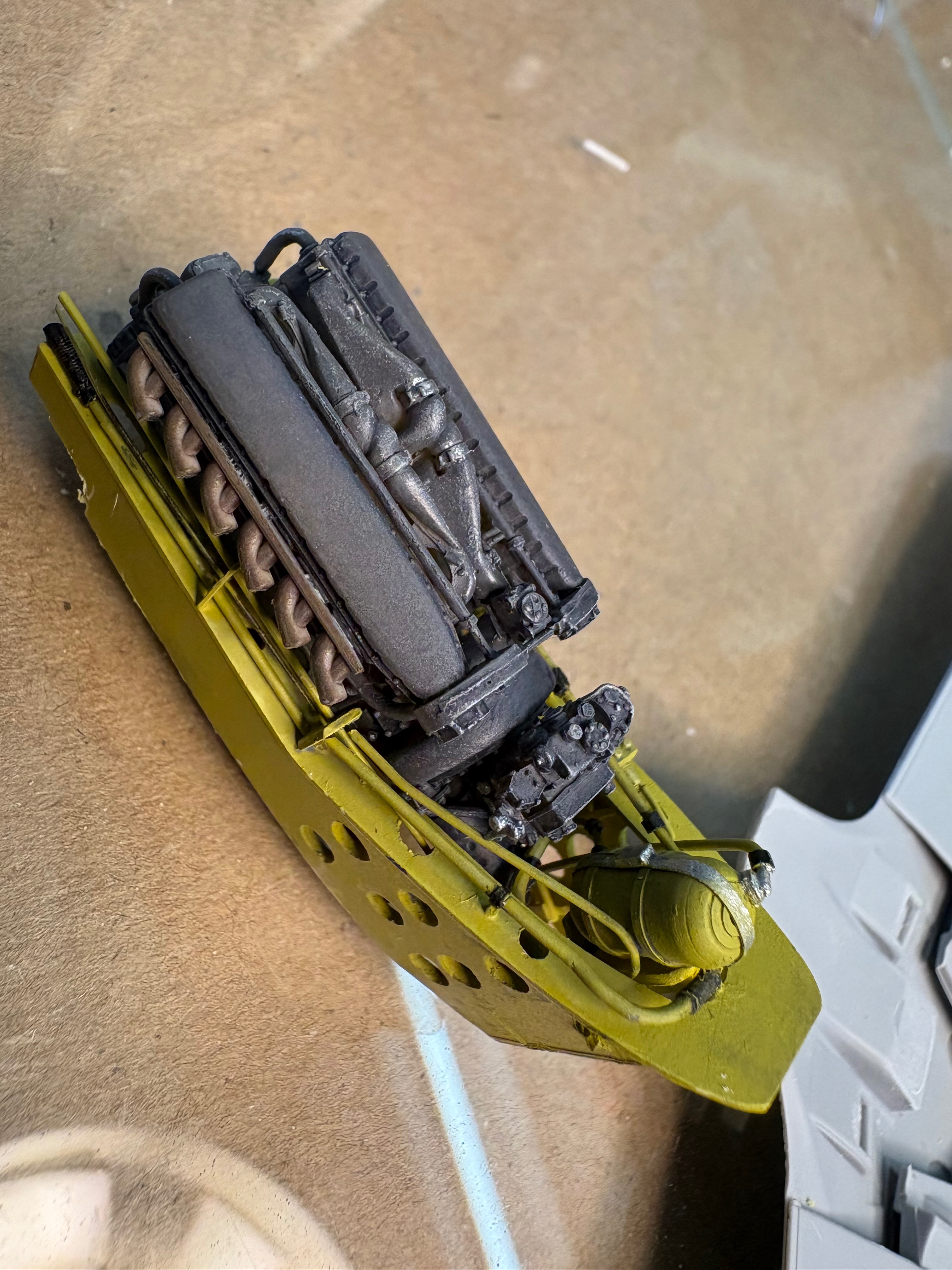

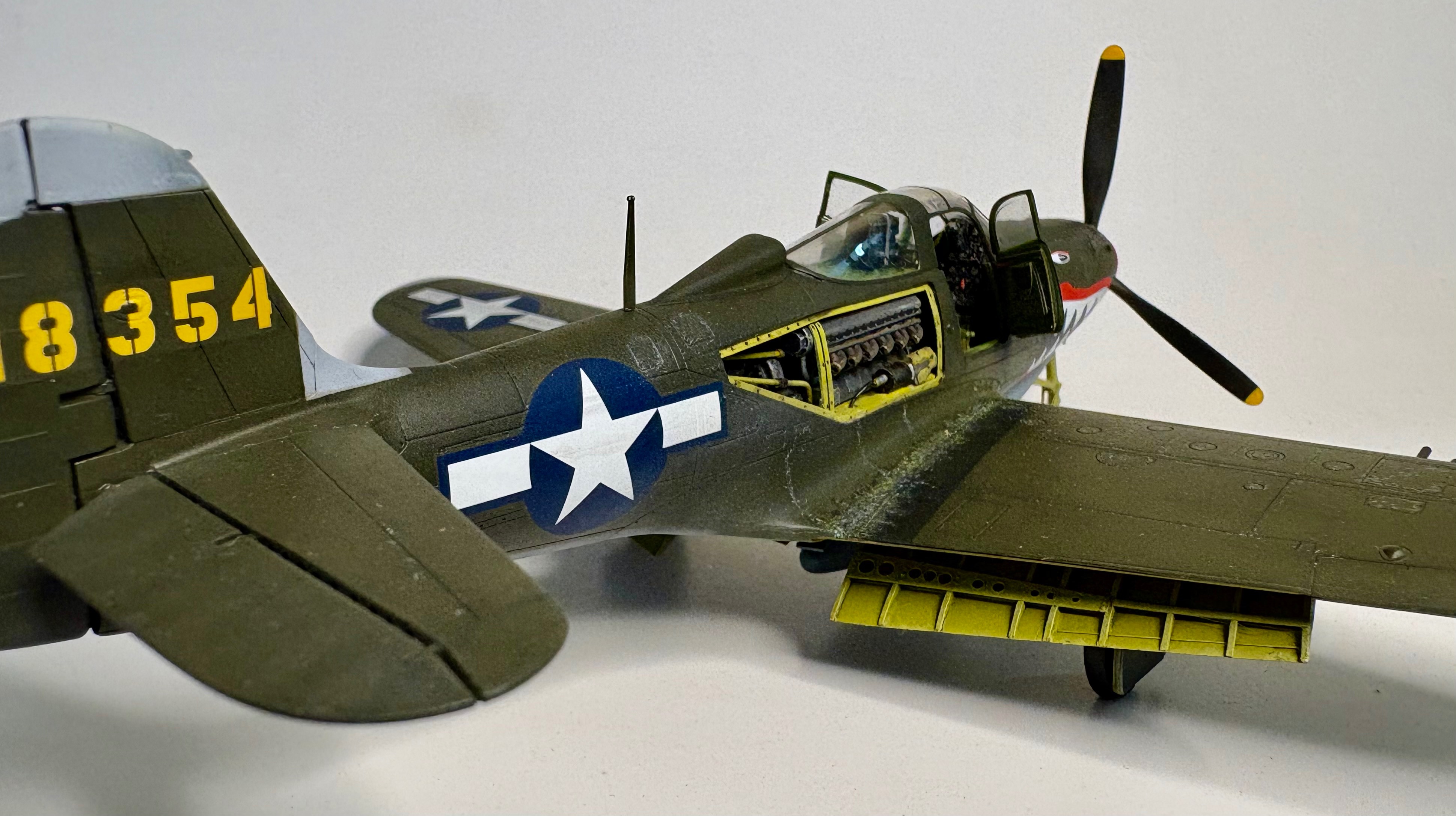

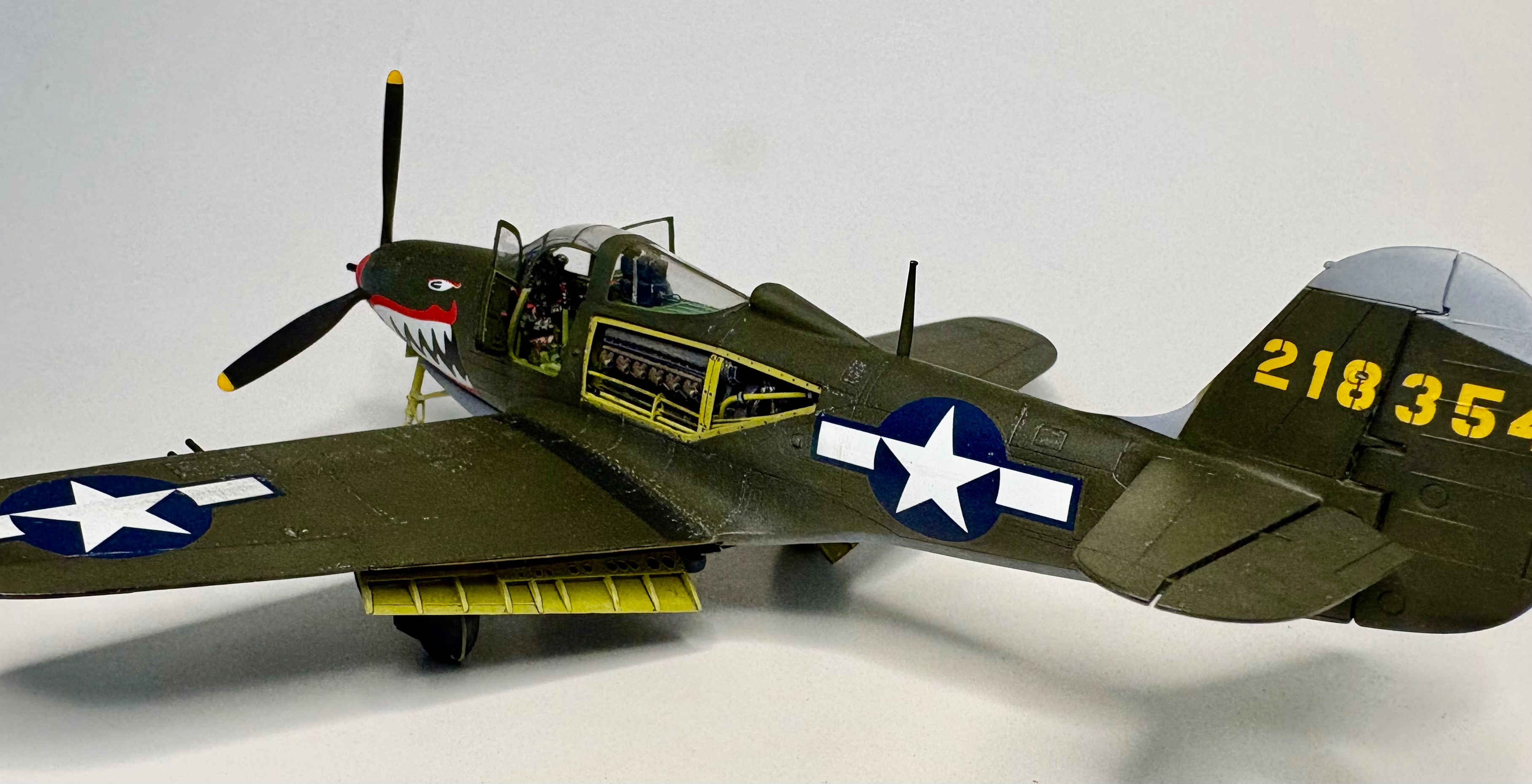

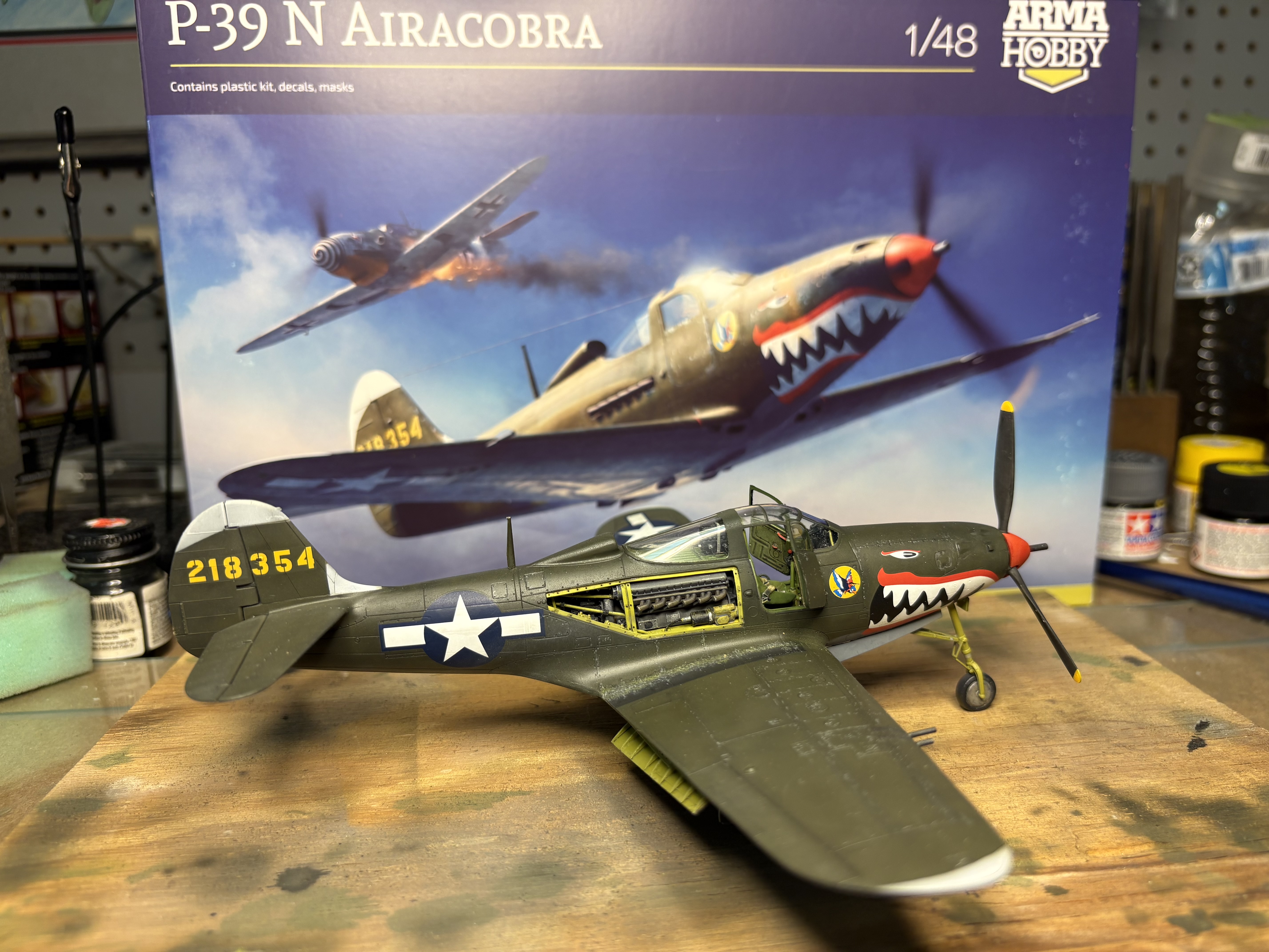

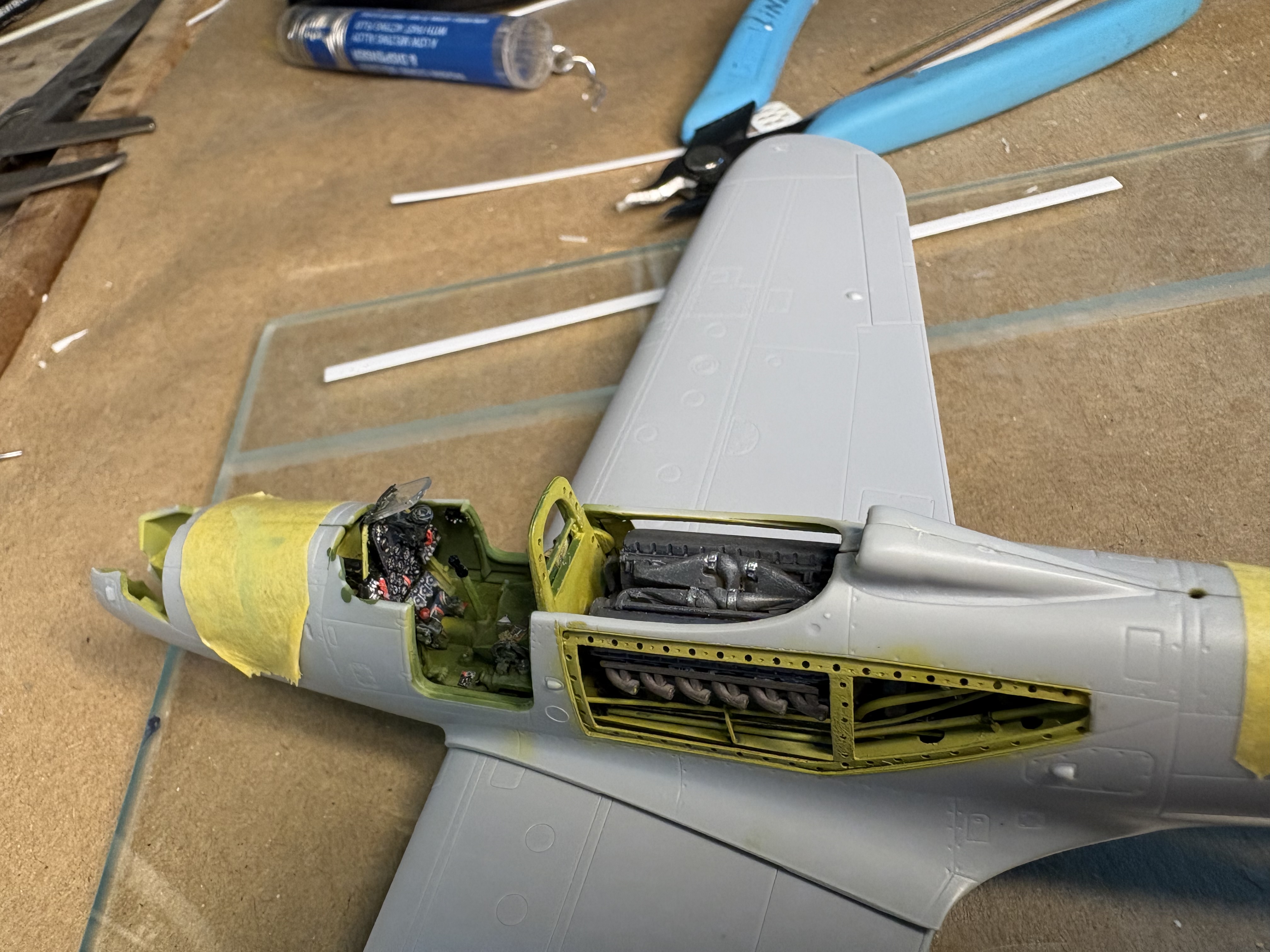

Anyway, I bought the Arma Hobby 1/48 P-39 upon recommendation from AI. I don't hate the kit at all, but it's sure got some problems with fit. Also, since I was adding the Aries aftermarket cast resin engine, I upped the bad fit ante. It took a ton of trial fitting and filing. The Dremel motor got a workout.
Lots of thinning of plastic and locater pin removal got me this far as I'm getting closer to painting.

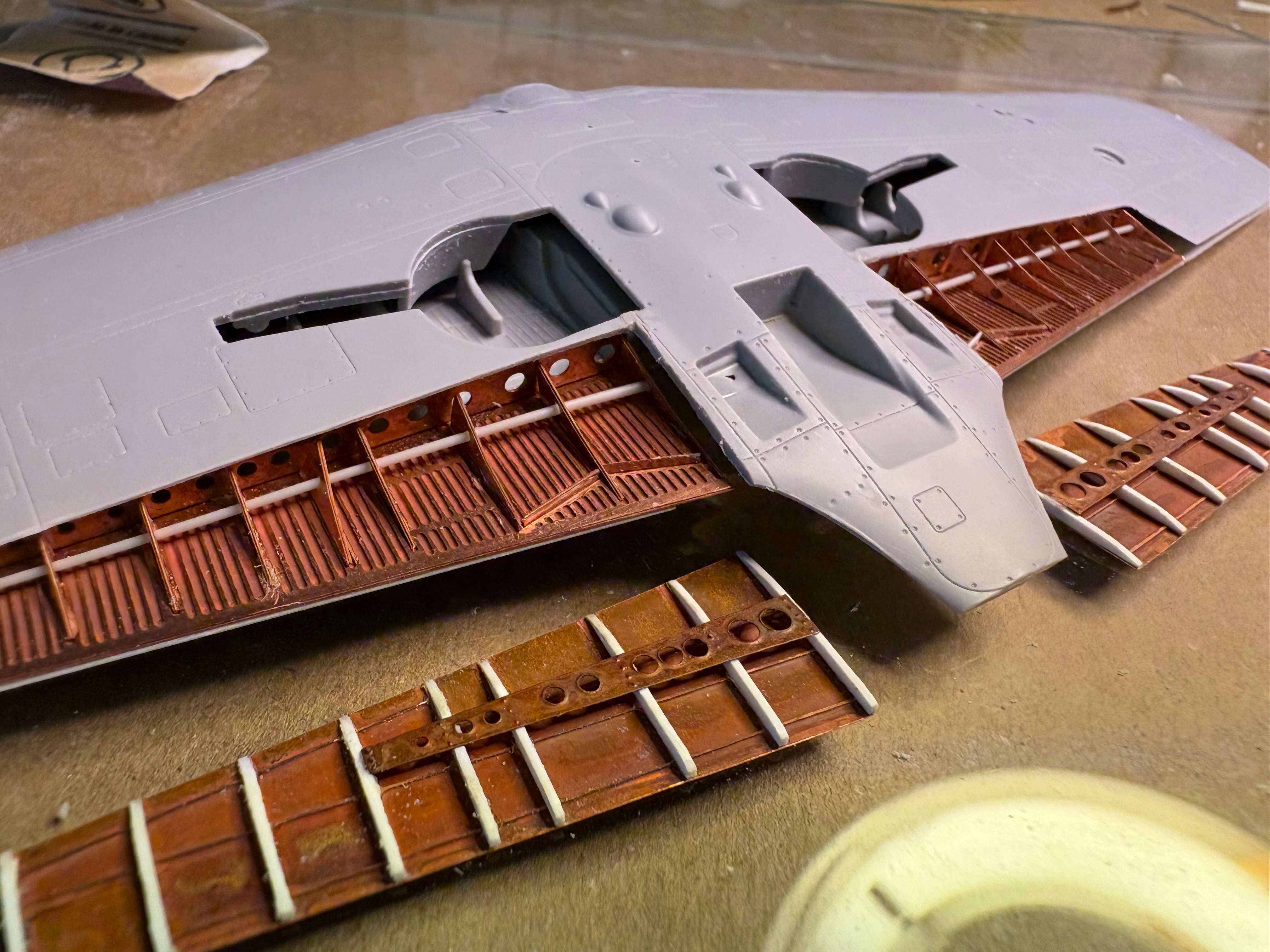

The flap detail is the long discontinued Verlinden P-39 detail photo etch from decades ago that I've been holding onto for years.

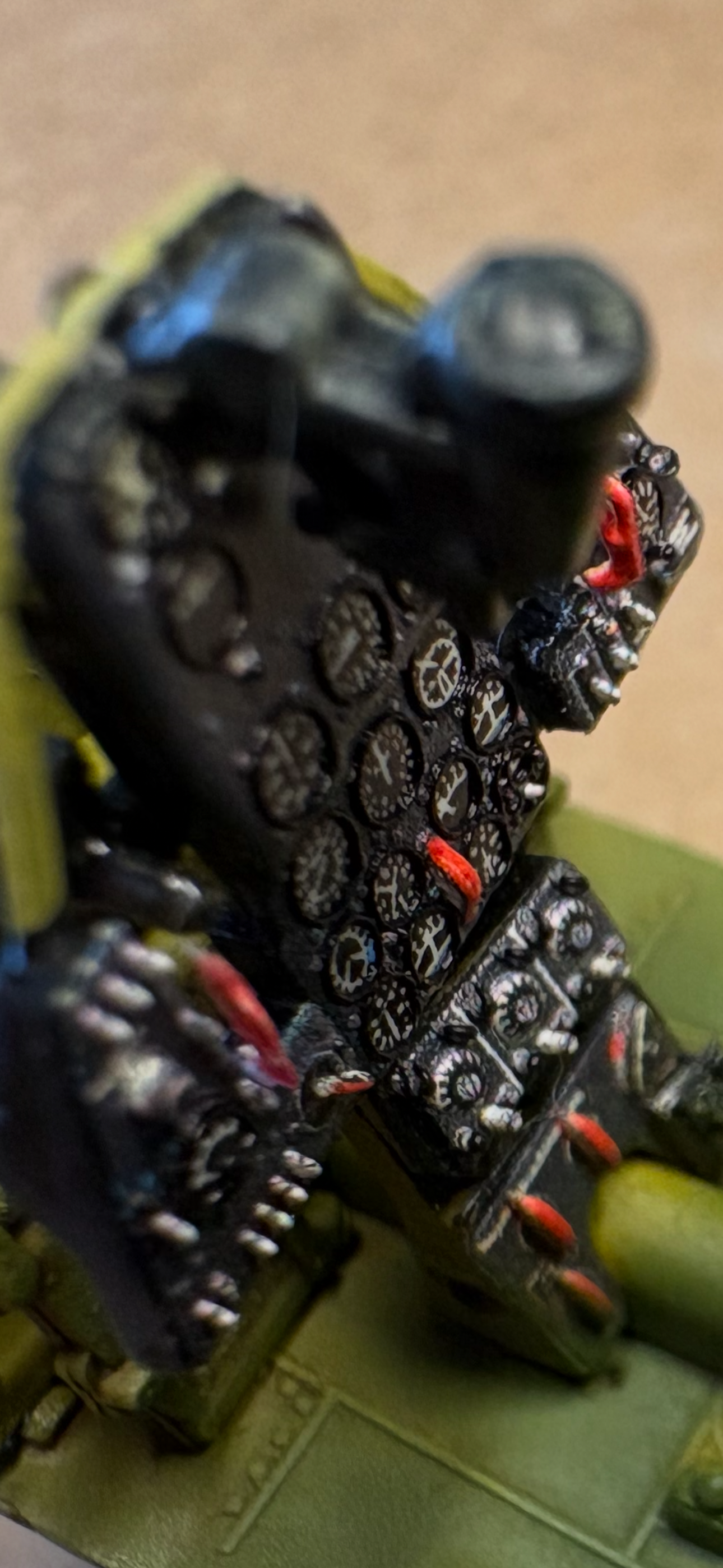

The cockpit details are Quinta Studio waterslide 3D decals. I absolutely love the look. Their stuff is top notch and easy to work with.
I'm sure I left some details out, so just ask if you have questions.
Thanks for looking. 🙂
P.S. the "cradle for the engine was scratch built with Evergreen and Plastruct styrene. Glycol expansion tank was a Verlnden resin part.

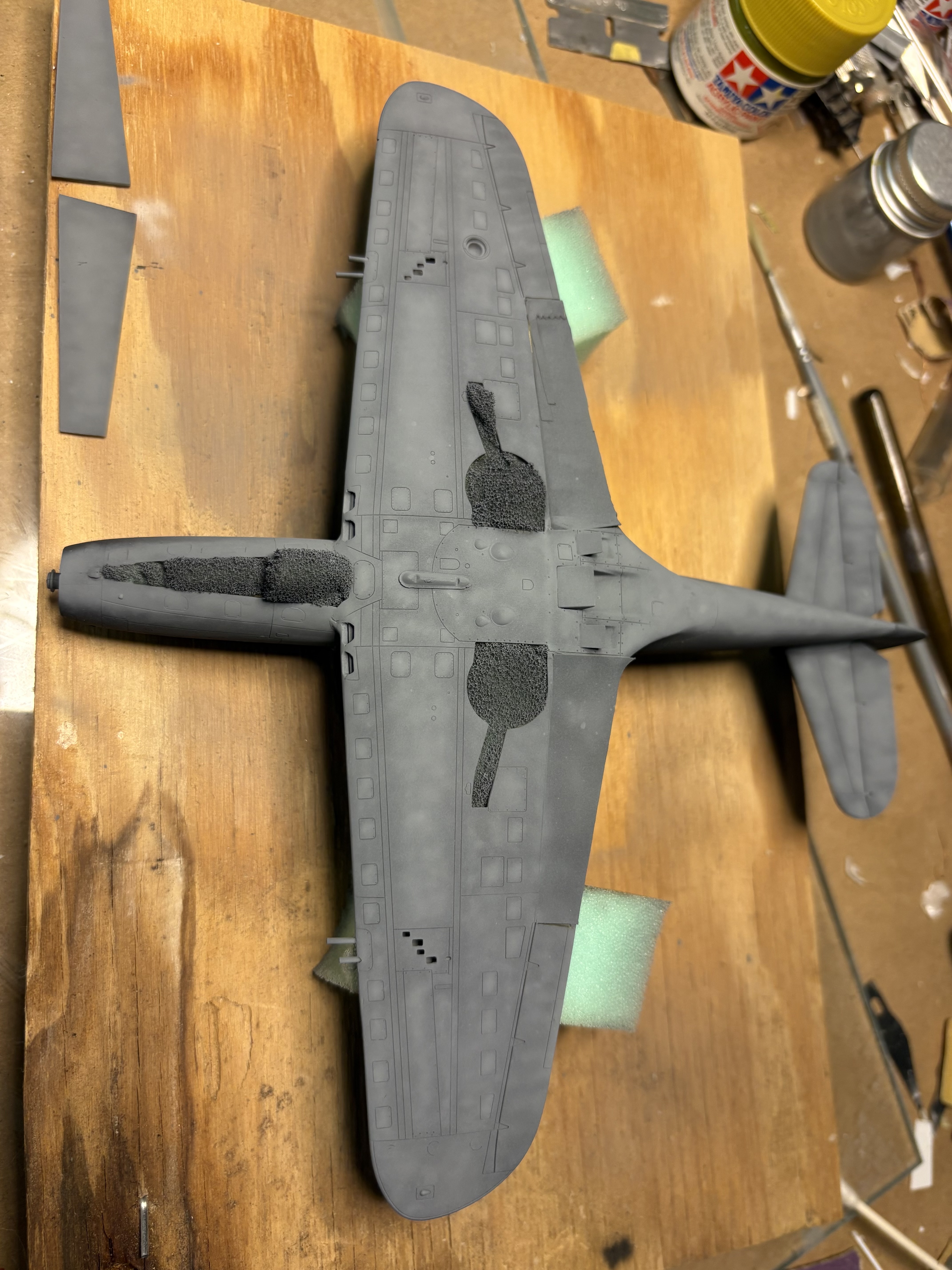

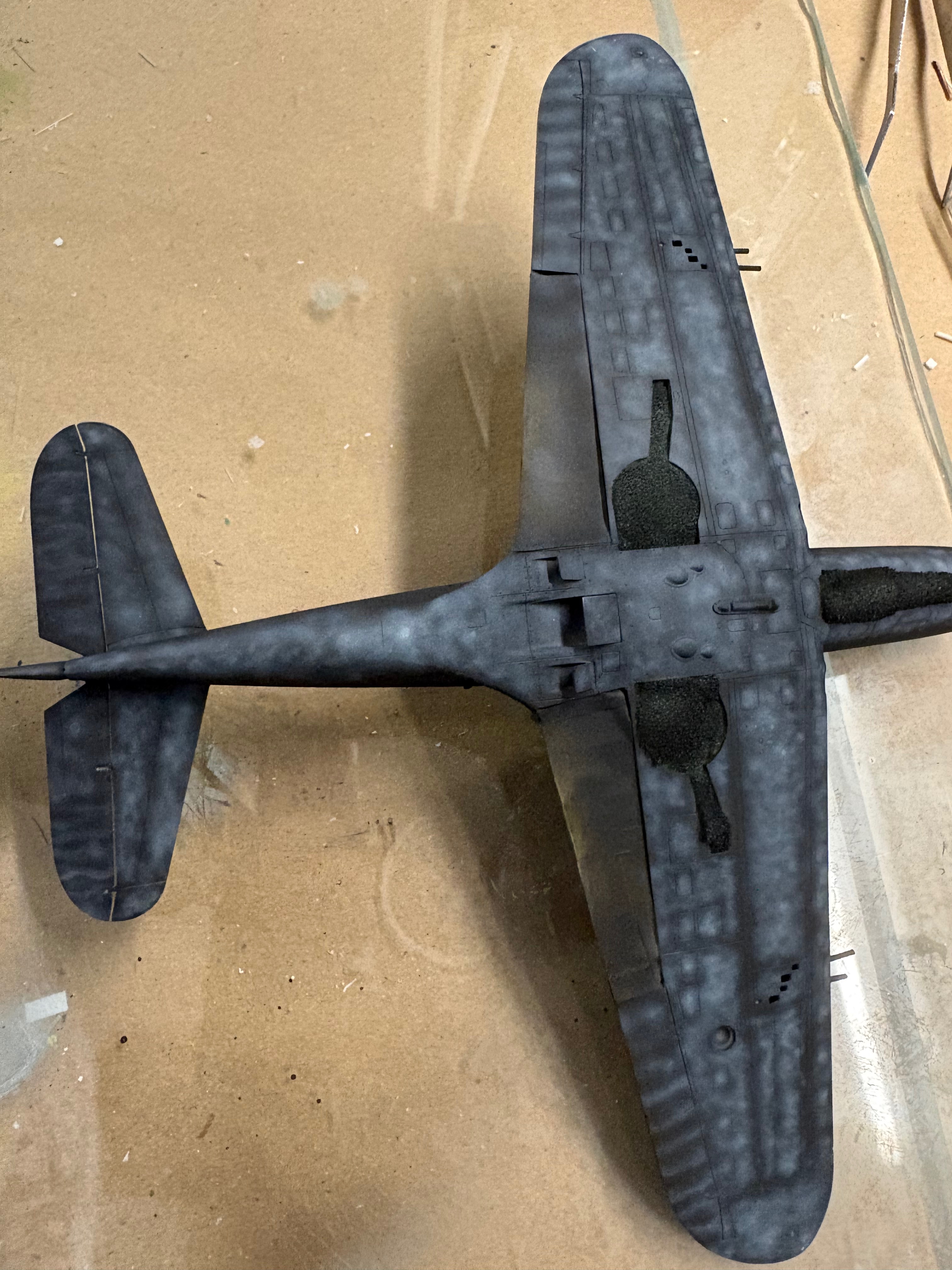

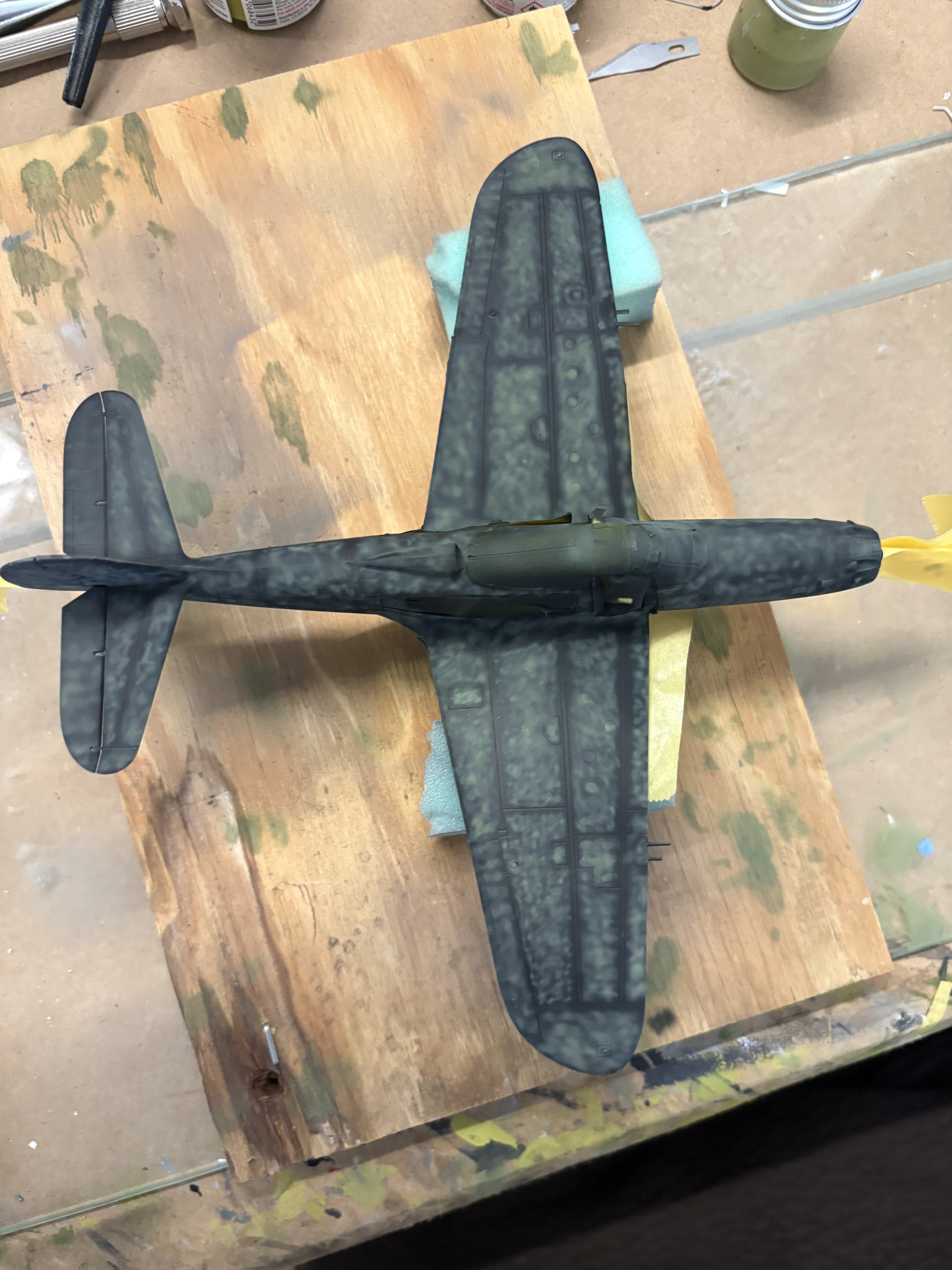

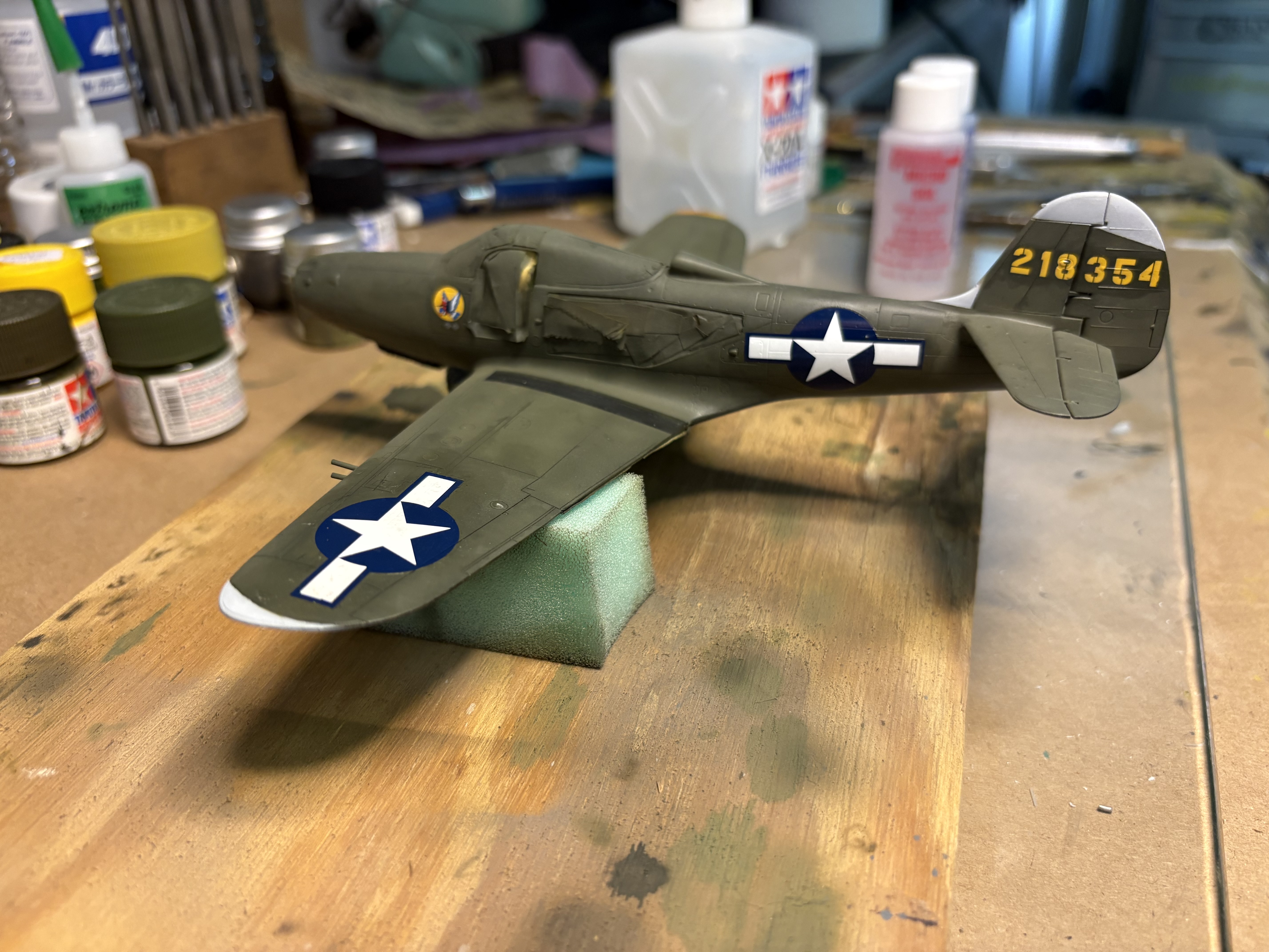

Nice base coat. I haven't tried the mottled base coat like that but I do like the results it gives.
First time I've done it. I watched a few videos and played with my airbrush until I felt comfortable to try it on the model. Watery paint consistency and low pressure seem to be the key. Patience helps. 😁
Nice work, particularly on your fust return.
I do like the black-base pre-shade technique, but one thing to remember is to use a lighter colored topcoat than you intend since you have to paint thin coats to let the pre-shade through. More than once my end result was too dark because I failed to remember that.
To be honest I am slowly converting to post-shading for that very reason. Same effect in the end, but more control.
Amen to that!
