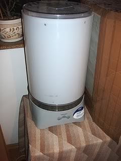

So I did some searching for something equally good I have found that some modelers use driers for fruits and vegetables. In the market there are many types of those dries some of them have temperature control some of them don’t. Unfortunately I couldn’t find the one with the control that would be available in Poland. But after consulting a forum friend I decided to by Zelmer 36Z011. This model has two settings normal one and the strong one. Normal mode gives you temperature of 30 degrees Celsius and the strong one gives 45 degrees Celsius. For safety I decided to test it on many modeling material like different types of plastic, white metal, resin and Styrofoam. I left it inside for 4 hours on strong setting. After that amount of time I found no misshaped element or damaged in any way.
[ATTACH=full]13108[/ATTACH]
So after this test I was sure that this is a safe way to Speer up drying process. People how want to put inside bigger or taller elements can either cut out the net from one of the trays or like me make a tall ring out of polycarbonate or Plexiglas.
