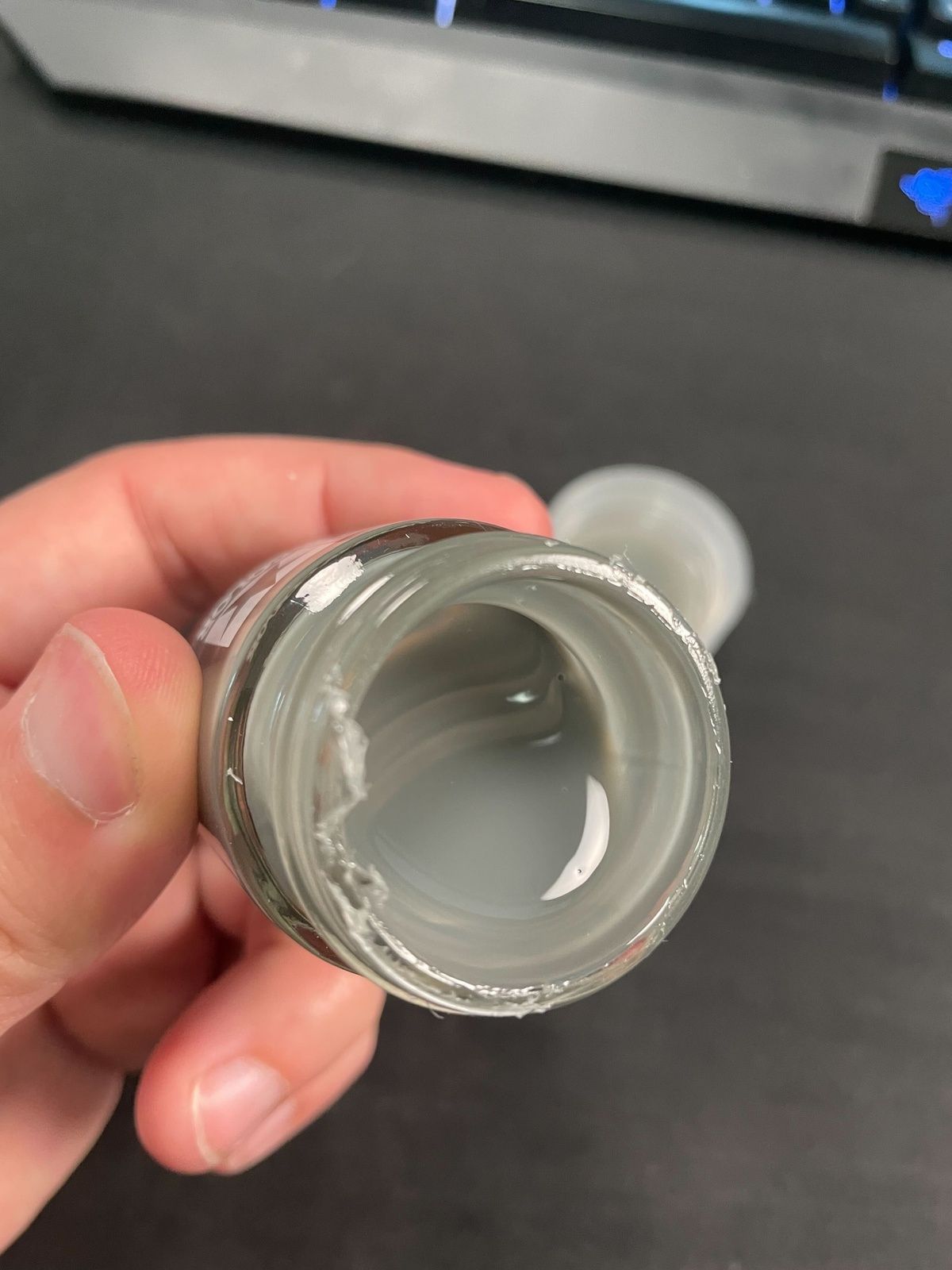

Another, similar technique is to take a bottle of liquid cement. Testors, Tamiya, etc, etc., and then take your left over sprue trees, cut them up and put them in the bottle with the glue. The glue melts the styrene, and you basically end up with liquid plastic that you can pack into seams, sand smooth, looks like plastic, because it is.

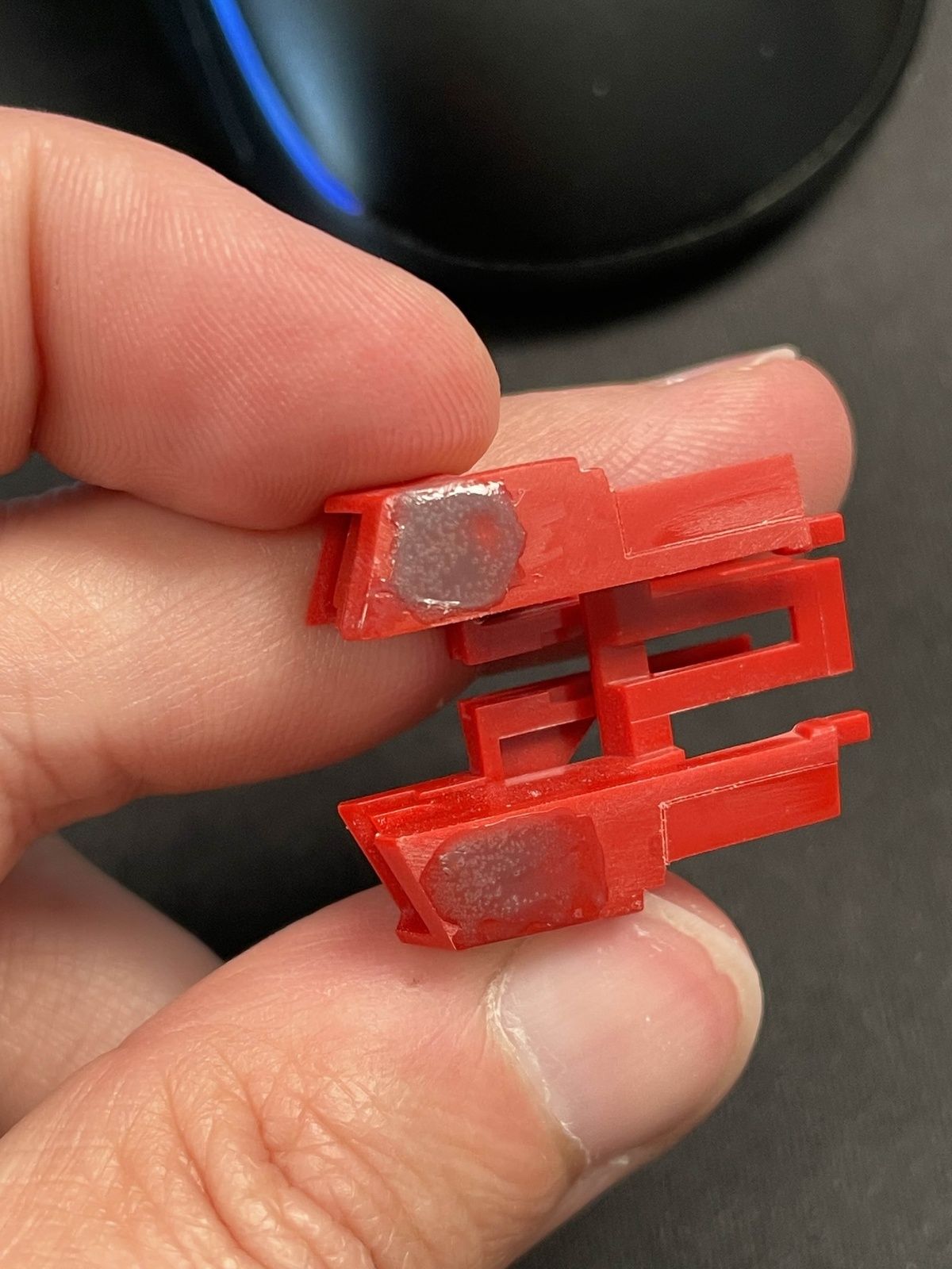

That's a good idea. I drop spure bits into and old bottle of Tamiya extra thin and made "Sprue-goo". I used it to fix a gap, or try to.it worked in a pinch. I ended up finishing out with so putty.

Once i saw a dude put his empty sprue into small pieces and put all those pieces into extra thin cement, after enough time mixture becomes to putty-like consistency and when it cures it becomes solid plastic
Sprue goo, brilliant stuff. Best to have a few different colours, grey, Buff and black. Pantherman
