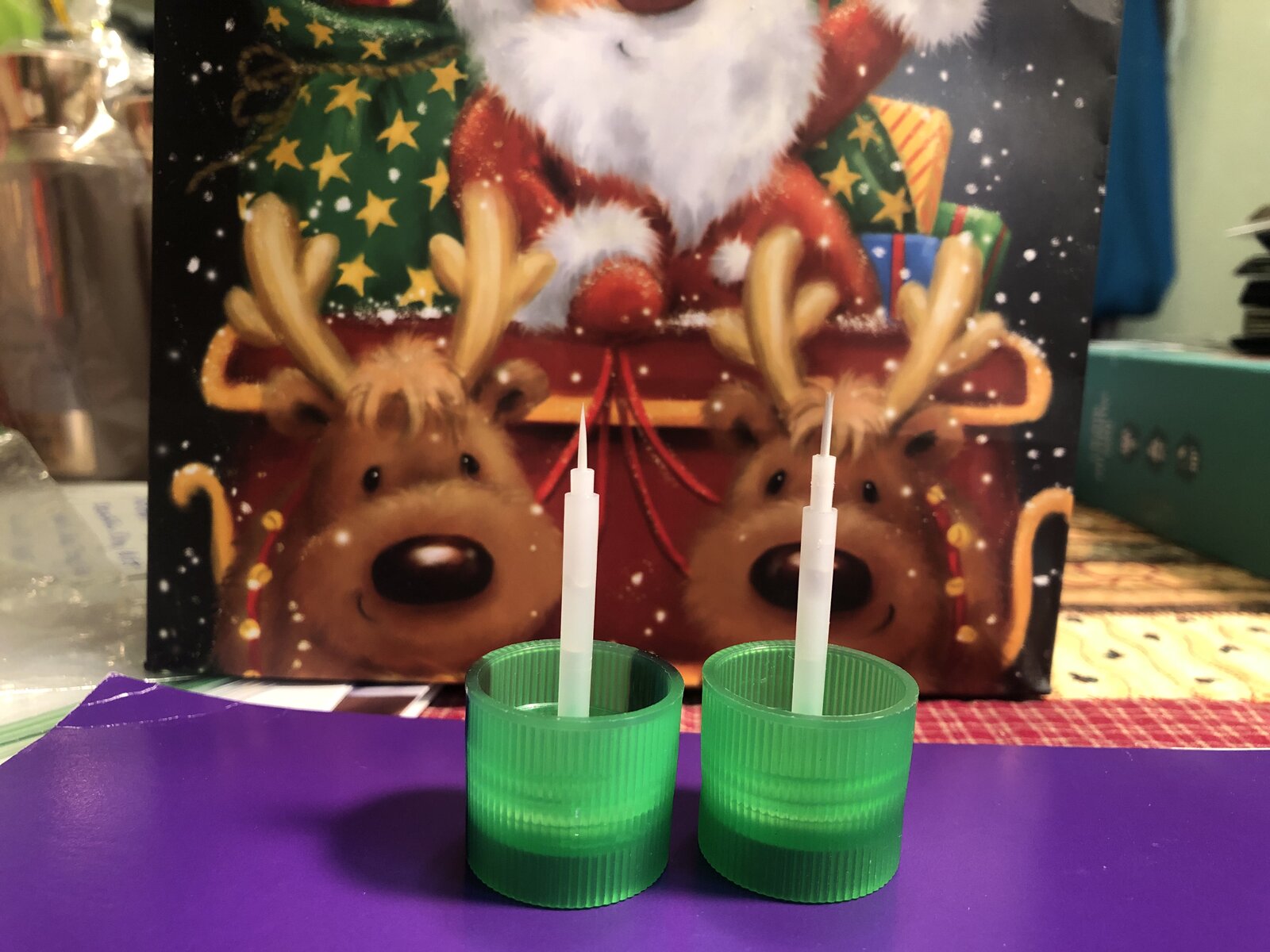

You can carefully pull the brush on the extra thin applicator out a bit and it will reach. Just don't do it with your bare skin. :)

One of the things I learned in the gas exploration field, is I always assumed to a certain point, that every one knew what I knew and at times it could be embarrassing. So I will assume you don't know about this and forgive me if this is common knowledge, or comes off more than condescending.
