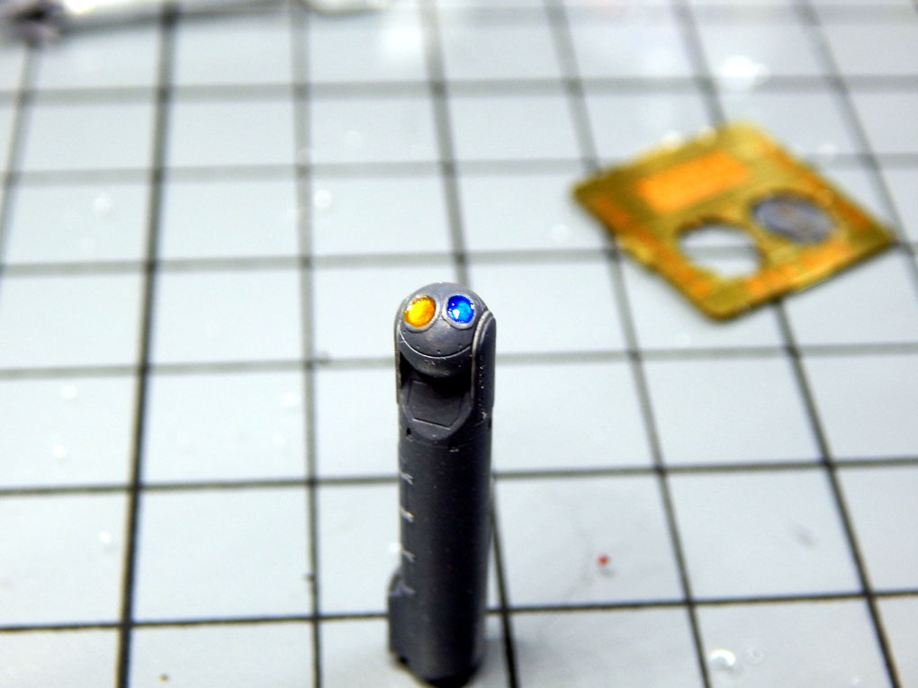

I trimmed the nose off the Mavericks to make the sensor heads using acrylic gel. I then filled the lenses on the Litening pod turret with acrylic gel and later will color them the correct shades. I am now working on finishing up the aircraft. The canopy, HUD, windscreen, and a couple of other touch ups and then I can install the weapons. Once the aircraft is finished I will be starting on the display case over the next week and hope to have this build completed by end of week.

After four weeks the A-10A of the 75th​ Fighter Squadron is finished. The start of the week I completed the Litening pod and installed the boarding ladder, HUD, canopy, and windscreen. I did the final paint touch-ups as well. One of the biggest touch-ups was the top of the tails. The decals were a little undersized so I used some Vallejo dark blue which matched the decal color perfectly. As a final step all the under wing stores were installed.

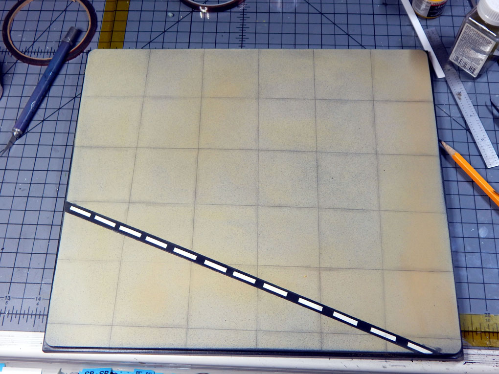

Next I painted the display base to represent the tarmac of a middle-east air base. This was weathered with some grime and a few shades of sand, yellow, and tan. The reference photos also had a black with white dashes as a foul line of the taxiways. With the base finished I scratch built some wheel chocks and attached the aircraft to the base. A small stand was made to hold the brushed nickel nameplate and it was then attached to the base.
This was a fun project and the kit was a good kit for a 1/72 scale aircraft. The fit was very good and the decals were great. This will be delivered to the client next week. Thanks for following along, Happy Modeling!
