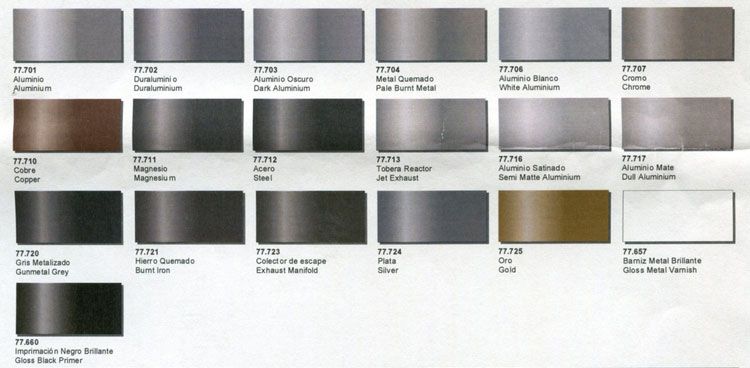

Anyway, here are the colors coming in the line:
All metallic colors available in a 32ml bottle (same bottle type that their Wash Line comes in), Gloss Varnish will be available in 32ml and 60ml, as well the Gloss Black Primer will be available in 32ml, 60ml, and 200ml. Not 100% sure if the larger sizes are coming out at the same time as the main line, or just later one.

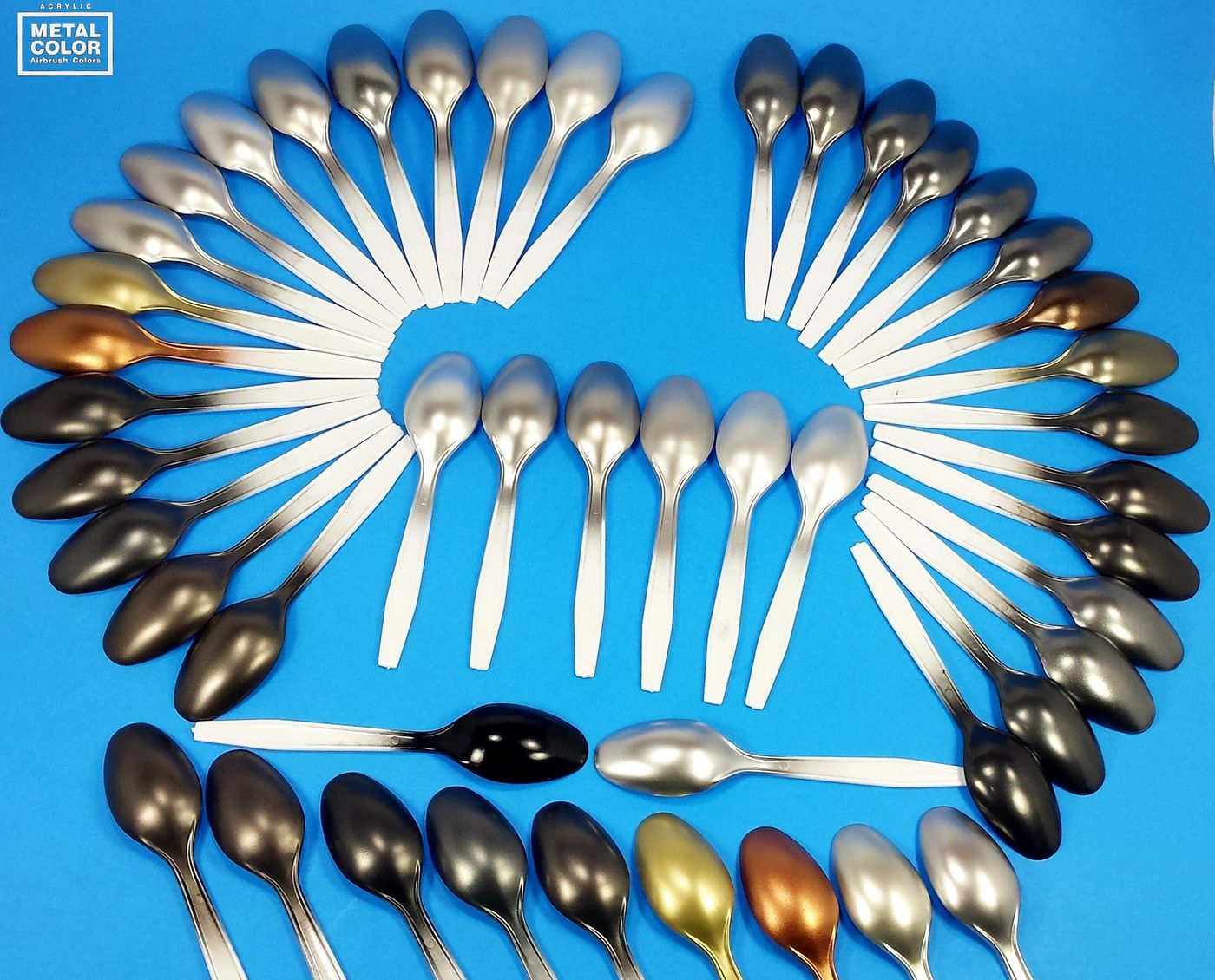

I have tested these out on plastic spoons here at the shop, and the 4 sample colors I got all worked very nice. I did not take photos of the painted spoons as I don't think that photos really do these paints justice. The paints do have to be stirred/shaken quite well to get the metallic flakes off of the bottom of the bottle. Cleans up with Vallejo AB Cleaner quite nicely, and is going to be an excellent addition to the Vallejo line, and an excellent alternative to Alclad Lacquers, and AK Enamels, for those that don't want to use the harsher chemical paints.

EDIT:
Just to add to this, found this picture of one of the Vallejo reps trying out all the colors on plastic spoons. Names aren't with the colors, but you can pretty much figure it out from the color chart above.
