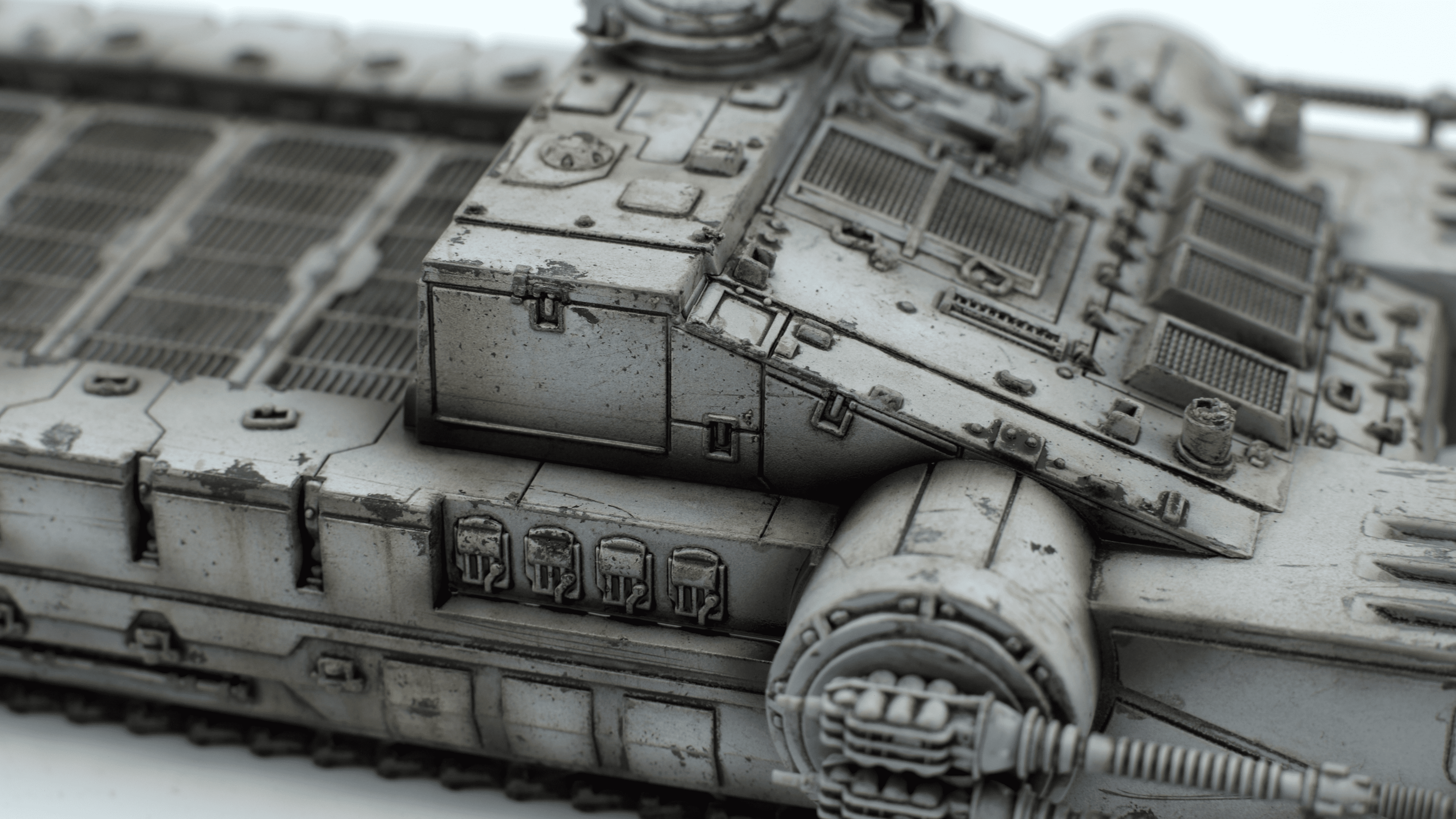

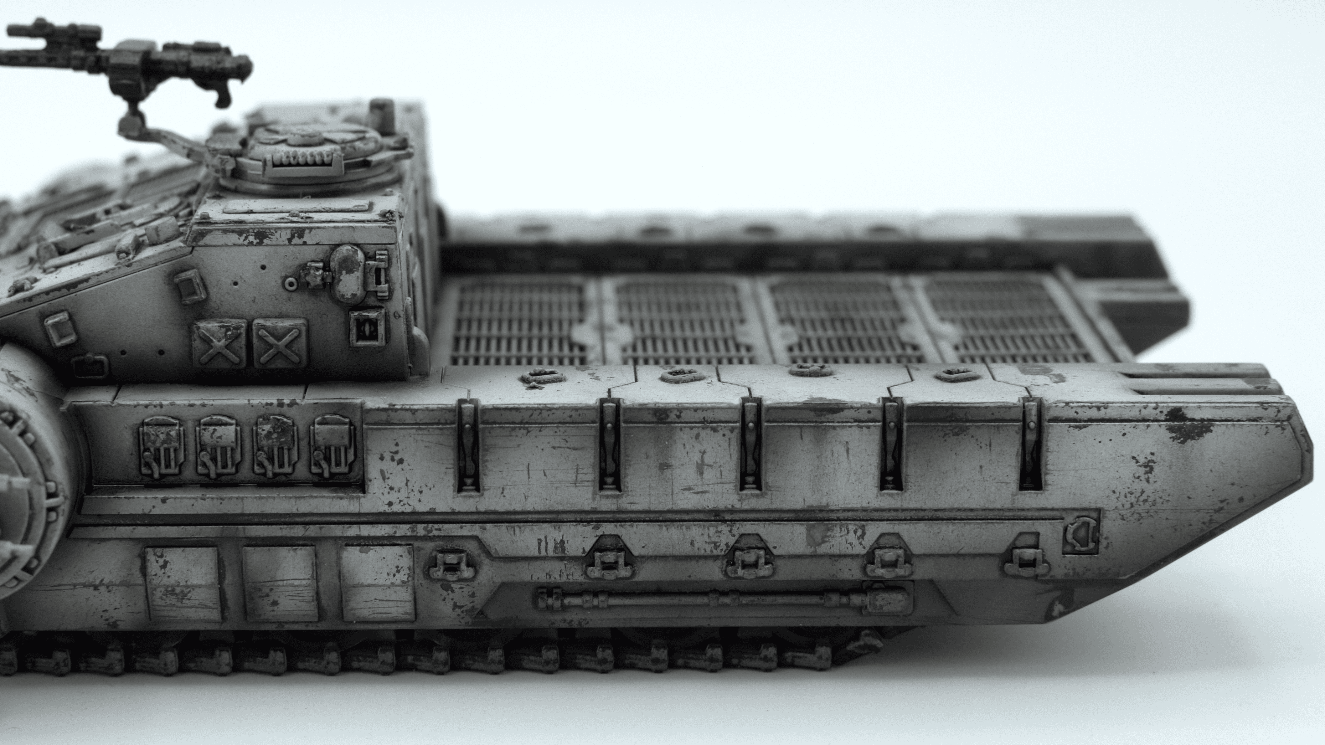

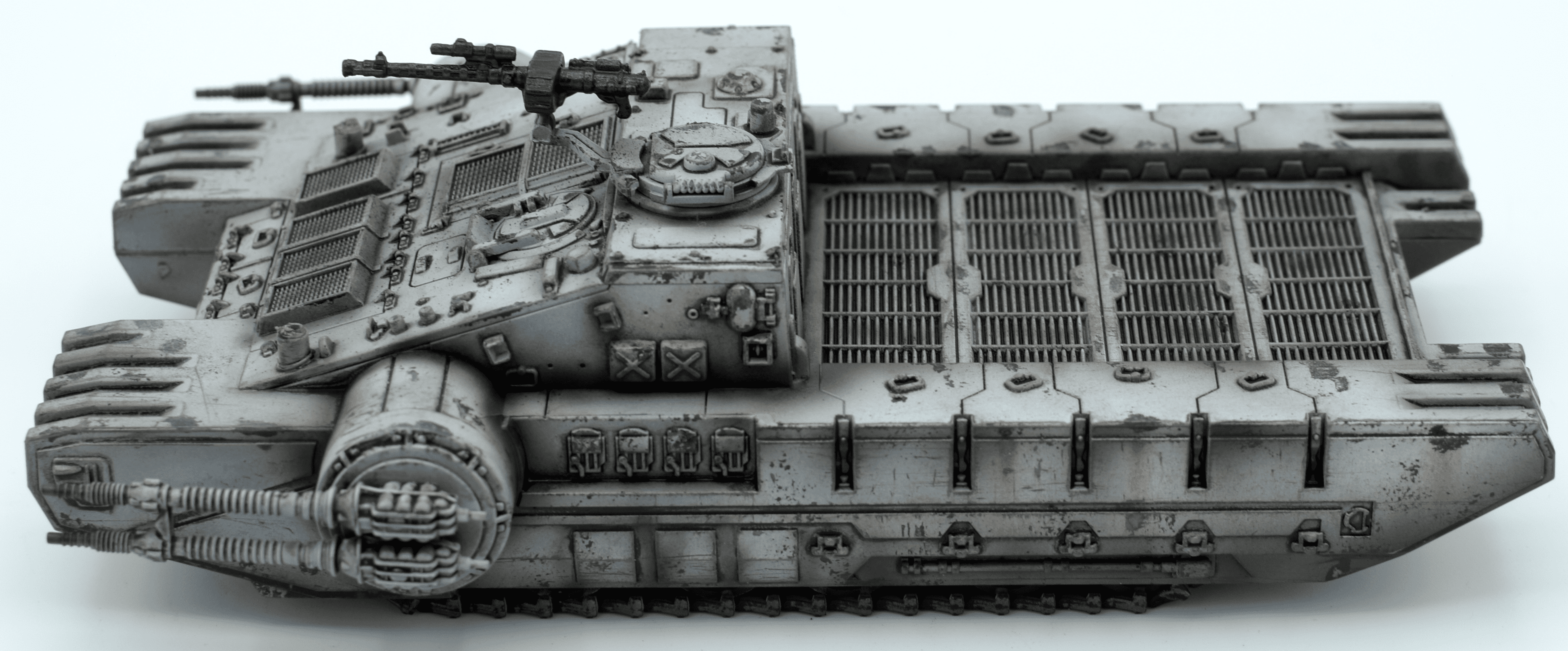

You building this thing ? :
... or this  ?

The origianal Renwal model. Not the re-release by Revell.  I bought it when I was still in HighSchool and shoved it in storage with the plan to "get to it one of these days".  Typical Renwal kit, lacking on some details, mold marks, etc, but loads of fun, great challenge, lots of sanding and putty but coming together nicely. Photos to follow soon in the Armor section.
