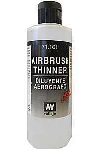

« Reply #9 on: Wed Feb, 03, 2016, 01:32:AM »
Honestly, instead of monkeying around with a bunch of other thinner types, go buy a bottle of the stuff that is designed to work with the paint. Vallejo Airbrush Thinner.
The saying of "Right Tool, Right Job" comes to mind here.
Start at a 50/50 mix, and work from there, as Urumom said, not every bottle of Model Color is the same consistency as some bottles take more or less pigment, to create the colors. Mix it in something else, not in your airbrush, as if you start out with too thick of a ratio, it is just going to bugger up the needle and no matter what you do, will make it hard to spray.
Preferably mix it in something clear, so you can see the paint run off the side of the container, and as I said, start at 50/50, and adjust until it looks about the opaqueness of skim milk.
The Vallejo AB thinner will thin the paint and adds a small amount of retarder to it as well so as not to dry before it reaches your model.
18psi is fine if you are doing just general work, if you are free handing camo and such, you will need to thin it slightly more, and drop your airpressure down some, so you can get closer to the model to spray.
While the Model Color is more designed for brush painting, it can be thinned, but have a look at the Model Air, pre-thinned in the bottle for airbrush, mix it up and pour in, no muss, no fuss. I do add a couple of drops (no more than 10% of your total mixture) of the AB thinner, as it breaks the surface tension of the paint, and makes it flow better than straight from the bottle, however...you don't have to do this. I have just found over the years of using both lines, that it help the paint to flow from the airbrush, and gives a better finish on the model.
Do not use ISP or Windex or similar with the Model Color paints, they are not alcohol based, and will actually gel the paint in your airbrush, and isn't fun to clean out. In the Model Air it is ok, as it lacks the vinyl additive that the Model Color has, that reacts with the alcohol.
Been using Vallejo for going on about 10-11yrs and have been selling it for the last 9yrs, and have never had an issue using them, but the 2 biggest complaints I see is:
1. the paint doesn't stick to the plastic. And it won't, as it is an acrylic, and acrylics don't have the chemicals to bite into the plastic to make them stick, so you need to put them over a primer coat of some sort.
2. the paint won't thin (in the case of the Model Color or Game Color), and the #1 reason why it won't thin, is because people are usually using everything but the product they should be, Vallejo Airbrush Thinner.

« Reply #10 on: Thu Feb, 04, 2016, 02:54:AM »
Thanks for all the help guys, it is much appreciated.
I do have a bottle of the testors thinner that I use for MM paints, tried it out tonight it seemed to thin the paint better than my water mix and wasn't as dry, but it still clogged my tip but not as bad as the water/glycerin so it is better.properly mixing the paint made a big difference too :)
I did find a local shop (Table top minis) that stocks pretty much every product that Vallejo makes so I am going to pick up a bottle of the Vallejo thinner as well as a couple model air to try them out.
as far as the paint lifting without primer I haven't experienced that yet. I usually prime bigger models but rarely do I prime 1/72nd aircraft so I don't lose the limited detail that they have, my test pieces without primer have stuck pretty good but I do want to try the Vallejo primer because it has a lot of different colors

What airpressure are you running? The Vallejo thinner has some retarder/flow improver in it, but they also make a flow improver for adding to the paint to keep it from drying.
For the Model Air paints, I add a touch of thinner (maybe 1 drop of thinner to 5 drops of paint), not so much to thin it, but the thinner breaks the surface tension of the paint, and helps it flow much better.

Which line of paint? Model Color and Game Color while can be thinned to be airbrushed, there is no hard and fast rule as to how much to thin them as each bottle of paint has a different consistency due to the amount of pigments needed to be used to create the color.
Model Air, or Game Air, they are all pretty much the same from bottle to bottle as they are designed from the outset to be airbrushed.
If you have to use a color from the Model Color or Game Color range, I suggest a starting thinning ratio of 5 parts thinner to 1 part paint, and go from there.
As far as distilled water goes, ditch it. Cheap yes, but will give you nothing but problems. Use the thinner designed for the paint (which there is a picture above) and your airbrushing sessions will be more enjoyable.
